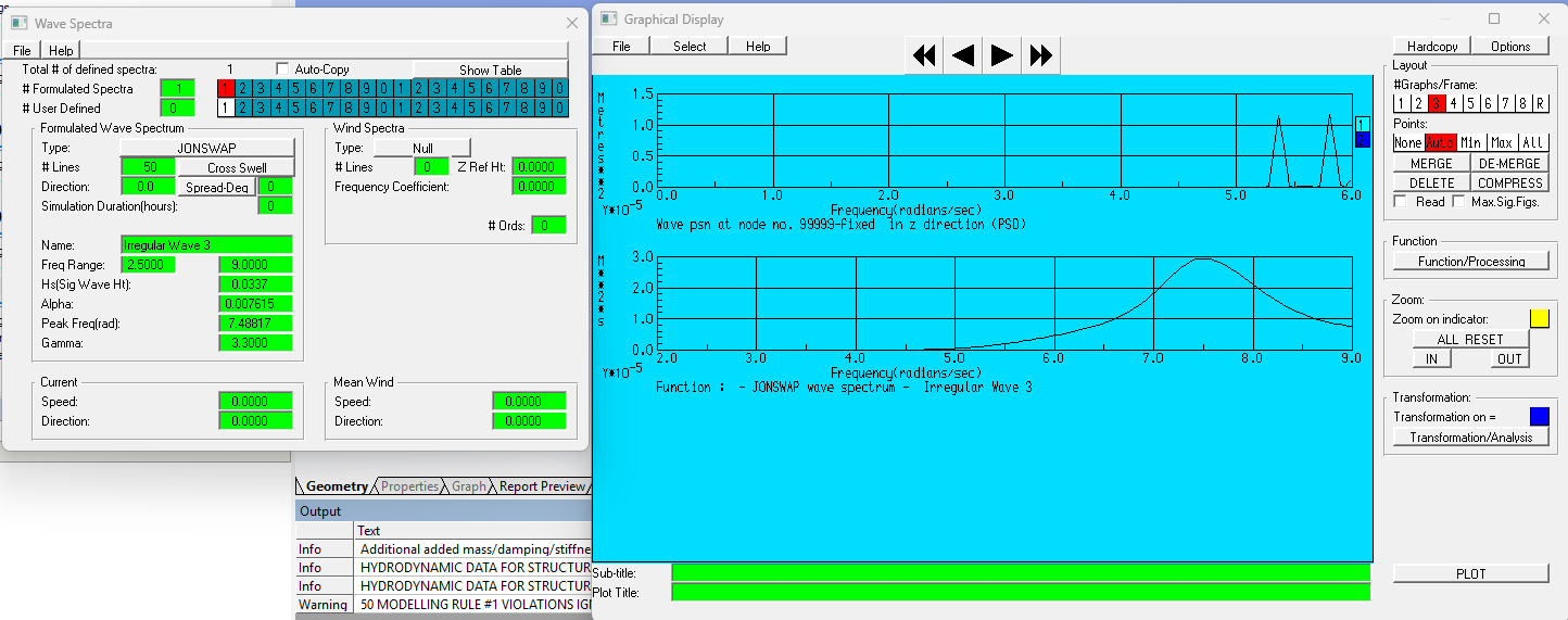

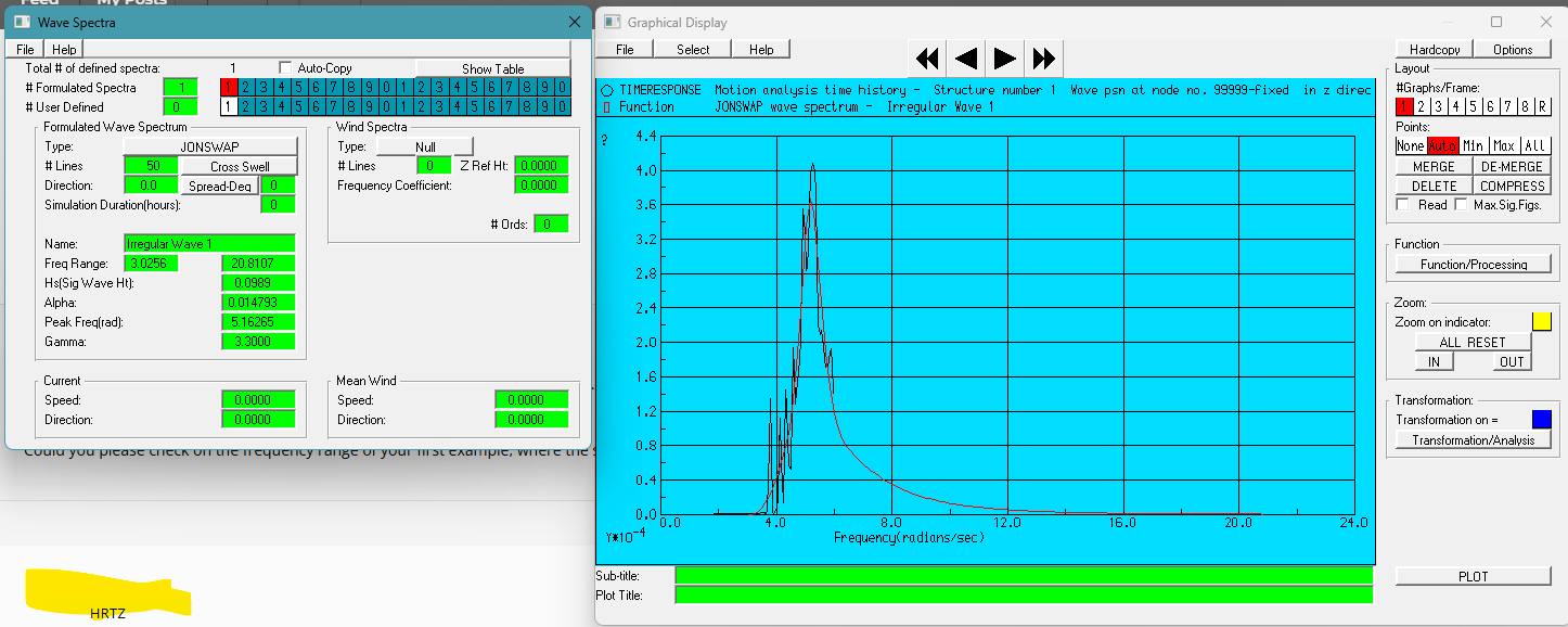

I’m working with ANSYS AQWA for time-domain response analysis. I have defined a JONSWAP spectrum to generate irregular waves and have obtained the wave elevation time series as output.
I would like to check how well the simulated wave elevation matches the theoretical JONSWAP spectrum (for the same parameters).
Does AQWA provide any built-in way to view or export the frequency-domain spectrum (Power Spectral Density) of the output elevation time series? If not, what is the recommended practice for verifying the agreement between the input spectrum and the generated wave time series?
Any suggestions or workflows for this verification would be much appreciated.
Thank you!

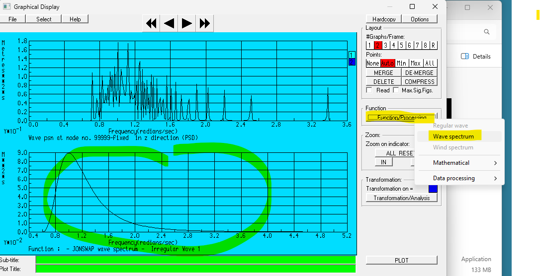

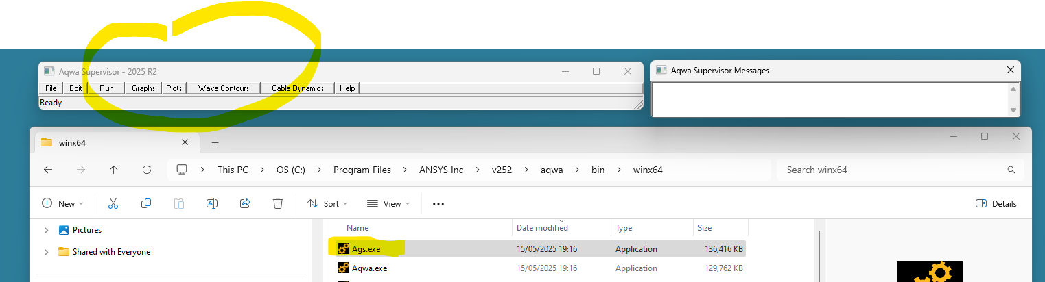

Ansys EmployeeYes, you can use Ags to do it.

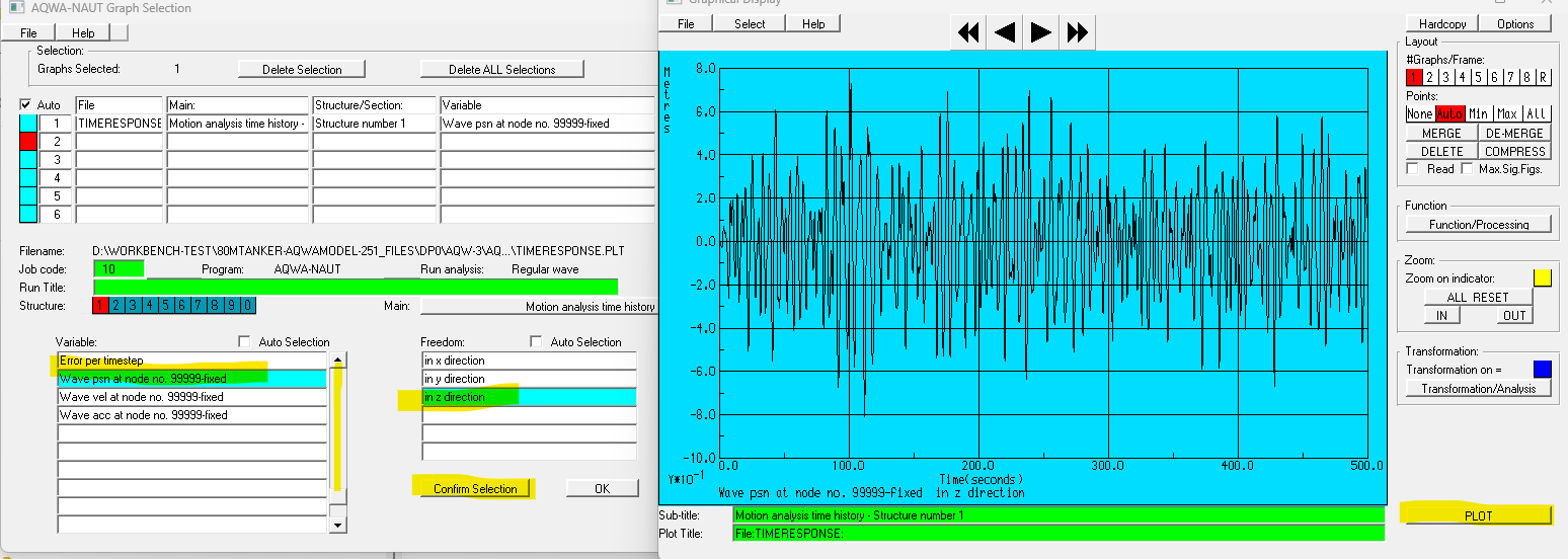

(1) Run Hydrodynamic time domain analysis with JONSWAP wave spectrum and make sure the time step is small, for example 0.1 second, and the duration is long enough, such as 500 seconds.
(2) The results are stored in (Your project)\dp0\AQW-?\AQW\AQ\Analysis\TIMERESPONSE.RES and TIMERESPONSE.PLT.

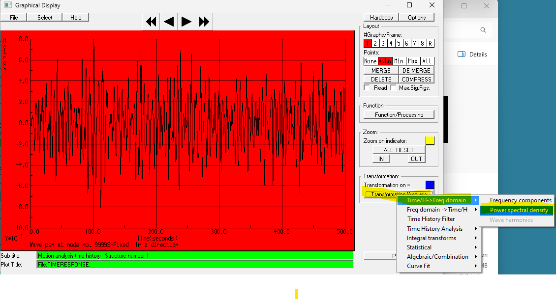

(3) Double click on (your Ansys installation folder)\\aqwa\bin\winx64\Ags.exe, Aqwa Supervisor Window will appear
(4) Click on File -> Open to import TIMERESPONSE.RES in your project folder, then click on Graphs to import TIMERESPONSE.RES in your project folder. Select Wave psn in z direction, confirm selection, then PLOT, the time domain wave elevation will be plotted.
(5) Click on the graph, -> Transformation/Anslysis -> Time/H -> Freq domain -> Power spectral density
(6) the swave spectrum density will display
The JONSWAP spectrum you defined can also be dsplayed by clicking on Function/processing

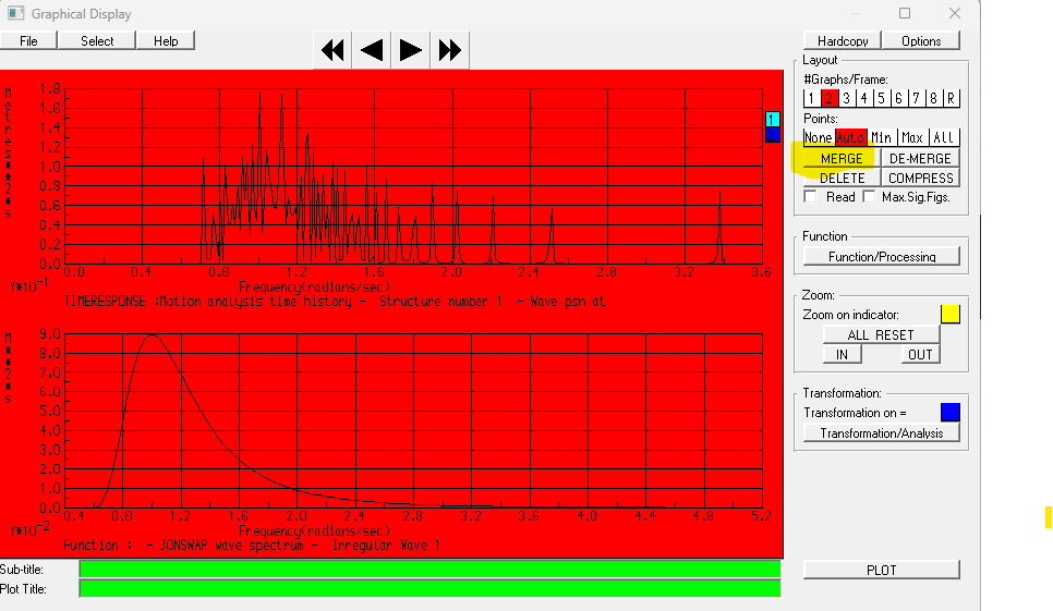

(7) by holding Ctrl key and pushing Mouse left button on these two graphs, then click MERGE
finally you will have the comparison of these two data

NVN NAMMA

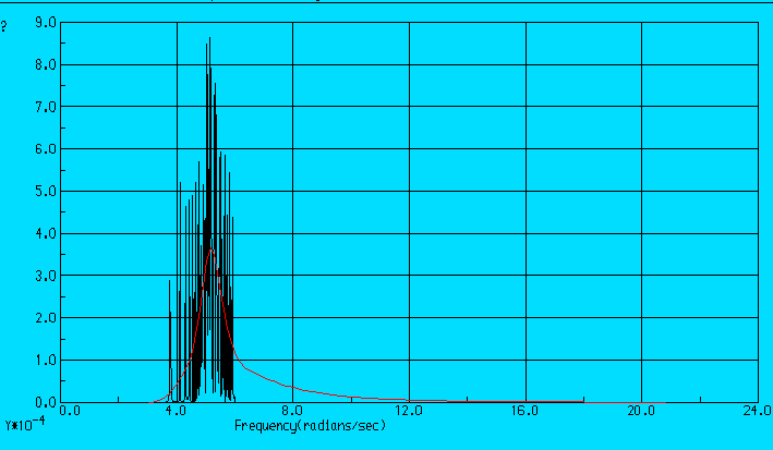

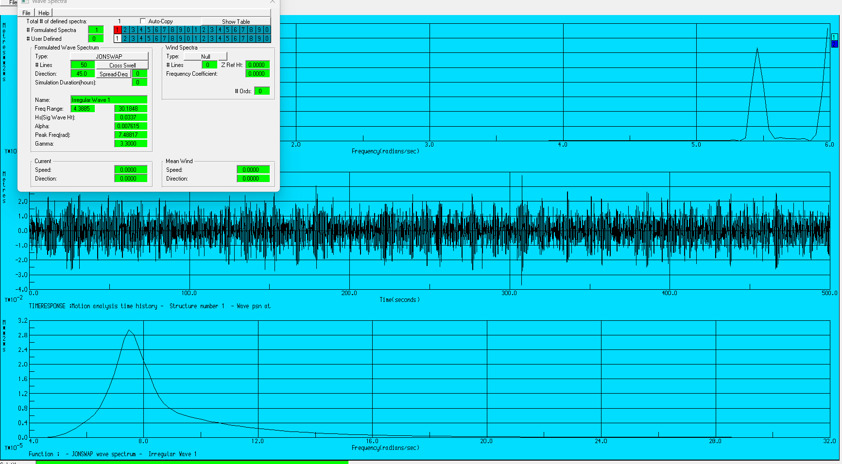

SubscriberTo cover the majority of the frequencies in the JONSWAP spectrum, I adjusted the start and end frequencies in the simulation and used a duration of 500 s with a time step of 0.01 s. However, the results do not match the target spectrum. What could be the reason?
The theoretical spectrum matches the given range, but the spectrum developed from the wave elevation does not match.

Ansys EmployeeCan you please show the data from Data Category 13 to Data Category 18 in (Your project)\dp0\AQW-?\AQW\AQ\Analysis\TIMERESPONSE.DAT? Data Category 13 defines the wave spectrum.

July 16, 2025 at 9:56 am
Shuangxing Du

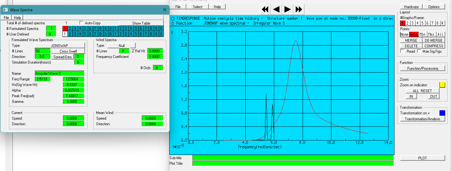

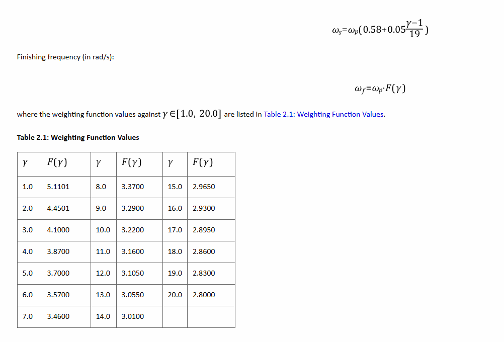

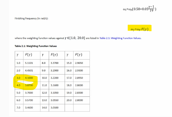

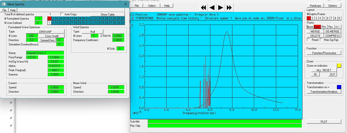

Ansys EmployeeNormally within starting/finishing frequnecies, the wave energy should be at lease of 99% of the total wave spectrum energy. From the plot of the spectrum, it seems not the case. Can you make the finishing frequency to be higher. Can you also set the numebr of wavelets to be 200 instead of default value of 50?
July 16, 2025 at 10:03 am
July 16, 2025 at 10:10 am
July 16, 2025 at 11:29 am
July 16, 2025 at 11:39 am
Shuangxing Du
Ansys EmployeeWith a wave spectrum, the irregular waves are represented by number of wavelets between the starting and finishing frequency range. In a time domain analysis, the actual wavelets' frequencies are defined by the program to ensure the same wave energy (or same wave amplitude) of each wavelet. By using more wavelets instead of 50, the waves are represented more accurately, but slightly time consuming in the numerical analysis.
Note that you may have defined a wave spectrum for the seakeeping basin, as the signficant wave height is about 0.03m, and the frequency is in the order of 1 Hz. I wonder if you convert your model into the prototype size and define the equivalent sea wave condition, could this comparison work be better?

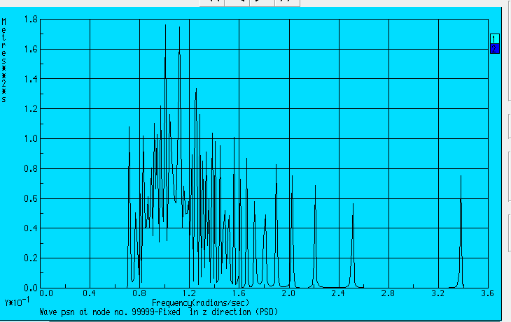

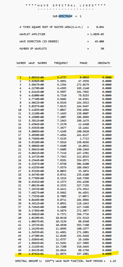

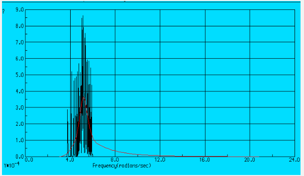

SubscriberDoing simulations on the prototype scale will not work for me. Now i am unable to understand why those frequencies are missing in the time series. and i am struggling to reproduce the old one, which had a better match
Here too, those frequencies are missing. In the hydrodynamic diffraction analysis, I defined a manual frequency range with a maximum of 2 Hz. Could this be related to the wave elevation in the hydrodynamic time response simulations?

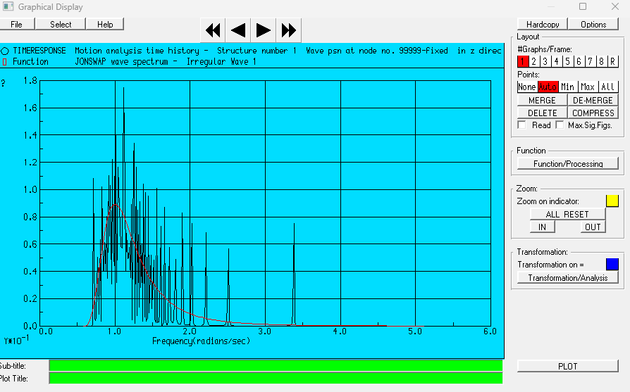

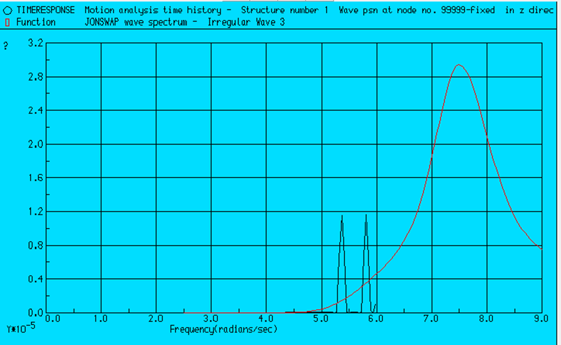

SubscriberNo, sir. The results are in rad/s so the maximum frequency would be 29.90 rad/s. (2*4.76*pi). The theoretical spectra are shown up to the given finishing frequency. In all the time series spectra, the maximum frequency is 6 rad/s. ie 0.954 Hz. Is there any modification required in the diffraction analysis?.
Could you please check on the frequency range of your first example, where the spectrum spans the entire theoretical spectrum?
July 16, 2025 at 4:08 pm
July 17, 2025 at 5:24 am
July 17, 2025 at 5:50 am
July 17, 2025 at 8:08 am
Shuangxing Du
Ansys EmployeeYes, it could be the limit of 6 rad/s. For the real sea state, it is reasonable. Thank you for reporting it, I will check the code and may have a change.

Shuangxing Du

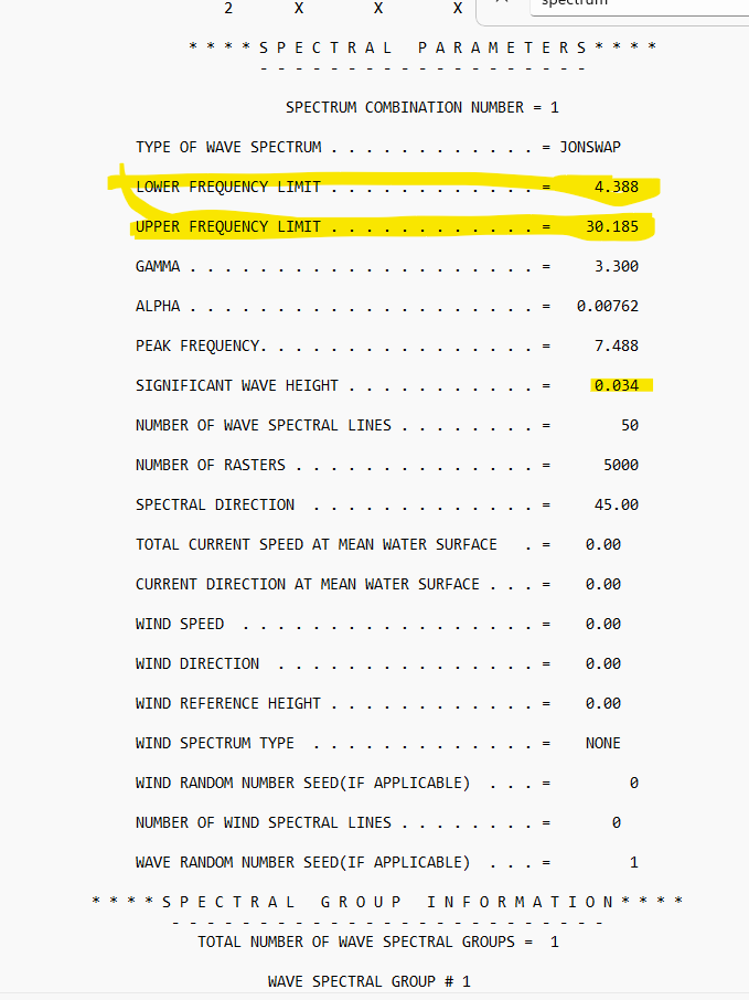

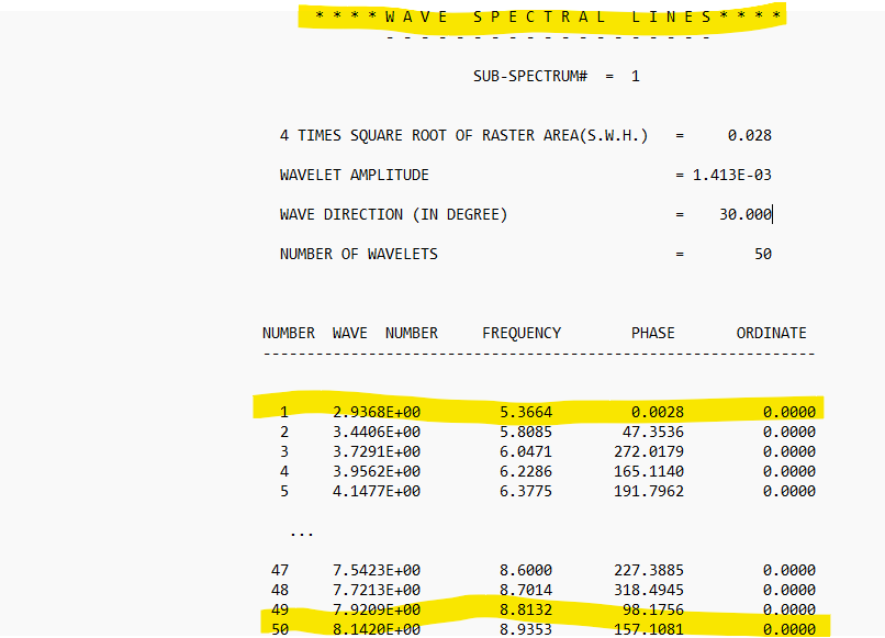

Ansys EmployeeIt is confirmed that the Aqwa time domain analysis uses the wavelets in the frequency range of (5.366, 8.935) rad/s. Please see RESPONSE.LIS in (Your project)\dp0\AQW-?\AQW\AQ\Analysis
The wave spectrum you defined looks like
As I mentioned previously, the finishing frequency may not be correct.
The 6 rad/s limit is just for post-processing, which does not affect your time domain response analysis, but your finishing frequency may do.
July 18, 2025 at 5:21 am
July 18, 2025 at 9:01 am
Shuangxing Du
Ansys EmployeeNothing wrong. As I mentioned previous, when the finishing frequency is higher than 6 rad/s, please do not use this FFT post-processing function. Just check the wavelet information in the response.lis file, as you did, which lists the wavelets acutally used in the Aqwa analysis.
