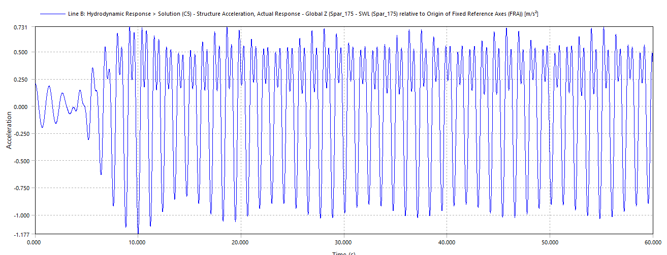

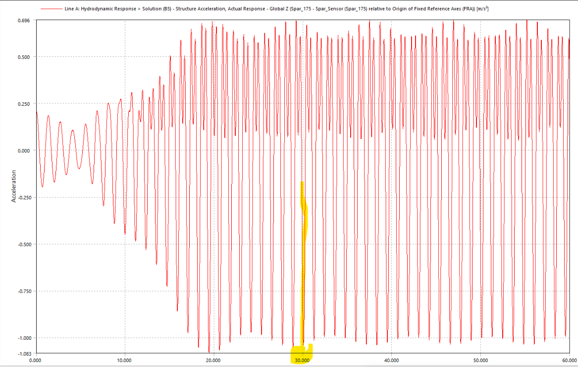

      Hi, This was the result in acceleration for a regular wave time response analysis of a model scale spar platform.

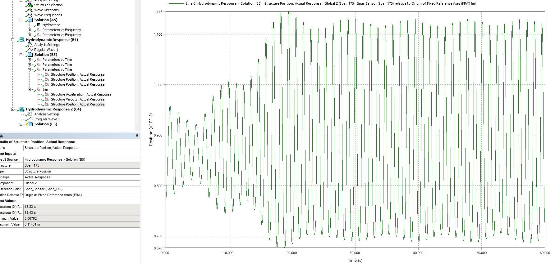

      But the position response shown is of a different nature. The acceleration response I validated with my experimental results. but the position actual response is entirely different. why is this?. Please help me to sort this out.
      Also one more doubt. Why is the heave acceleration is non-zero at time =0s?

      Not sure how you validated position results. The position at a specified time relates to the acceleration and the initial velocity and the initail position.  Can you have the heave acceleration/velocity/position results? The curve of the derivative of position time history should coincide with the velocity curve, and the derivative of velocity time history should be comparable to the acceleration.  Please do such check. and also make sure the initial velocity and the initail position in your numerical model is the same as those of your model test.
      Another point is when you run Aqwa time domain analysis, in order to avoid the transient responses at the starting period of time, the wave amplitude ramp is defined (see 18.7. The WRMP Data Record - Wave Ramp for regular wave). This definition of the wave may cause your responses not to be exactly the same as the experimental results, as the envornment conditions between your numerical model and the model tests are not exactly the same.

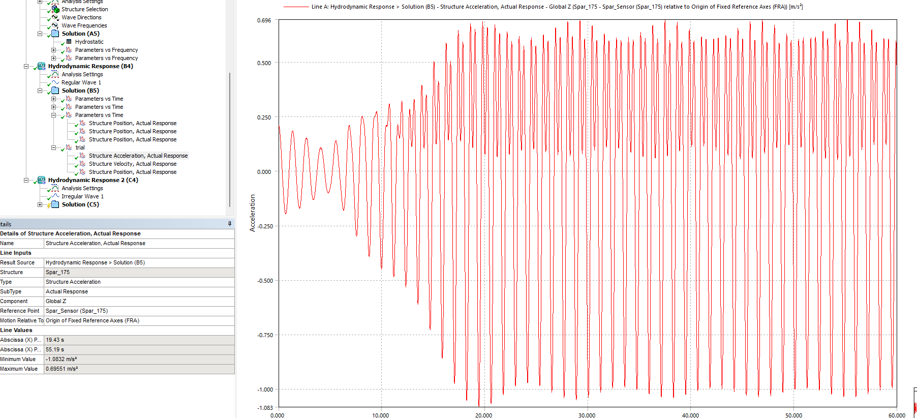

      I validated experimental acceleration and simulated acceleration results. But the response(heave position) is not matching with the pattern of acceleration. If you see the two plots, the trend itself is wrong. From my understanding aqwa calculates acceleration and then integrates to position in its numerical tool?
      "The analysis involves meshing the total surface of a structure to create a hydrodynamic and hydrostatic model. Nonlinear hydrostatic and Froude-Krylov wave forces can then be calculated from this model at each time step in a simulation, along with instantaneous values of all other forces. These forces are then applied to structures via a mathematical model (i.e. a set of nonlinear equations of motion), and the resulting accelerations are determined
      Also if u see the acceleration plot its non zero at t=0. I gave initial ramping of 10 s. if u need any more screenshot of my simulation, I am happy to provide.

      Please check which time domain hydrodynamic response analysis you did. If it is Irregular wave response with slow drift, the first and second wave exciting forces will be used and the initial acceleration based on the RAOs will be included.  Please also check if your time domain analysis starting from the eqlibrium position.
      It is hard to compare the tendencies betweem acceleration and position. I wonder if you could output velocity response. The integration of acceleration with time will be the velocity, then the integration of velocity will be the position.

      That is good. now we are back at our first question. Why the position time series showing different pattern than the acceleration time series?. I have used regular wave response in the analysis. for velocity also it is different.

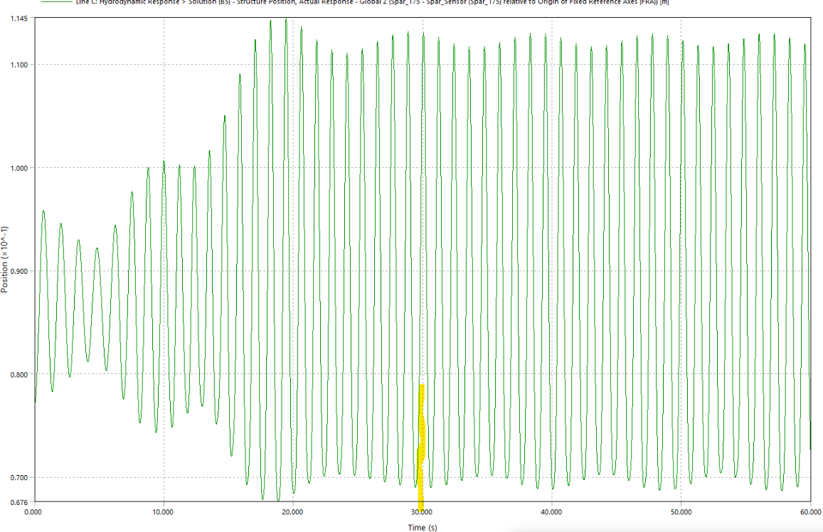

      It is confused. In your previous data, as shown below, there is a trough of acceleration and there is a crest of position at t=30s , but in your latest data, the position at that time is a trough, the starting position (time=0) is also not the same as that in the previous data.  I never said that the position is purely generated by the acceleration. It also depends on the inital velocity and initial position.
      Once again, please use position curve to find out velocity time history, and use velocity curve to find out the acceleration time history. If the derived results are comparable with the Aqwa generated data, you could confirm that the Aqwa data are Ok. The difference of the position data between Aqwa and your expeciment may come from the initial conditions and the definitions of wave ramp.

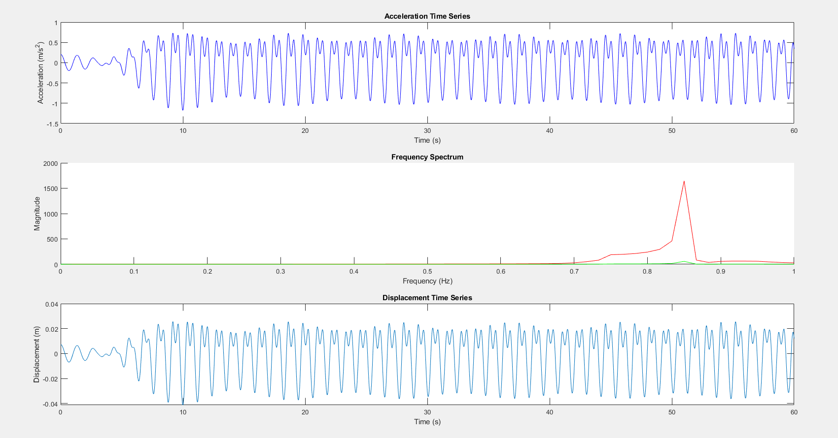

      Dear Sir, If you observe the acceleration and position curves of the time series in AQWA, you’ll notice that the position is essentially the second integral of acceleration, and as expected, the sign reverses (crest and trough issue).
      I am completely happy and satisfied with the acceleration results — they match the experimental results very well.
      However, the displacement results show an entirely different behavior. Notably, the secondary peaks are missing. This discrepancy is the reason I raised the query.
      If you feel it would be helpful, I am happy to share relevant screenshots from the simulation to support the discussion (initial position) . I kindly feel that the current responses are not directly addressing my query and instead seem to be circling around the issue or I am not understanding them better.

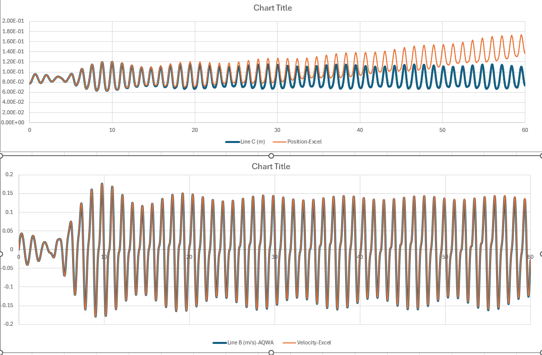

      The velocity and position are calculated maintaining the initial velocity and position values from AQWA results and plotted with aqwa generated results.
      • NVN NAMMA

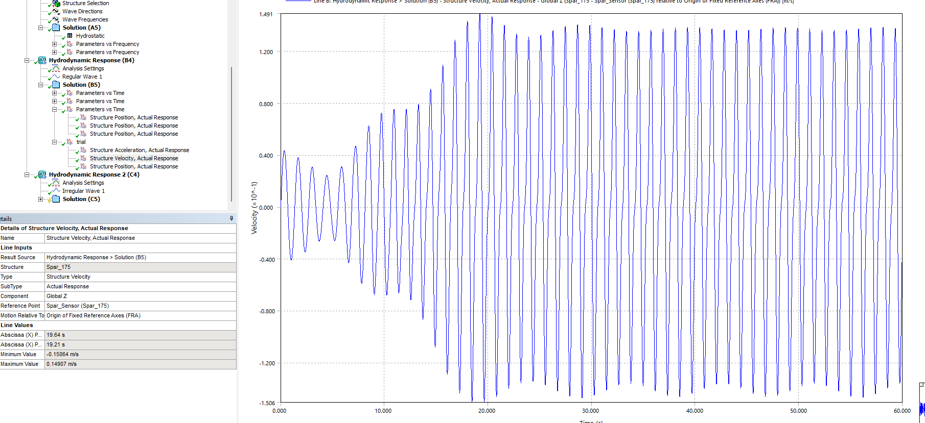

        This is the integration results. That is good match with velocity. Displacement plot is deviating. My time step is 0.01. Could you help me where can we set the initial position. I could find only two options there

      I believe this is in line with what you had suggested — I calculated velocity and position from the acceleration time series. Would you prefer that I do the reverse instead? When I attempted to derive velocity and acceleration from the position time series using the central difference method, the results were significantly amplified and did not yield satisfactory outcomes and far different from the aqwa results.

      Is your time step increment small enough? If not, can you please rerun your project with smaller time step interval, which may give you better numerical derivative results, i.e. position (aqwa) -> velocity; velocity (aqwa) -> acceleration.
      I am not sure you can have accurate integration results. Please see 13.9. Integration in Time of Motion Equation, the integrations from acceleration are not so easy and straight forwards.

      In Aqwa Workbench (or say, Aqwa Editor), you may not be able directly to set up the initial position and initial velocity, however they can be defined in Aqwa solver input data file, which file is automatically generated by Aqwa Workbench when running Hydrodynamic Response and stored in (your Workbench project)\dp0\AQW-1\AQW\AQ\Analysis\TimeResponse.dat.
      Please see 22.1. General Description for the input data format.
      If you want to set these data under Aqwa Workbench, you could use a python script from External Operation before Solving to add in the initial position and velocity into the input data file of  TimeResponse.dat.  Please see 5.10.1. Specifying External Pre- or Post-Solve Operations

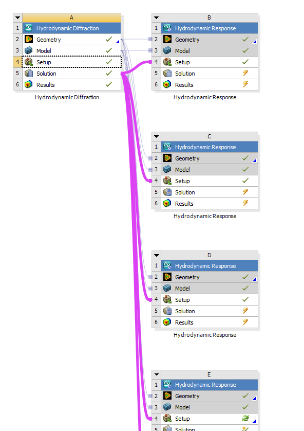

        Thank you for your response. I have one final query. While running a time domain analysis with a single diffracting structure, the options shown for initial positions were “based on geometry” and “program controlled.” However, when I ran the analysis with both a diffracting structure and a line element (i.e., two structures), the available options were “based on articulated position” and “program controlled.”
        Could you please clarify the difference between these four options:
        1. Initial position based on geometry
        2. Program controlled
        3. Initial position based on articulated position
        4. Program controlled (in case of multiple structures)
        If I have several test cases for the hydrodynamic time response, which option (initial position)would be appropriate?

      Please see 5.11.4. Starting Conditions.
             the positions in the hydrodynamic diffraction analysis will be used
             The equilibirum positions from the upstream stability analysis in Hydrodynamic Response may be used
             For multiple structure with joints, the program will automatically calculate the structures' positions to make sure the constraint conditions due to joints to be satisfied.
         4.Program controlled (in case of multiple structures)
            Program automatically finds the proper initial conditions either from equilibrium positions (stability analysis in Hydrodynamic Response) or the positions satisfying the constraint conditions if exist.
