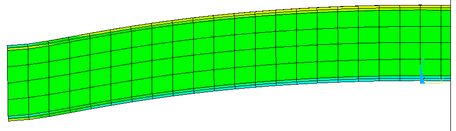

      I think my problem might be in simulating the same simple supports for the solid model as I want the sides of the model to rotate around the midplane as they are for the shell model (see picture)
      Shell model - core and face are rotating perfectly around the midplane.

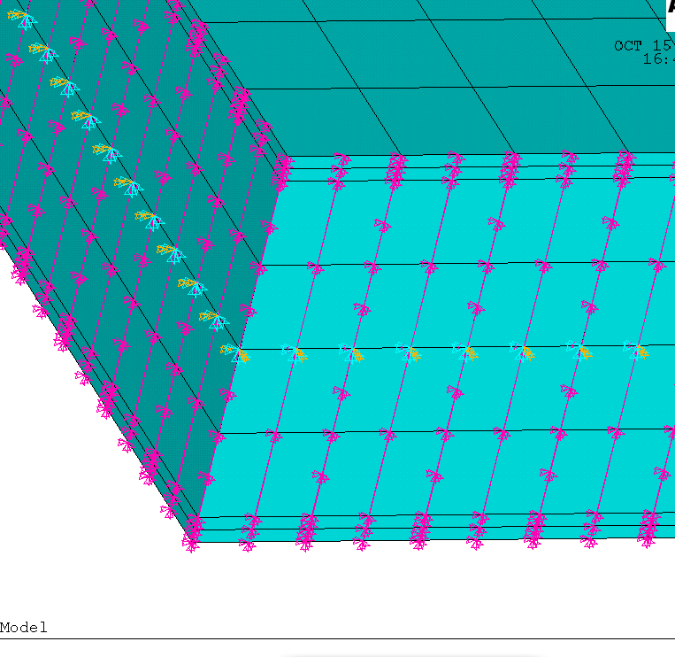

      I have tried all kinds of different approaches using CERIG and MPC184 but none have proven succesfull yet.

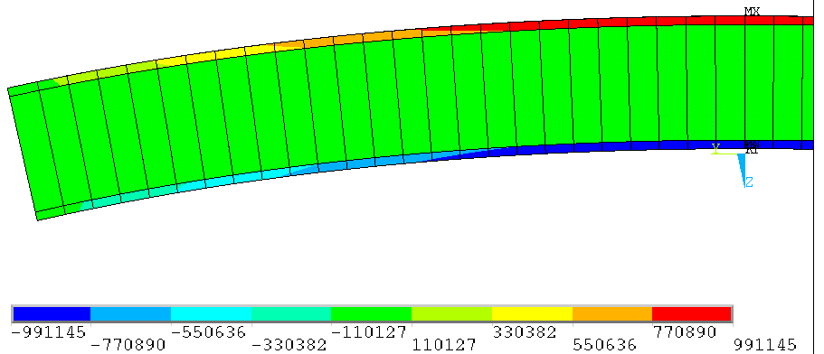

      The closest I have come is by using the CERIG command and MASS21 elements to constrain the node at the midplane (Master) to the nodes away from the midplane (slaves) in order to try constraining the slaves to rotate around the master (see picture).
      However, as you can see from the following results, the upper and lower edges of the sandwich are not rotating around the midplane in the same manner as for the shell model.
      Do any of you know how to implement simple support BCs to a solid model in order to achieve the same behaviour as a simply supported shell model?

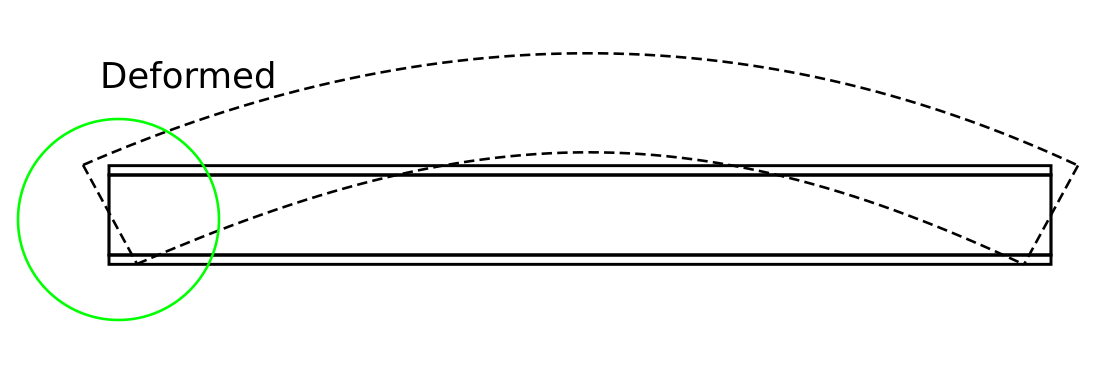

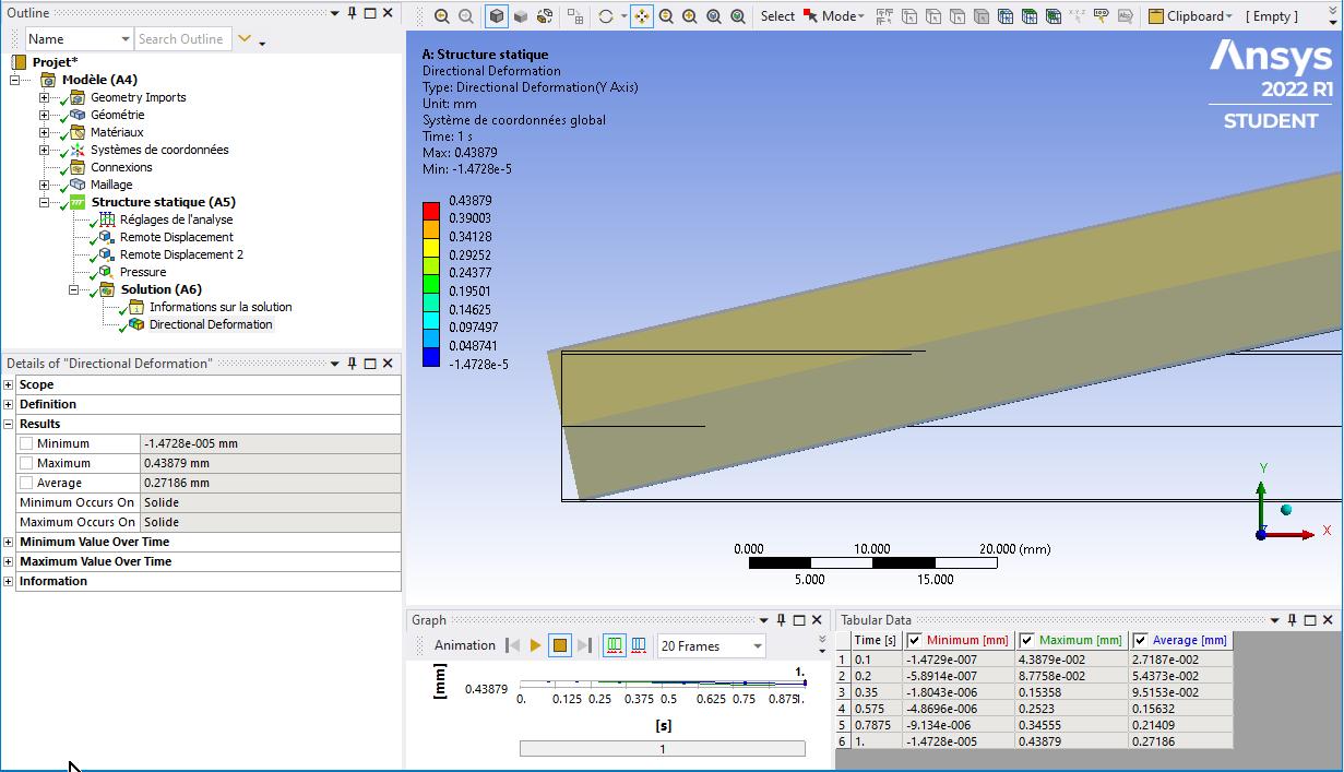

      Just to make it more clear how I would like the solid model to behave like at the supported edges.

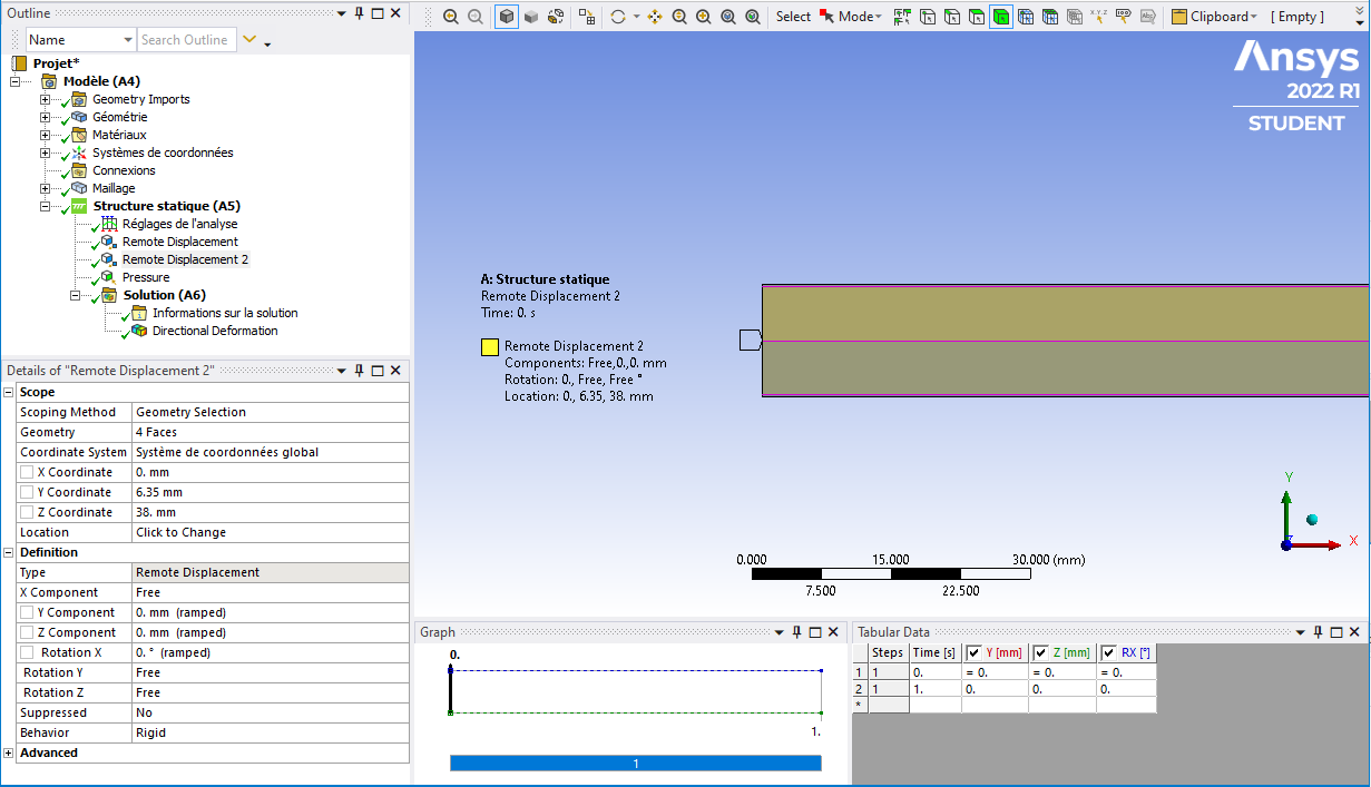

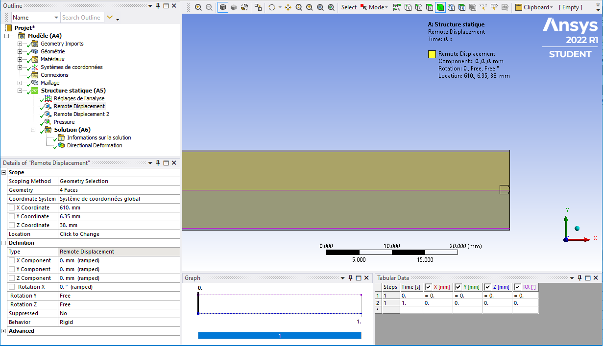

      I used Workbench instead of APDL classic interface and reused a previous student’s model to show you this example. I used a Remote Displacement, Behavior=Rigid, with a pilot node at the center of the end face. One one end there are four constraints as shown below.
      On the opposite end are three constraints, though the rotation about X is optional.

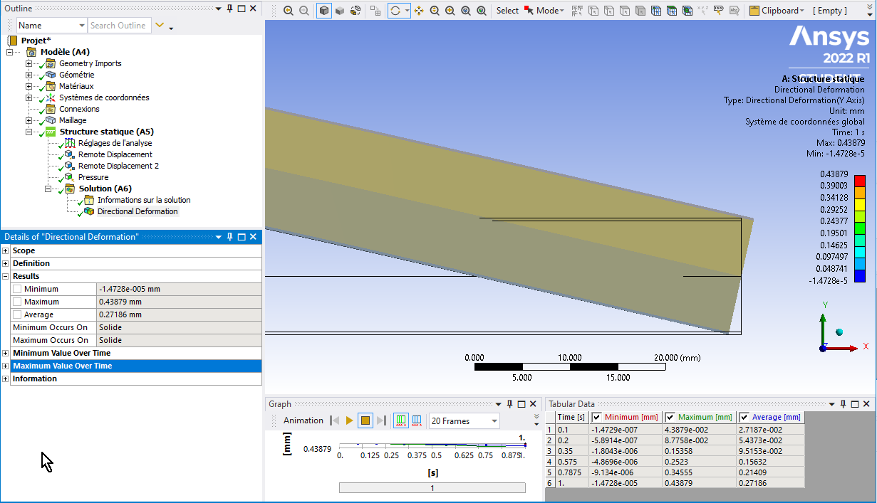

      These constraints provide the desired deformed shape.
      I hope you can translate these Workbench terms into APDL constraints.

      Hello Simon,
      Here is a link to the APDL code in a Sandwich.inp file: https://jmp.sh/D6RpYMU
      Here is a link to the ANSYS 2022 R1 archive file: https://jmp.sh/16sUstc
      In Sandwich.inp, look for the following lines
      /com,*********** Create Remote Point “Internal Remote Point” ***********

      Down in the Solution part of the input file is where the displacements are applied to those two pilot nodes:
      d,1121,ux,0.
      d,1121,uy,0.
      d,1121,uz,0.
      d,1121,rotx,0.
      d,1122,uy,0.
      d,1122,uz,0.
      d,1122,rotx,0.
      Good Luck!
