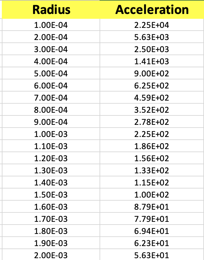

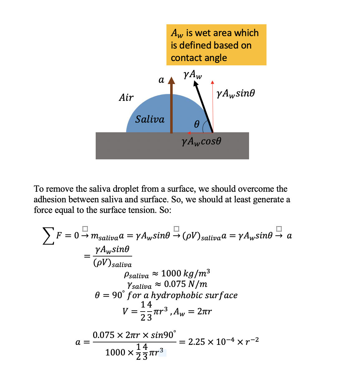

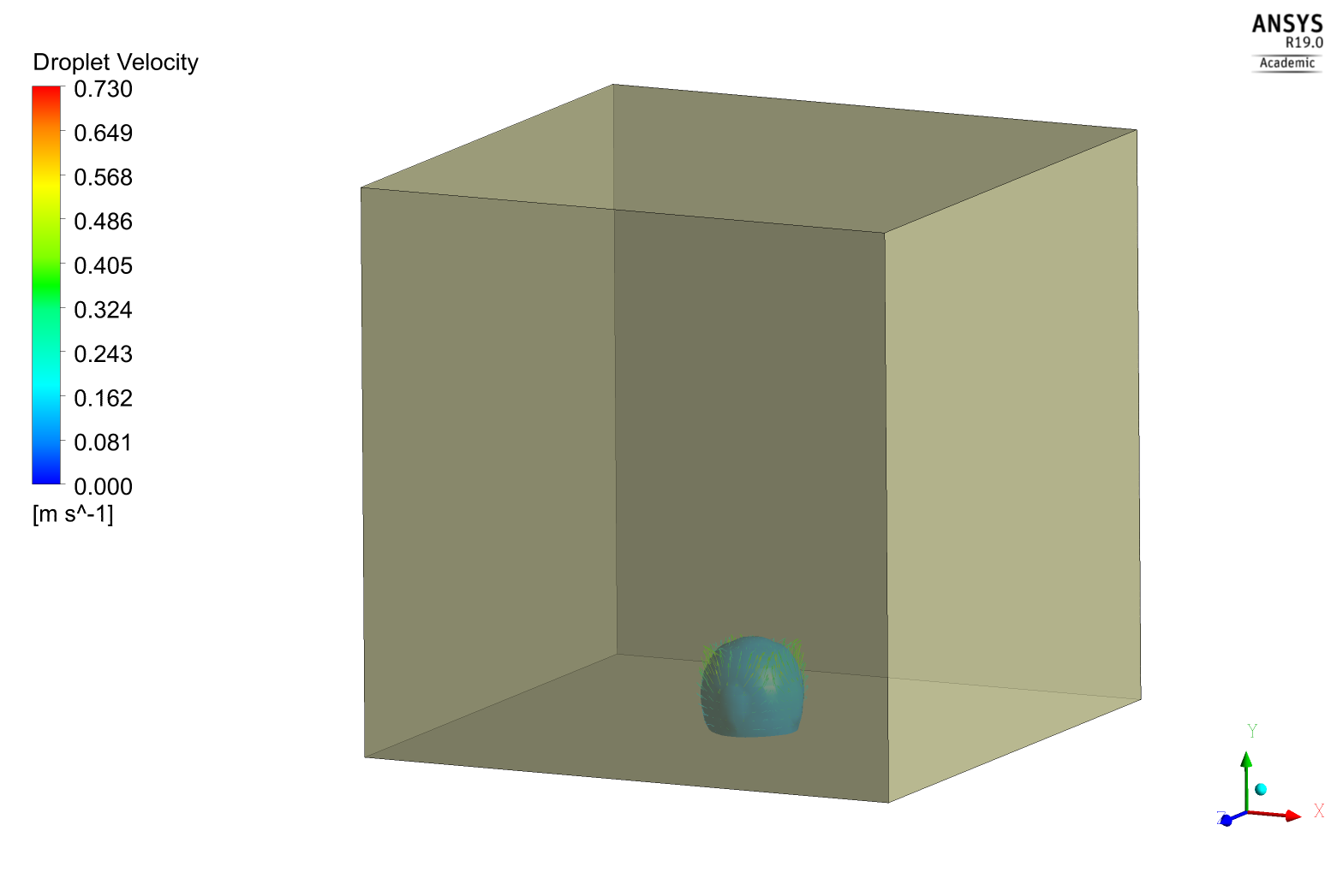

SubscriberThank you RobnI have around 400k elements and mesh is structure. I did not change the properties of water and air in Fluent database. I attached my calculations, I wrote a UDF, and now the droplet moves, but for example for droplet with 0.1 mm as the radius, I use 3000 m/s^2 on the droplet which is less than what I computed. Did I do the calculations correctly?n

Forum ModeratorWe're not supposed to check the maths: we're only supposed to advise on the solvers. However with 0.2mm diameter water droplets they will tend to stick to thinks given the surface tension. Check the contact angle on the wall too: that's often a source of errors as people mix the angles up. nViewing 3 reply threads- The topic ‘Applying upward body force on the droplet’ is closed to new replies.
