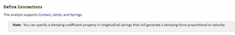

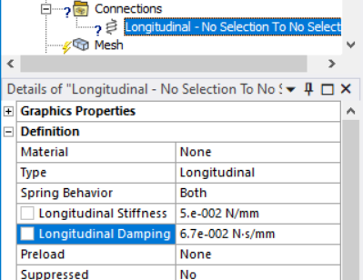

SubscriberSo unlike in the normal alpha and beta damping that we enter for analysis, this value will generate a force corresponding to the instantaneous velocity of the system, right?
December 20, 2023 at 1:40 pm
Matthew Middleton
Ansys EmployeeYes, it is only based on the velocity of the spring node.
