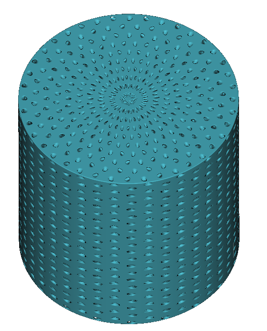

I want to simulate the compression test of the below structure using Explicit dynamic analysis.

Please refer to the following link for Symmetry in Explicit Dynamics Analysis:
2.7.1. Explicit Dynamics Symmetry (ansys.com)
By the way for the compression test - is it a very short duration (say a fraction of a second) test? If yes then Explicit is fine, otherwise, you may use a Static Structural analysis.

SubscriberThanks a lot, Ashish for the reply!!
