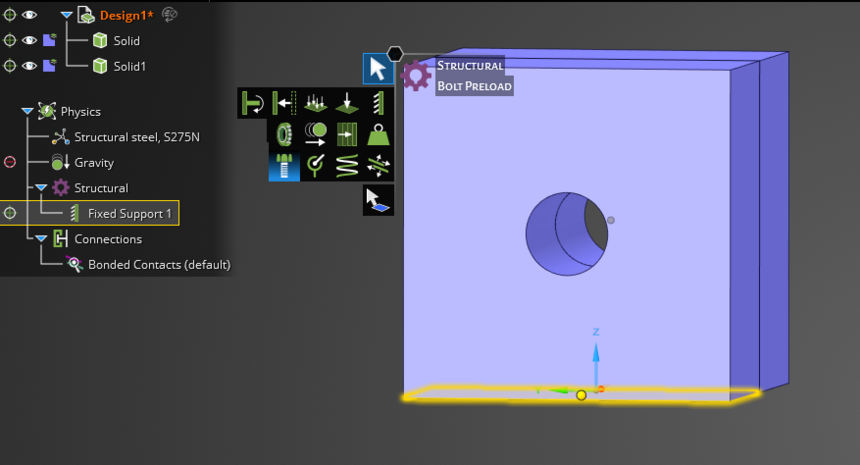

      Hi, all!
      I have a question about how to use Bolt Preload.
      I made the system in Refine Mode like picture below;
      (It has two bodies with hole, and bodies are bonded)
      But, if I activate Bolt Preload, I can't choose cylinder face.. also, there's no highlight when I moved mouse pointer on the faces.
      How can I apply Bolt Preload on the cylinder face?
      Please give me the examples of that.
      Best Regards,
      Jugyeong Shin
    • Charudatta Bandgar
      Hello JUGYEONG SHIN Please go through the video explanation in this query (first comment, attachment titled Bolt_preload). Bolt preload on cylindrical face is not possible if you are working in explore mode, although you can use assign tool to create a 1D beam element, and apply preload to that.  You can apply bolt preload on the cylindrical face, if you are working in the refine mode. Regards.

        Your Video was so helpful!! I misunderstood Bolt Preload.
        I thought that cylinder faces of holes can be used as Bolt Preload face, but it's not..
        Thank you so much~~ :-)

        JUGYEONG SHIN Hello
        That is a capability in development. Will be available in explore in the future release.
