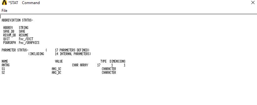

    • jj77
      this works:
      *dim,ANTAG,CHAR,17
      ANTAG(1,1) ='AN1_SC'
      ANTAG(2,1) ='AN1_DC'
      and so on
      Have in mind that CHAR are upto 8 characters long, but that is OK for you now.

    • jj77
      Not sure which part is not working. If we take the array part first, then take this and paste it in to the apdl command window on the top, that works.
      *dim,ANTAG,CHAR,17
      To see the values one can set a scalar s1=ANTAG(1,1) and look at s1.
      See below:
      If you mean that the whole script (running batch mode) does not work then I do not know why.

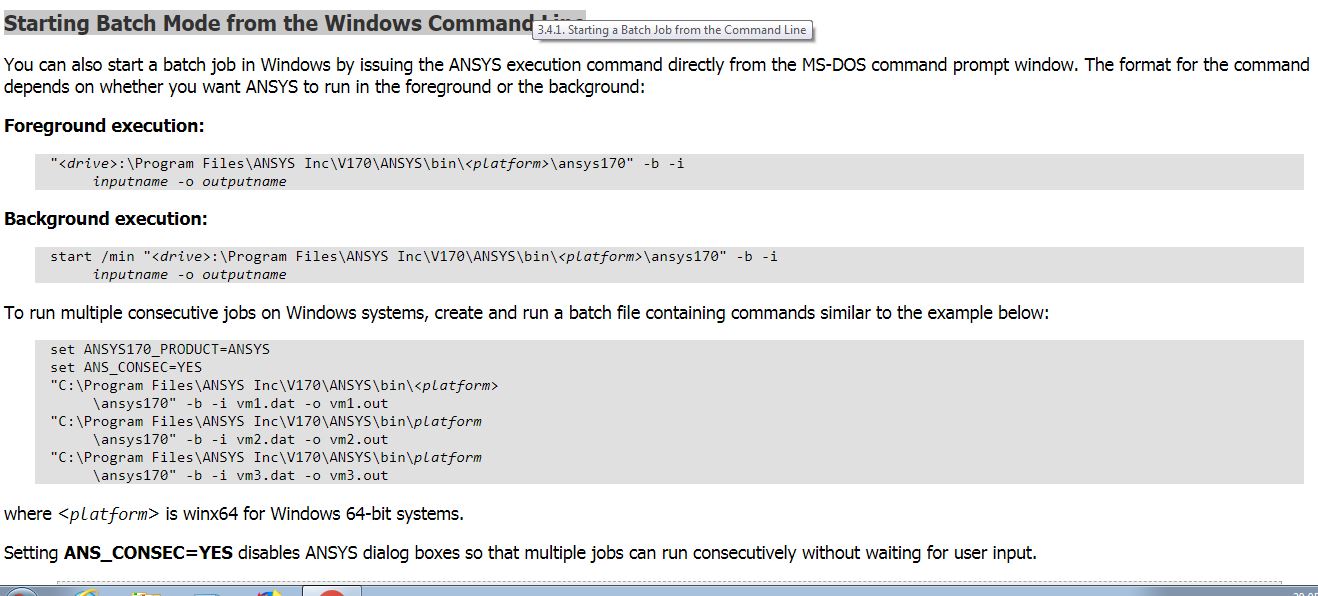

    • jj77
      There might be an easier option as described in help:
      also this might be of help
      https://www.eng-tips.com/viewthread.cfm?qid=277708
      also this post from Peter is very good:
      /forum/forums/topic/need-help-on-creating-the-script-file-for-launching-ansys-mechanical-job/
