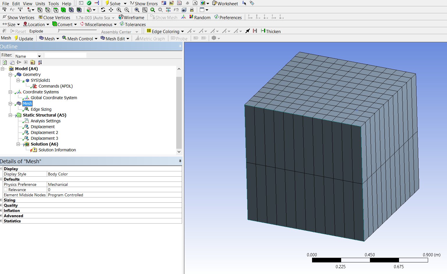

    • jj77
      As Sandeep says the way you model and include apdl commands in workbench is not as ideal. Follow the links and tutorials as indicated and practise.
      Now for the model:
      - Make the cube in say Design Modeler
      - Include command for the material part only (see image below - yellow marking, and command on the main window). Make sure to have the sub. routine in the same folder as the workbench files.
      - Apply the displacements yourself in workbench (see red marking bellow). Apply the enforced disp. gradually (10 steps of 0.1 m)
      - Use the analysis settings as shown below.
      - Use coarse mesh (say 0.5 m sides on  HEX el.).
      That works.

      Hi. Follows the pictures of my settings. Still error. Confused.
    • desouzadacosta
    • Sandeep Medikonda
      The error says that you don't have any loads in the model? Like jj77 says, apply a displacement using boundary conditions over a few steps.

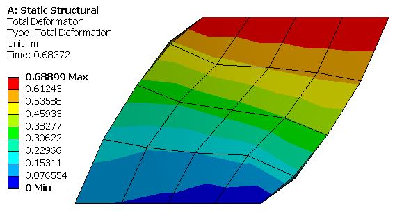

    • desouzadacosta
      Hey peterozman
      help us. We are in complete darkness about this issue.
      Hey desouzadacosta,
      Is your goal to run an apdl script?  I'm not skilled in that area.
      Is you goal to shear a cube of material with a neo-hookean material model? I can help you with that in Mechanical.
      I followed jj77's advice above and just included the code for the material.
      Peter
      ANSYS 19.2 archive attached.

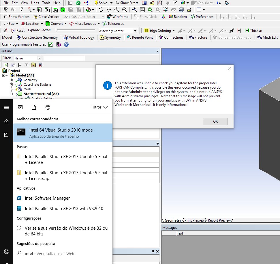

    • desouzadacosta
       Hi Guys,
      Back in the business of running TD 38 inside structural workbench.
      I installed all the required compilers for the ACT UPF .
      I reproduce below the troublesome messages.
      Any piece of advice would be great.
      Thanks,  Alex
      Please delete the duplicate post. It looks like you are putting the same error message in four times. I don't see the difference.
    • desouzadacosta
      Hi Peter,
      Thanks for the reply.
      My apologies, some how I uploaded the same figs. I am going to upload the different ones.
