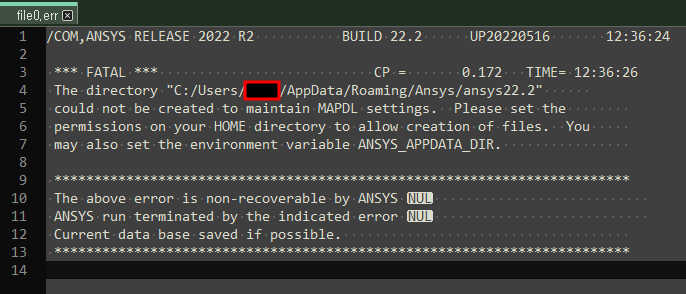

      I have problem running APDL. Error files when I run the SW is in the picture.
      I think it is because the home directory is set to the deleted user name in windows. The name is also not in alphabet.
      I that the cause of the problem? How can I change the home directory of the APDL?

      • WONSEOK CHA
        Thank you for the reply, but that was the launcher result.
        I tried running with the APDL itself, not the launcher, but still it didn't work.
        I addition, I tried deleting the user ID in window10 and reinstalling ANSYS.
    • George Karnos
      What happens if you close all ANSYS Programs, then:
      got to:
      %APPDATA%\Ansys
      Rename the v222 directory to v222.old
      Then try to run?
      • WONSEOK CHA
        Thank you.
        I have solved the problem with your solution and also running the SW in 'Run as administrator'.
