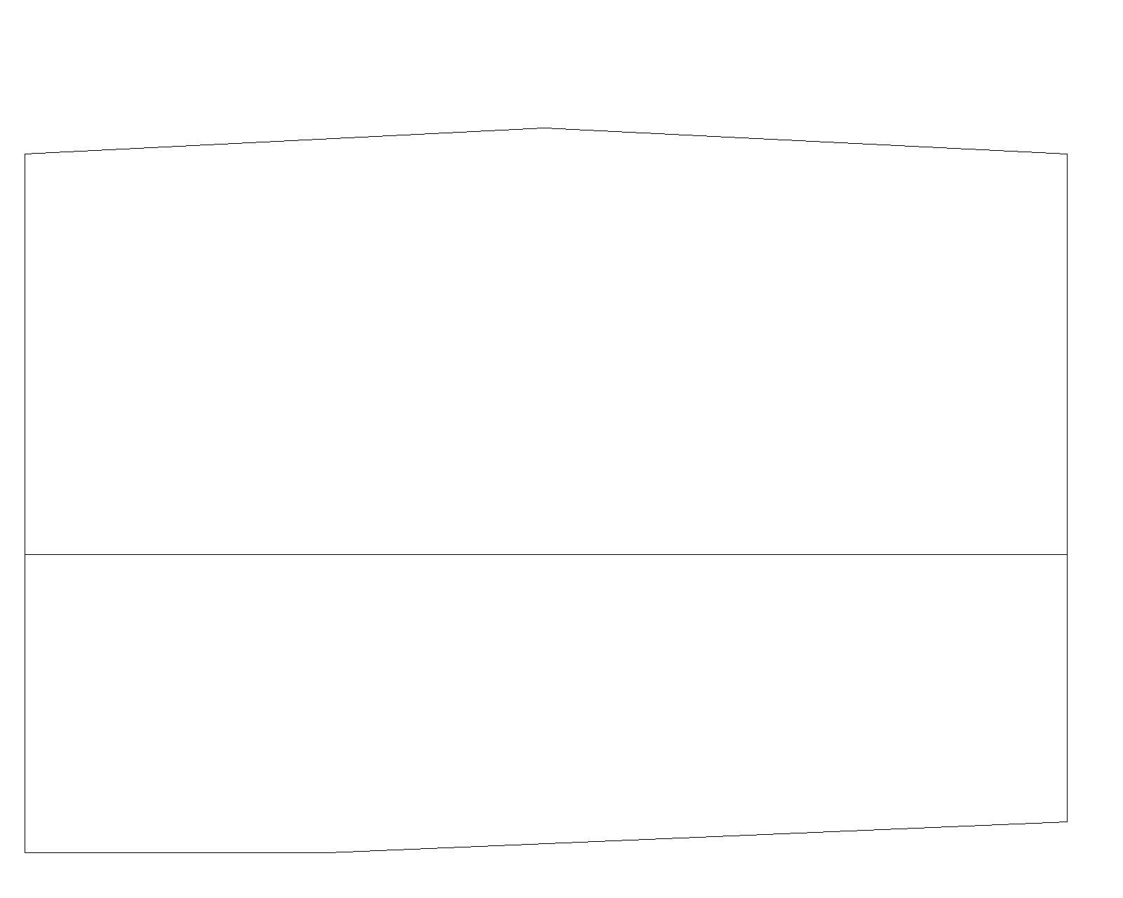

      Hi Guys,
      I am a bit new to APDL and trying to model layered soil system in APDL. How can define contact (simple bonded or etc) in a 2D layered soil system. Maybe for following extremely simple example...
      Thank you in advanced

      Hi Mr Starling,
      Thank you very much for your answer, it is really helpful.
      I have a question. As per the above very simple diagram. in a 2D layered soil system. this contact (contact between soil layers) should be surface to surface or line to line?
      Thank you very much again
      Have great start in the new year 2020
    • BenjaminStarling
      This contact is defined as surface to surface. It is a line shape element though. You can check your model by confirming the contact elements that are created. You should see Contact 172 elements defined.
