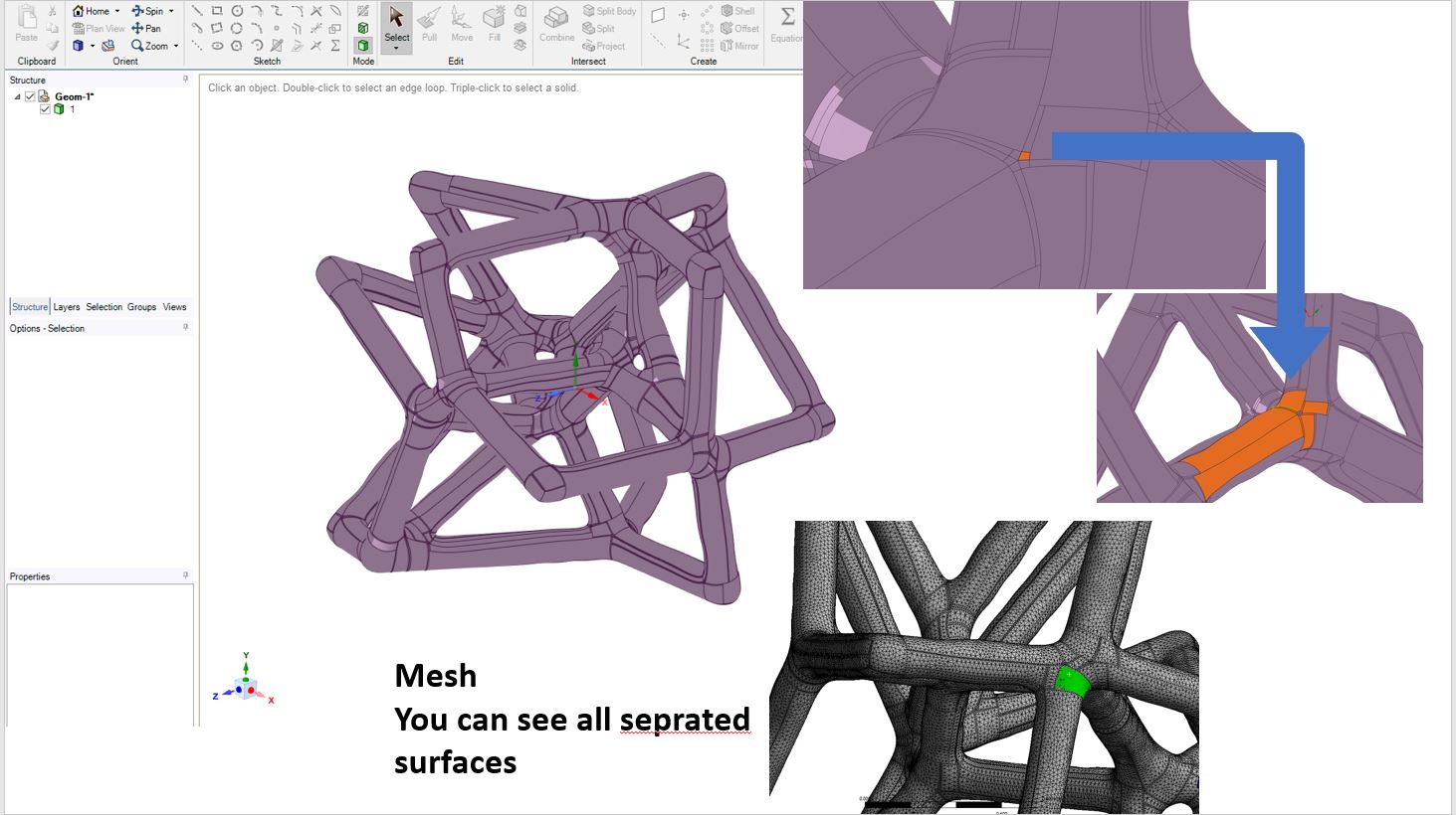

Indeed, there is some problem here. I mention them one by one maybe you can help me to find a solution. I tried to follow the directions in that link that ramgopisetti mentioned.
I wanted to model so complex structure like the Voronoi lattice, they are irregular beam strut that they are connected to each other. sometimes if they are full of struts with gradient thickness that it is so difficult to export CAD files from them. In nTop there is some process to do that. at first, we should define tetrahedron mesh and next convert it to quadrate and then export CAD file, but for my structures due to the connections and complexity, converting to quad is impossible and give me some errors. it means I can not have a CAD file(STEP or Parasolid) from my lattice.

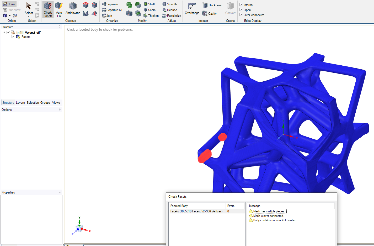

I tried to export a CAD file for a simple Voronoi structure. it is so simple with big porosity and few beam struts. after that, I import my step file to ansys, there are so many small surfaces that I should merge all of them, and sometimes I face an error that they can not be one surface. ( think
I tried to mesh my imported lattice with these small surfaces, but if you see the images. the mesh is not good because of the existing so many separated surfaces.

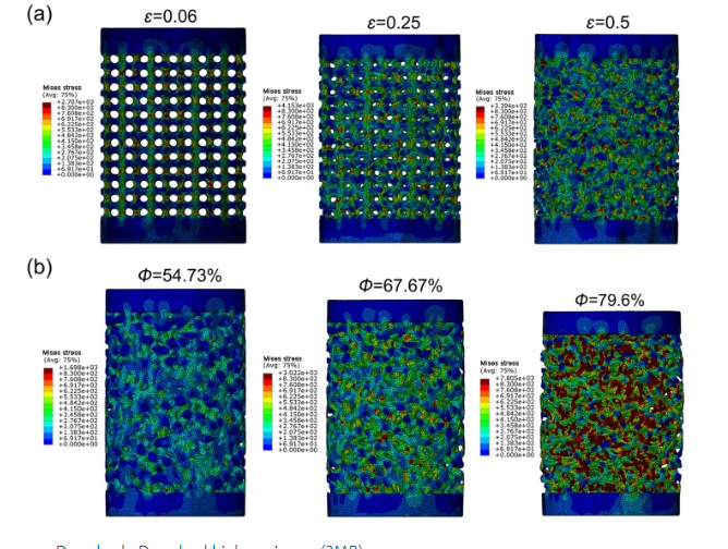

My goal is to model some complex structures for bone application (I put some images below for showing to you what is my mean, these are from some papers that I found) . These complex structures can have different thicknesses, different pore size, and different unit cells type in gradient in for example z direction( you can see in below images).
nTop and grasshopper completely cover this requirement for designing and they have really perfect options for designing suitable lattice for bone application and 3d printing But I chose nTop because is free for students, and no need license.
The next step after designing , is doing a compression test in both experiments and FE analysis to choose the best one from a mechanical point of view. and then comparing FE result with experiments. Now there are two aspects:

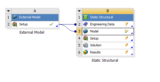

Obtaining step or parasolid file for complex structure is so difficult as they mentioned in their website as well. i think this option support simple structures like optimized structures or less complexity. For exporting so complex structures it gives you an manifold error. So just left two other option, exporting STL file or FE mesh.
They suggest to export FE mesh for using in ansys, I tried that. And I saw that after importing FE mexh as cdb file, I could not define any other geometry (i mean solid body / surface to do compression test)
For importing cdb mesh file to ANSYS, I used "external model" option, and if i connect it to "static structural" , I could not edit any thing to add some solid body or etc.

images that i mentioned before:
- this is one type of my desired structures, that i can design with nTop.
2 another image in one prepare ( used grasshopper and Abaqus , the did not mention about how they bring model to Abaqus) scaffolds and EF analysis:
i want to do sth like this with ANSYS.Thank you so much, for your help. and your time, is it so valuable for me.

SubscriberHi Array , sorry for the delay, ok it’s clear to me that you want to model vornoi structures, this is easy if you employ algorithmic design via grasshopper using rhino.
Based on the image what I can see is that lots of surfaces which are generated because the engine behind ntopology was bsplines and implicit modelling , to simply your process, you need to adapt to ANSYS discovery to import the geometry as obj and setup the simulation and transfer it to workbench for additional and detail study. By this you can screen the issues and reduce the geometry preparation.
you have to export the body from ntopology as obj and you can import it into discovery product.

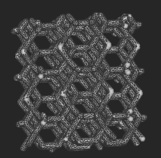

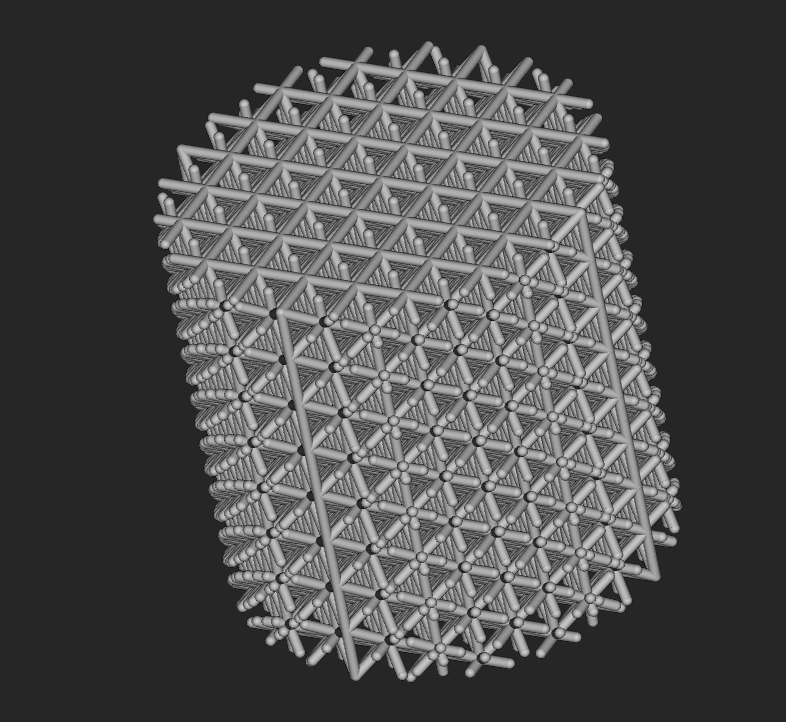

I want to perform similar kind of analysis for my research work. I created a lattice in ntopology and exported mesh from implicit body as stl file to Ansys workbench. But in Ansys I could not select the nodes or do mesh. I also want to perform compression test. Could you help me please?
January 28, 2022 at 10:38 am
Mansoureh
Subscriber.dayakarthic
You have to export the mesh in the format of .inp and then import it to ansys to do the rest work. you have to define your plate in ansys in mechanical model and then connect them to your main block to do the rest of the analysis. STL format does not work in ansys for our case.
January 28, 2022 at 11:51 am
dayakarthic
Subscriber.Mansoureh

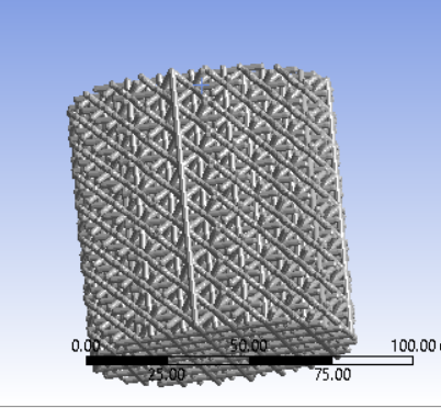

Thankyou so much for helping me. My lattice looks like this. I could move my STL file to ansys but I can't generate mesh. It is showing poor quality or incorrect input error. It seems I need to do FE Volume mesh to export mesh as .inp file as you told which is taking hours to complete sometimes ntopology closes automatically in the process due to overload in our system. I also want to add that I cannot select faces in Ansys because my component is fully latticed. I do not know how to add top and bottom surface for analysis. Sould I need to do that in Ntopology or Ansys. My project needed to be completed only using ntopology and Ansys. Once again Thankyou
January 28, 2022 at 9:19 pm
Mansoureh
Subscriber.I would suggest you to change the dimension of your lattice bigger than that, use a big unit cell and thicken the struts, normally it takes time to mesh this type of structure but you should try several methods to mesh for example "mesh implicit body by voxel grade" tor " mesh from implicit body "and play with the parameter and the use remesh surface to reach to the final mesh. you should play with parameters to understand which method is better to create a mesh and which one gives you the best mesh, i think this ability just can reach by practicing.
If your structure is so heavy it will be close, try to optimize your lattice at first then try to mesh it.
you should create the face from your lattice in ntop. if you look carefully onto the top and bottom of status of your lattice, they do not have any surface, they are just like dots. Create your lattice bigger than your final dimension and then cut it into the desired size so you can have the surface on the top and bottom. you should extract the face with your mesh. try to watch some video to figure out how to do that
you have to create the final plates for the compression test in ansys as i said before.

Thankyou for your valuable suggestion. As you said I decreased my lattice size and successfully created FE Volume mesh. I also could add my .cdb file as external model in Ansys workbench. Finally I have one doubt, I am not able to attach plates top and bottom can you tell me how to do it exactly ( steps ). I tried analysis by selecting nodes but that did not work. So please tell me how to add the surface plates top and bottom to do the analysis. I have attached pictures of my new lattice and ansys workflow.
January 31, 2022 at 6:07 pm

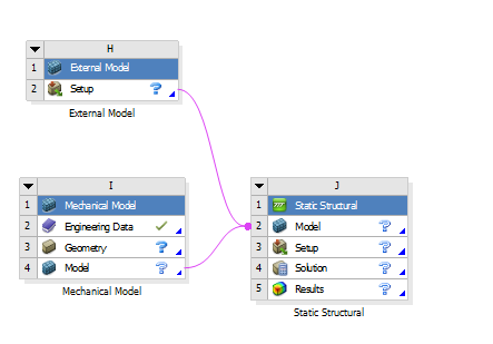

Sean Harvey
Ansys Employee.Hello dayakarthic
If you create another mechanical model and setup the two plates as solids in SpaceClaim, then you connect as shown below. You then can use bonded contact to connect each plate to the lattice. In the bonded contact you can increase the pinball radius to capture more nodes of the latices if necessary. Imagine the plate is "glued" to the lattice. If you don't use enough "glue" you may just capture the tips of the lattice, so increasing pinball grabs more nodes like a thicker layer of glue. You can also go to each of the bodies of the plates in the geometry, pick on it and, and in the details, change their behavior to rigid to savecomputational time. You will then need to use remote force or displacement to control the plates, as regular displacements, forces won't work.
Notice I don't have the engineering data shared as you do, not sure if you need that shared, but the below technique of sharing multiple modes with a single model cell is called model assembly.
Try this technique and see how goes.
