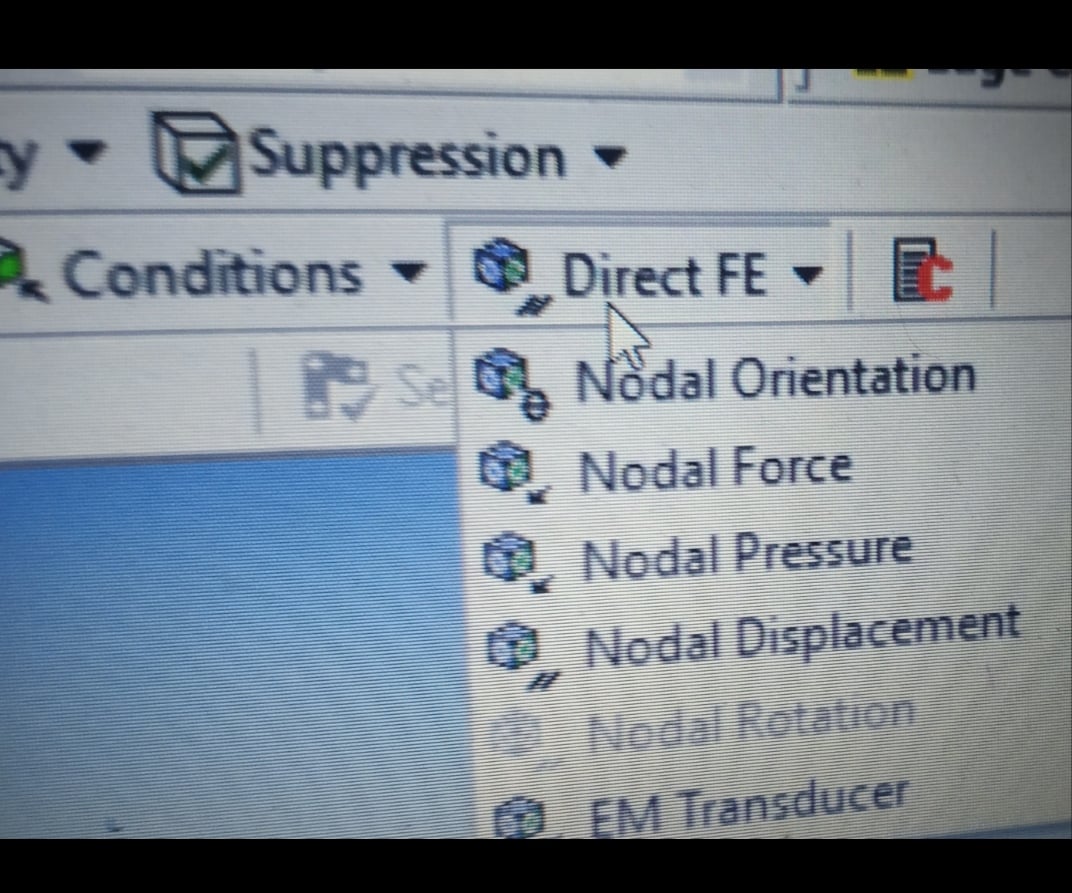

SubscriberHow nodal rotation option can be highlighted in static structural of ansys workbench -

Aniket Chavan
Forum ModeratorPlease use something as snipping tool on windows to take screenshots instead of using a camera phone.
Anyways, Please check :
It mentions that Nodal Rotations are only supported on Shells and beams.
