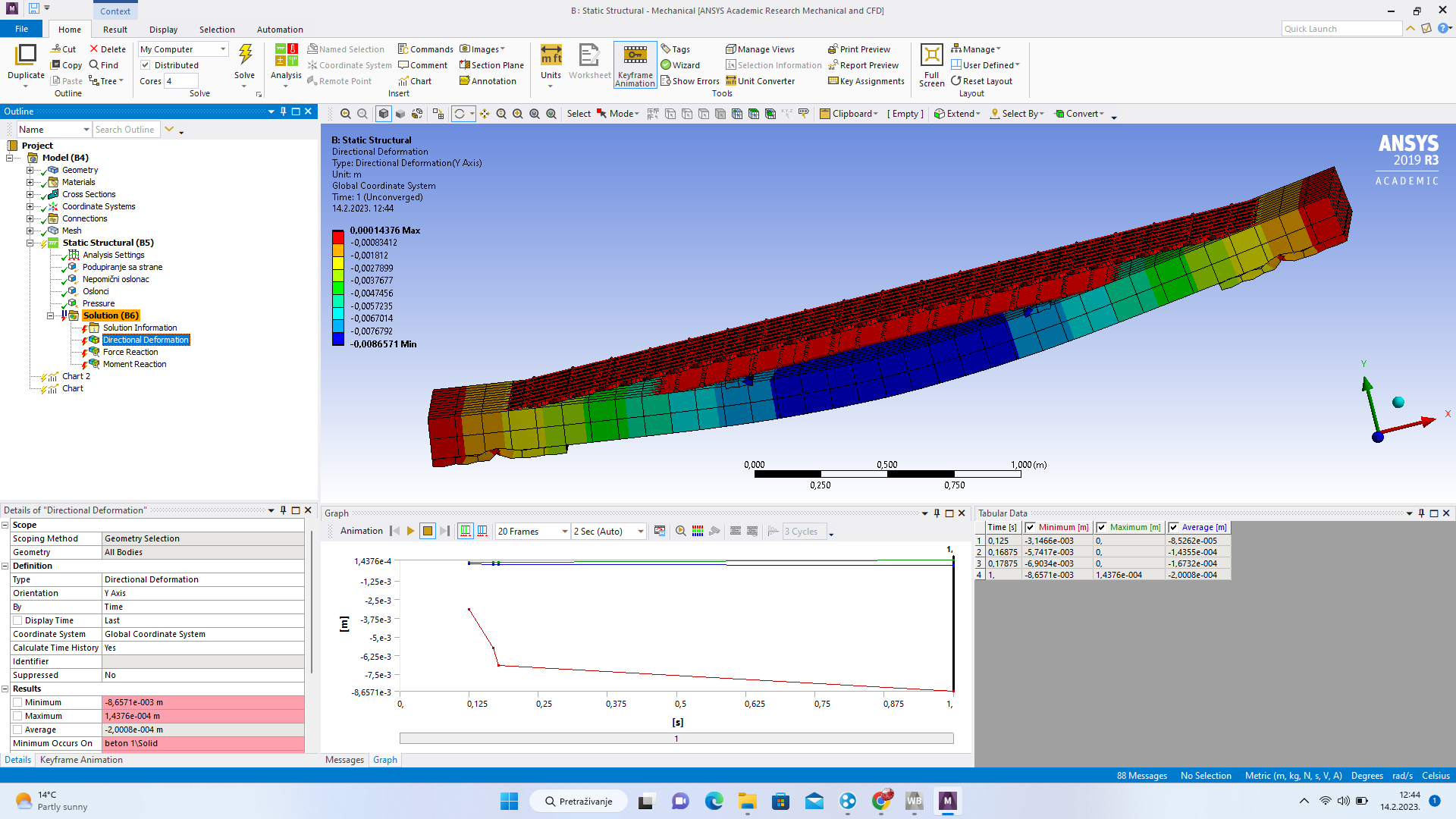

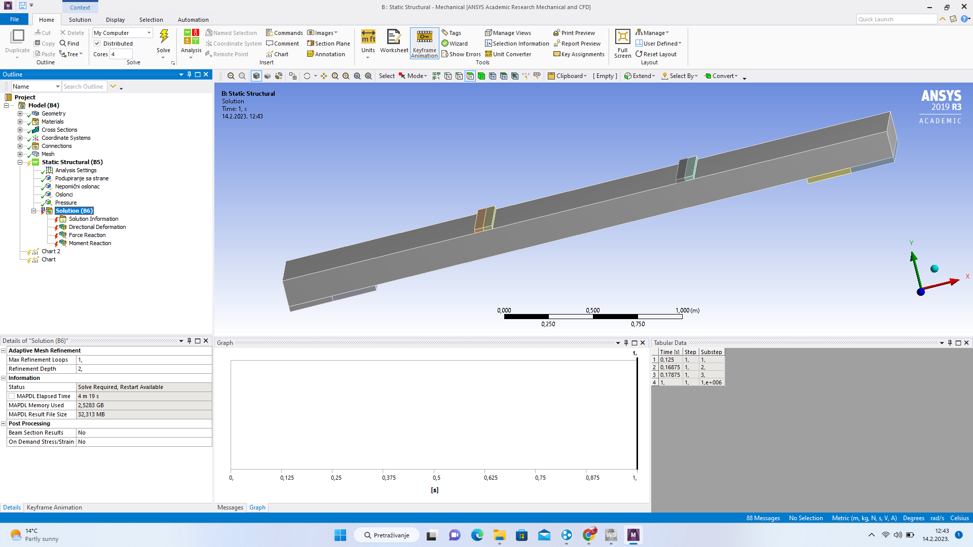

      Hello everyone, I am phD student and I am working my experiment test on Ansys. I am modelling concrete block reinforced with armature, so I don`t know how to make armature as REINFORCEMENT. I am sending two pictures where you can see my problem.
      Greetings,
      Stanko Čolak
      Opens An Image14 mceclip0
      Opens An Image14 mceclip1
        Please create a new topic in Structures for attention.
