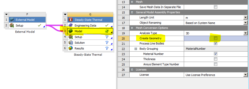

      It's 2mm Mesh, and the size of the model is 10MB. The material property is assigned in bonemat and saved in .cdb file. This .cdb file is imported into Ansys workbench using an external model module. Attached the picture for your reference.

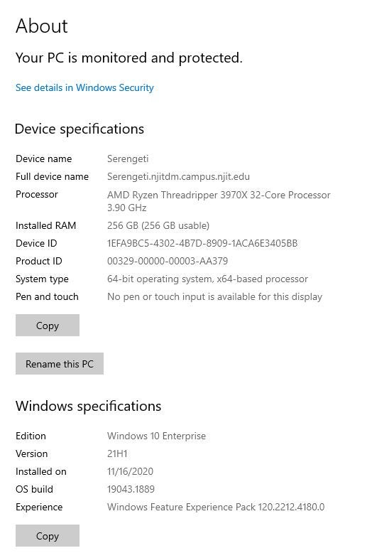

      It's taking too much time to load. Almost it is taking 2hours to just load. I am using 256 GB RAM. Also, the processor is AMD Ryzen Threadripper 3970X 32-Core Processor    3.90 GHz. I think some setting has to be made. Kindly let me know what to do.

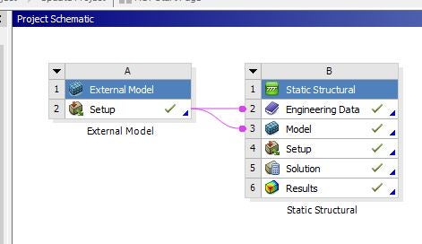

    • chethan.kanchanahallinarayana
      Yes, It is taking too much time to load into the extral model system, and also too much time when I connect to static structural and turn into a green mark state. [Almost 3 hours just to load and turn into green]. After that, it takes too much time again to open in the Static Structural system.
      Once it loads and opens I don't have any issues in running the analysis.
      I have saved it into a local Disk(D) by creating a folder. If you can connect me online in a zoom meeting I can share my screen and show you the problem. Looking forward to your response

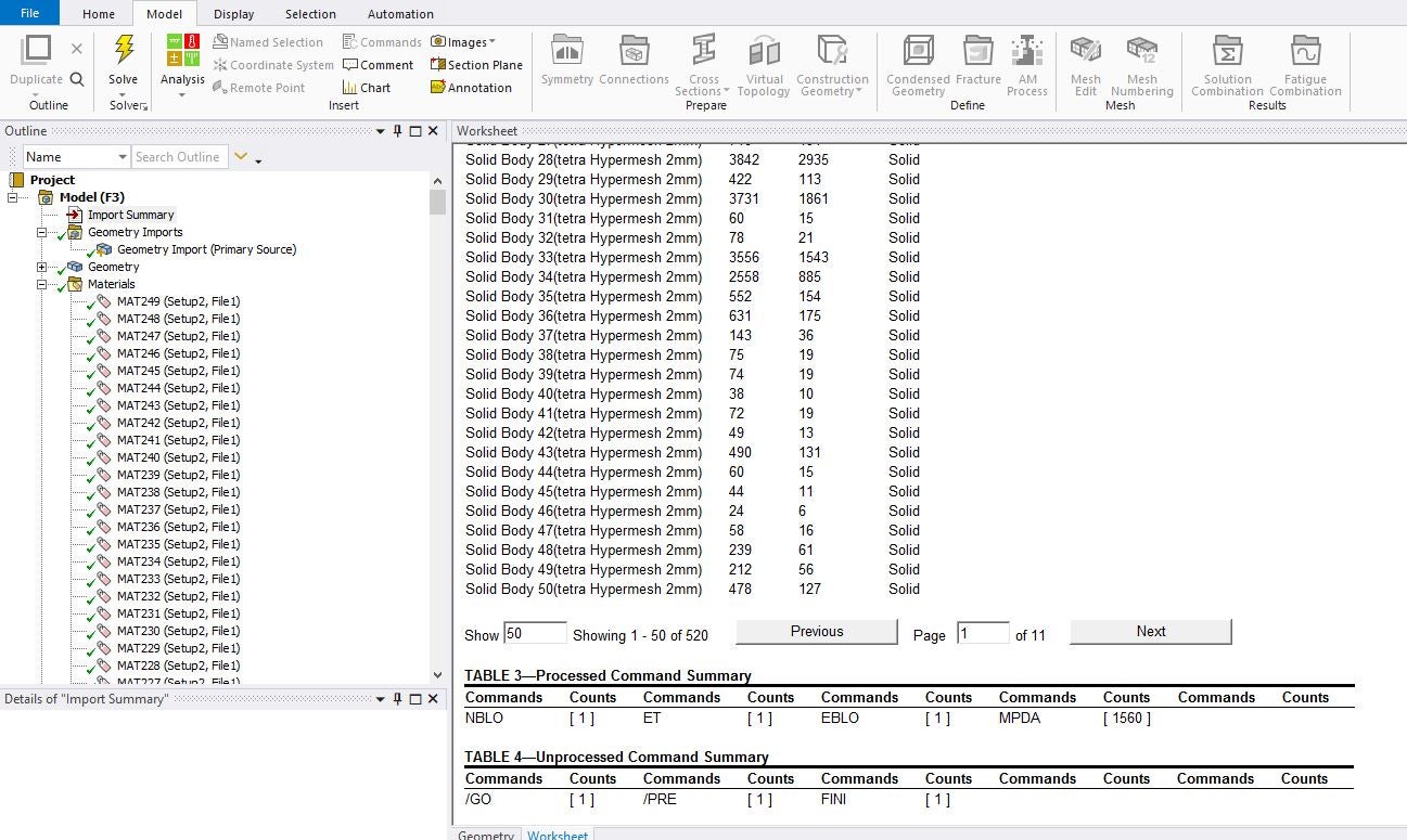

      Hi Chetan
      Does the FEM happen to have a unique material model defined for every element?  Or does every solid element have a unique local coordinate system defined?  If yes to either how many material models or coordinate systems are defined?
      Mike
      Please find the pictures. It has a summary. Total nodes 177248 and total elements 66589.
      The computer system has 32 core and 256GB Ram with AMD Ryzen Threadripper 3970X 32-Core Processor    3.90 GHz

    • mrife
      Chethan
      Please try the following: on the WB Project Page right-click the Model cell of the Static Structural and chose to Reset it.  Now make sure that the Properties view is on (WB -> View -> Properties); single click the Model cell and uncheck the 'Create Geometry' on line 20.  Now open the model: how long does it take to process?
      Mike
      Dear Mike,
      I have followed the steps you mentioned in the previous chat.
      1. I have imported .cdb file first to the External model and updated it first. {It got updated fast]
      2. Then I called static structural and linked setup to engineering data. [It took 5min to update]
      3. Next, I connected the setup to the model and unchecked 'create geometry' line 20 as you mentioned
      4. Now when I try to open it takes the same as last time to open almost two hours [The system hangs for a while if I try to open]
      I have attached my system configuration for your kind reference.
