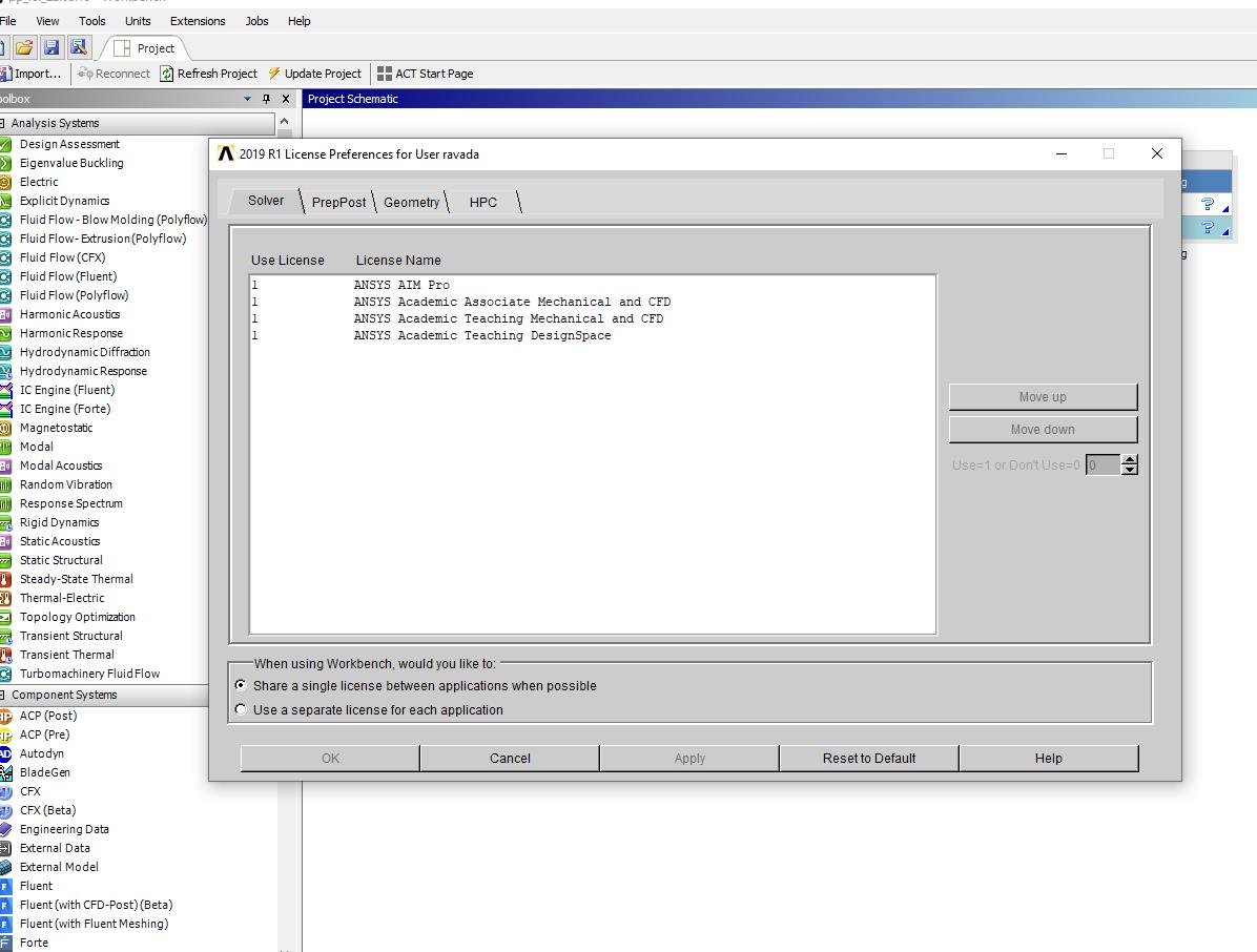

Currently, I am working on ANSYS Workbench for 2 way FSI simulation using system coupling (Transient structural + Fluent). I am actually facing some issues especially with ANSYS 2019R1. When I am trying to open my project i.e. FLUENT setup I suddenly get error messages as shown in the screenshots which I have attached in this Message. I am using ANSYS Academic Associate.
License preferences are all fine yet I am unable to open Fluent. And when I am trying to close it, I could not close and then later I have to forcibly end the program due to which the ANSYS directory is getting corrupted and I am losing my ANSYS project totally.
 Kindly, let me know where am I going wrong and how to solve this issue ?

Forum ModeratorVKI is a different issue and isn't a problem here.Â
I suspect the problem with the files is the ? in the path. Open Workbench and "save as" into a folder with no command (eg " ! ?) characters in the path or file name.Â

SubscriberHello,
Thank you rwoolhou for your help. It is working fine now. The error was in the name of the directory. I earlier used 'µ' symbol in the name that is the reason why it is showing ? mark over there. Now this issue got resolved after changing the name of the directory. I could open the file without any errors now.
