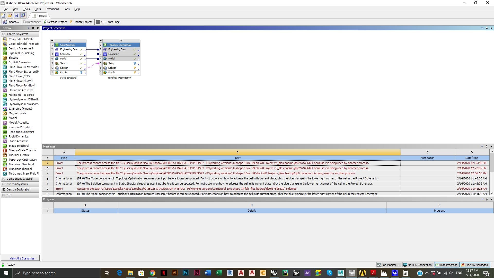

SubscriberWhen I click solve for the topology optimization, it does nothing and only shows an error stating: "The nonlinearity exists in the analysis. If the Topology Optimization solution is performed and convergence is met, then please check to see if the solution is acceptable.
Can you please help me solve this problem.
February 17, 2020 at 2:58 pm
peteroznewman
SubscriberIn the first image, I see errors that say the file is in use by another process. I suggest you make a new folder on the C: drive called C:ansysdata
Save the project into that folder, then try to solve. The files in this folder will not be accessed by any other process.

February 18, 2020 at 12:06 pm
peteroznewman
SubscriberThat is a warning message, not an error message.
Topology Optimization works well on linear models. It may not be stable on nonlinear models. Therefore, if the Topology Optimization converged, you must check your results carefully to see if you think it has found a valid optimum.

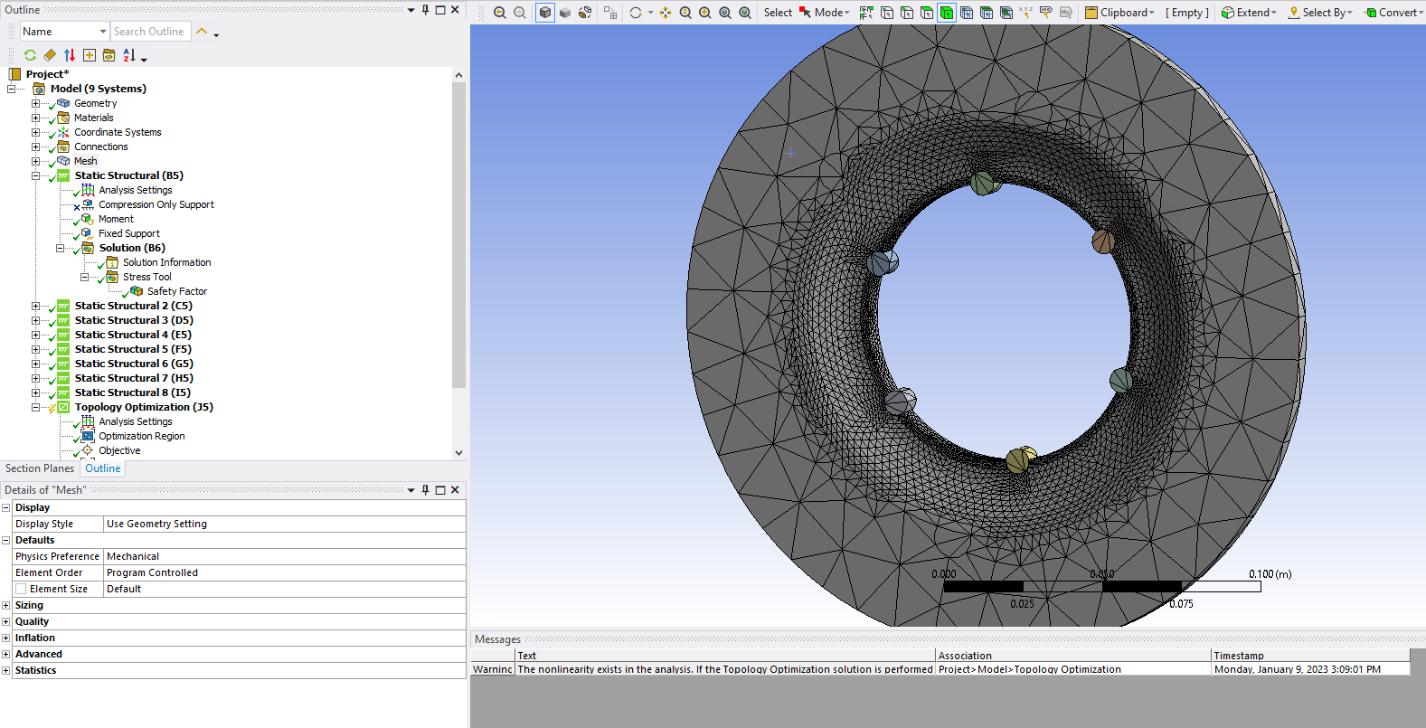

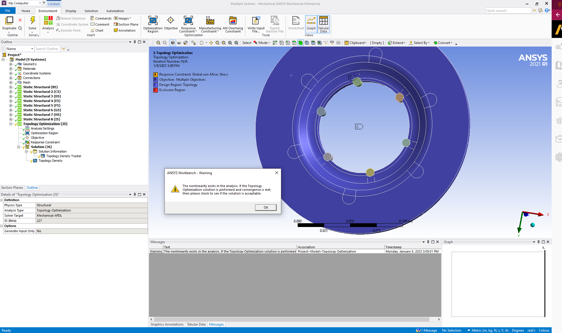

January 9, 2023 at 9:16 pm
Benjamin Huff
Subscriber -
June 15, 2023 at 5:49 pm
Chris Miller
SubscriberI have found that if you have friction in your model [a nonlinearity] that the TO algorithm may not function. Try simplifying your contacts if you have friction ...maybe by bonding.
