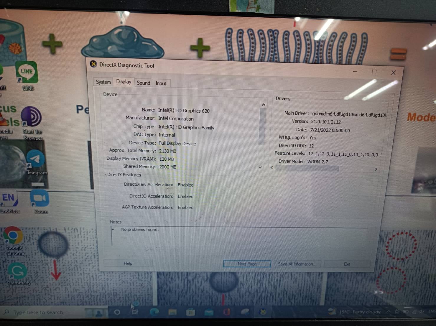

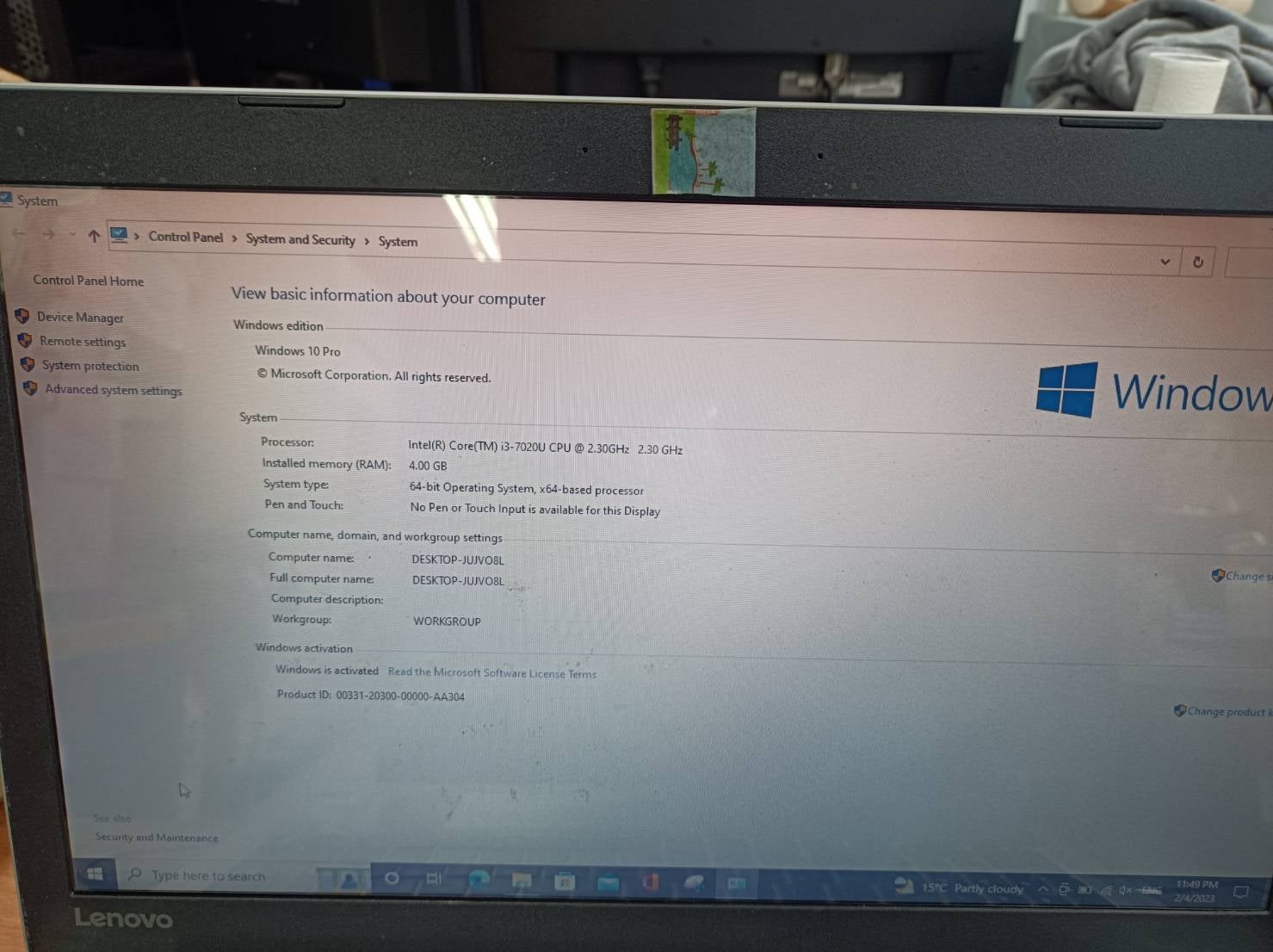

    • Vignesh Sahadevan
      I want to know if my graphic card is sufficient to run Ansys.
      In addition, I want to know how much RAM and SSD I would require. Thanks in advance,
