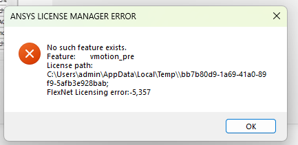

      On upgrading from Ansys 2024 R2 to 2025 R1 since a few months back, I'm getting this license error on opening Ansys Motion.

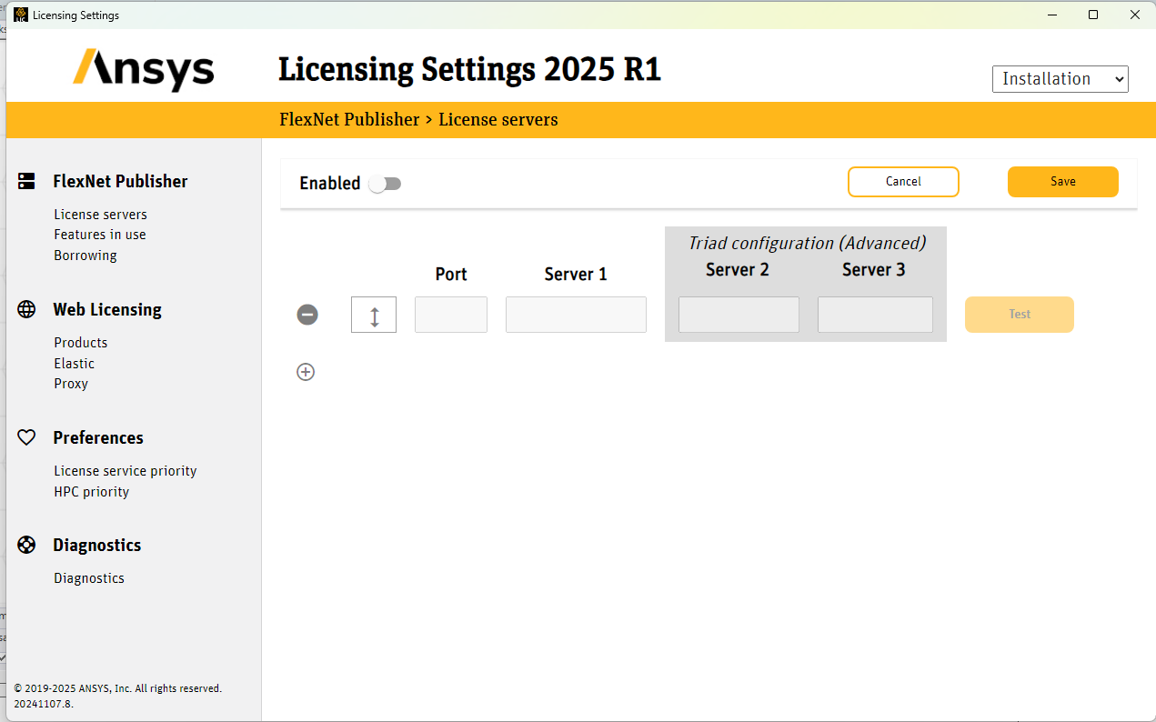

      This is the Licensing utility screenshot:

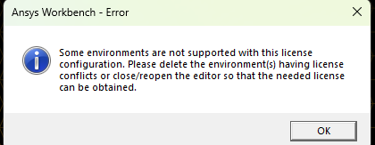

      Moreover, on trying to access Motion from inside Mechanical (from Add study), it is again giving license error:
      What to do?
      (I have tried reinstalling after deleting the C:\Program Files\Ansys folder itself.)

      I checked internally Ansys Motion isn't/ won't be included in v2025R1.
