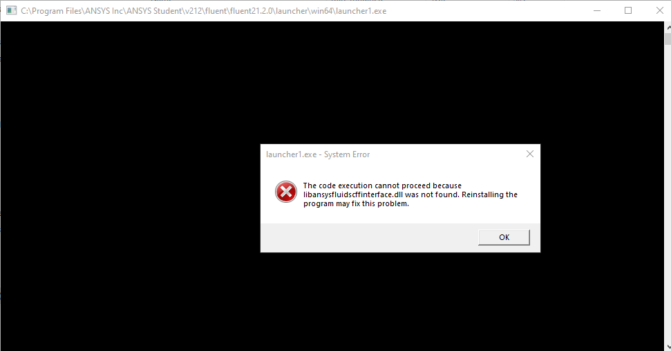

SubscriberThis error seems to be usual. I've already searched everywhere and can't reach a solution.

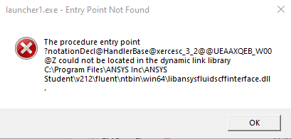

When installing application I've faced a problem related to the prerequisites (failed to install). I've installed one by one manually but the Ansys app wouldn't load. I've managed to change some .dll files, following a procedure find on the internet and everything went well with static structural.

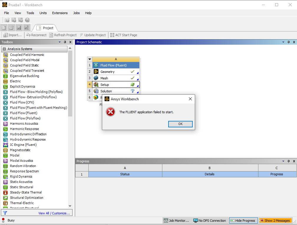

But now, starting a Fluent project, I got the error: Fluent application failed to start.
I've already re-installed Ansys, turned off Firewall, re-installed prerequisites as administrator, tried to run Fluent standalone, but without success.
Can someone point me a direction to solve this?
Thanks in advance.

October 11, 2021 at 3:31 pmOctober 11, 2021 at 3:41 pmGeorge Karnos
Ansys Employeecheck the size of the downloaded installation file to verify that it is the same as on the download site.
That dll file should exist in 3 places:
C:\Program Files\ANSYS Inc\ANSYS Student\v212\fluent\ntbin\win64
C:\Program Files\ANSYS Inc\ANSYS Student\v212\commonfiles\fluids\lib-hdf18\winx64
C:\Program Files\ANSYS Inc\ANSYS Student\v212\commonfiles\fluids\lib\winx64
If it does not, I would uninstall and reinstall the software by right-clicking on setup.exe and choosing run as administrator

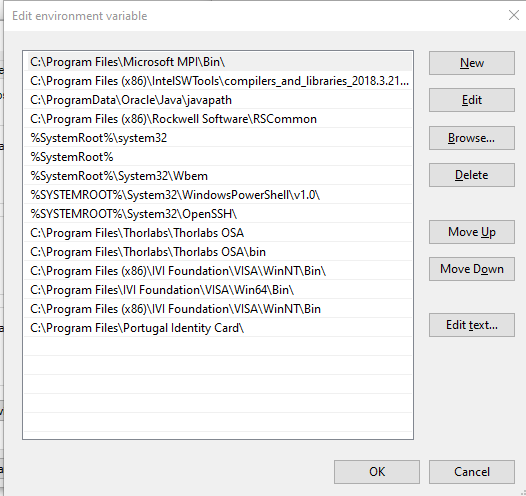

October 12, 2021 at 12:48 pmGeorge Karnos

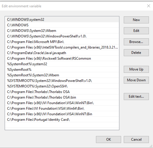

Ansys EmployeeI would try changing your PATH environment variable so that it starts with:
C:\WINDOWS\system32;C:\WINDOWS;C:\WINDOWS\System32\Wbem;C:\WINDOWS\System32\WindowsPowerShell\v1.0\
Meaning, I would cut the following and paste it at the end of the PATH variable value:
C:\Program Files\Microsoft MPI\Bin\;C:\Program Files (x86)\IntelSWTools\compilers_and_libraries_2018.3.210\windows\mpi\intel64\bin;C:\ProgramData\Oracle\Java\javapath;C:\Program Files (x86)\Rockwell Software\RSCommon;

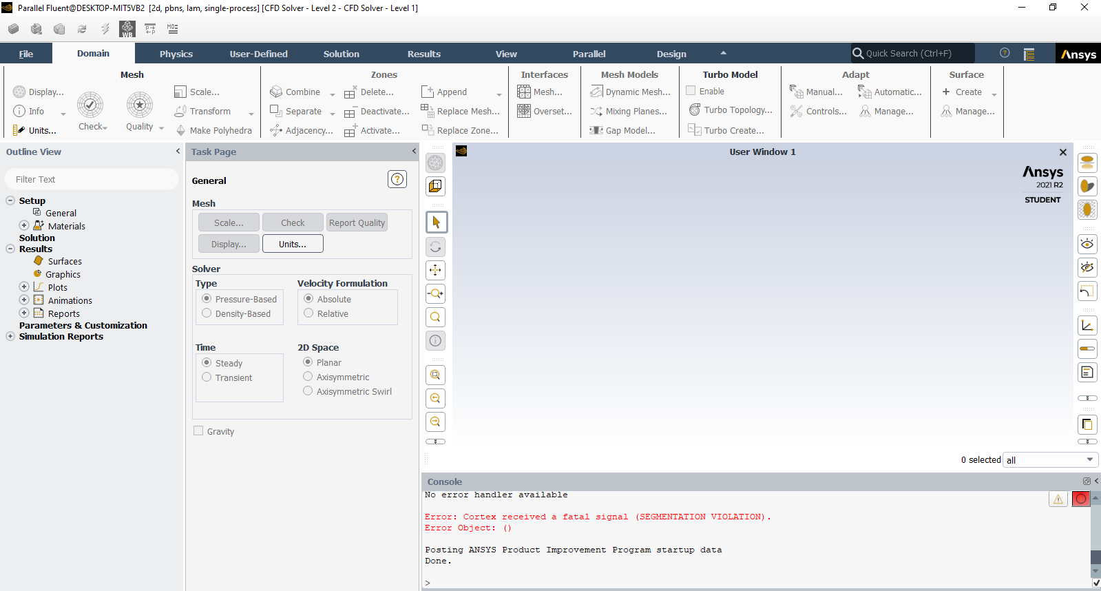

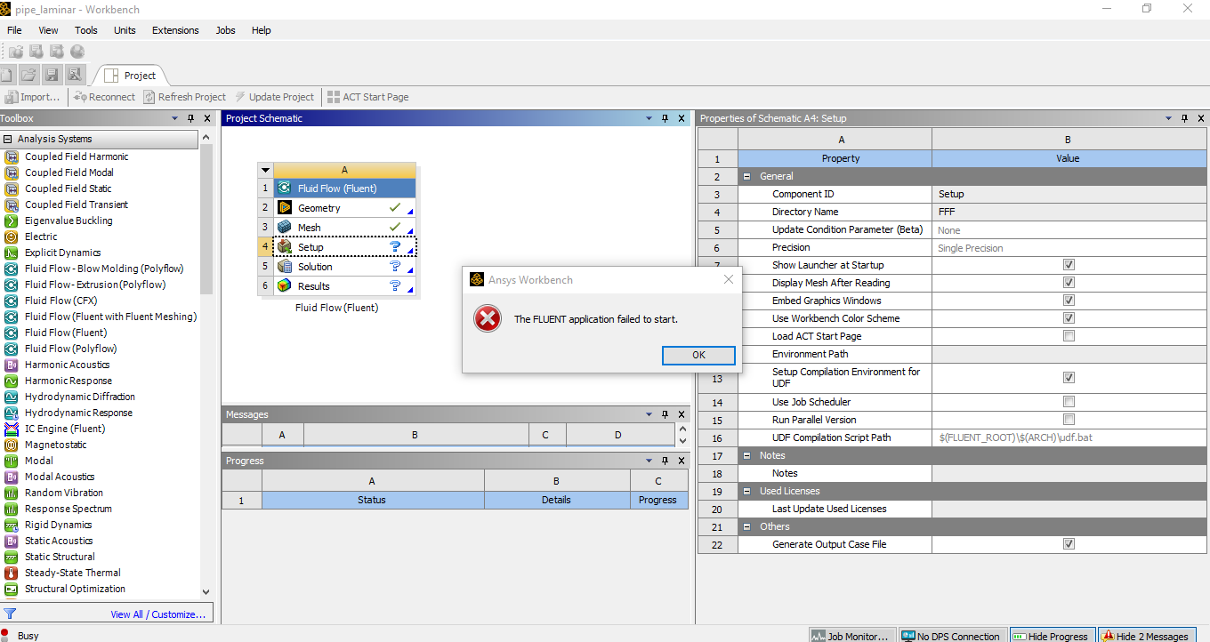

SubscriberHello!
I am having a similar issue, when I open Fluent from workbench I also got the error: Fluent application failed to start.
I've also already re-installed Ansys, turned off Firewall, re-installed prerequisites as administrator without success.
However, when I open the Fluent standalone it opens perfectly
When reviewing the fluent console, notice that the following error is shown:
"Error: Cortex received a fatal signal (SEGMENTATION VIOLATION). Error Object: ()"
Would someone please point me a direction to solve this?
Thanks in advance.

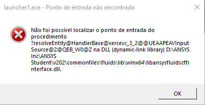

October 20, 2021 at 8:05 pmOctober 21, 2021 at 9:15 amP_e_a_R
Hi Andr├®
Unfortunately I didn't reach the solution for the problem.
October 21, 2021 at 12:36 pmOctober 21, 2021 at 1:21 pmGeorge Karnos

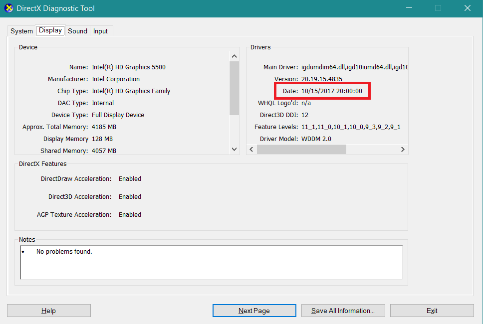

Ansys Employeedll errors of this nature are very difficult to troubleshoot.
The issues could be due to dlls of an older version on the Windows\System32 directory or not having full administrator privileges when installing(Right-click ->run as administrator)
Microsoft has a tool that may help see where the issue is. It is called : procmon
October 22, 2021 at 8:52 amP_e_a_R
SubscriberThanks for your effort in trying to help the situation.
The driver is recent (2019) and manufacturer seems not to provide a newer update. All the installation was done as admin.
For now I will just quit this subject and try to install another windows version in the future, expecting it will solve the problem.
