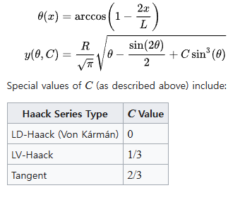

      I am posting because I have an inquiry related to Ansys SpaceClaim modeling.
      Among the modeling functions of Ansys SpaceClaim, there is an Equation function.
      Can this feature model the following?
      thank you

      Hello smjang
      I tried the equations that you provided, somehow, they were not working and gives this ''Failed to find cusps'' error.
      I am not sure if those are possible, I have raised a bug 805394 for similar issue from another customer, will let you know as I have more information from the developers on this.
