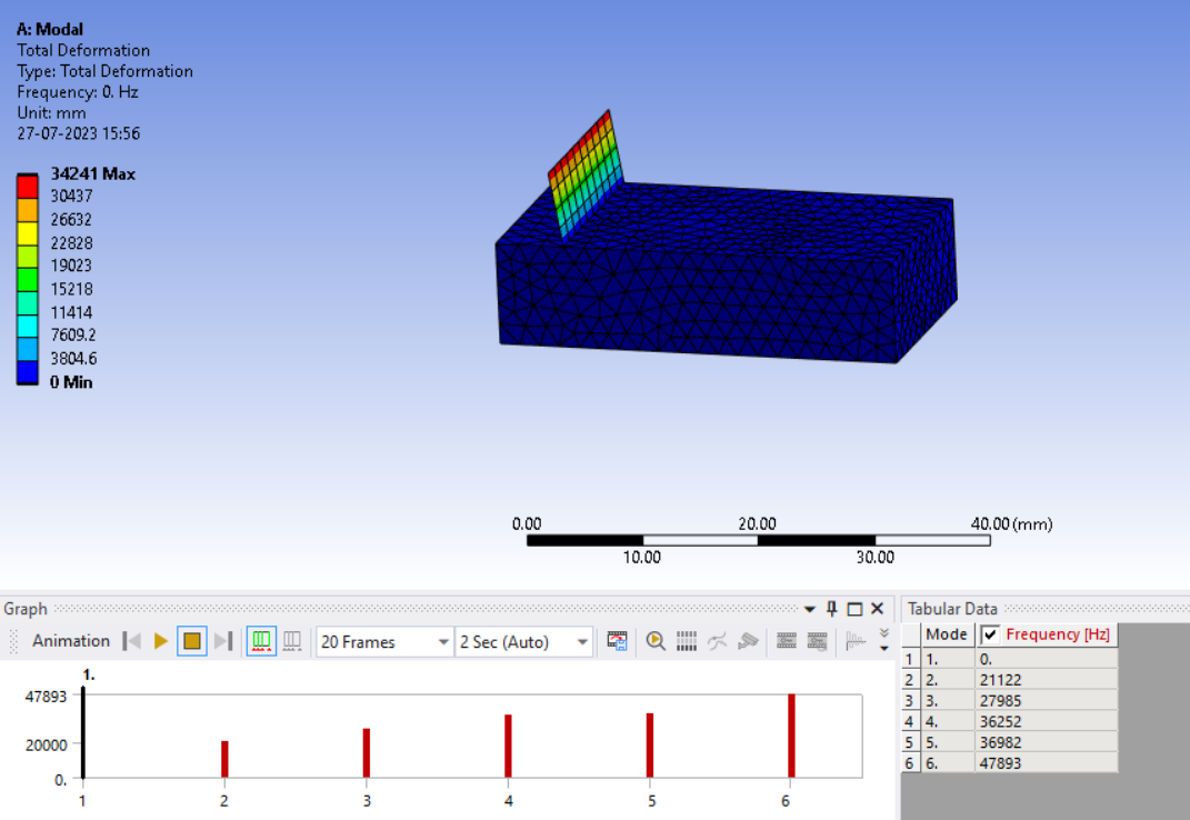

 I am doing modal analysis of a structure where two bodies are connected to each other it has one solid plate and other is shell surface ( midsurface) which is connected to this in surface- edge contact, for this i am using share topology option in spaceclaim, but when i am running this in Ansys Mechanical this body showing near to zero frequency for first one that mean shell surface is not connected to other solid body, if use bonded contact then it is moving with whole structure and not showing any zero frequency. Fixed boundary conditions is already there so there should not be any rigid body motions.

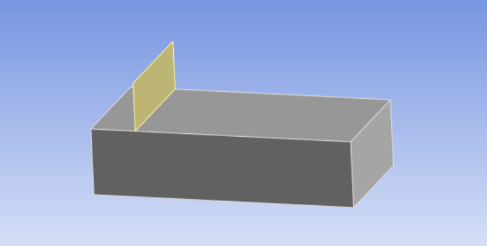

The model is shown in below fig the solid bosy has two holes which has fixed boundary conditions applied.
Below figure shows the results with shared topology options, here we can see that the first frequency is zero and others are non-zero this is what i wanted to know why is this happening i am missing any settings?

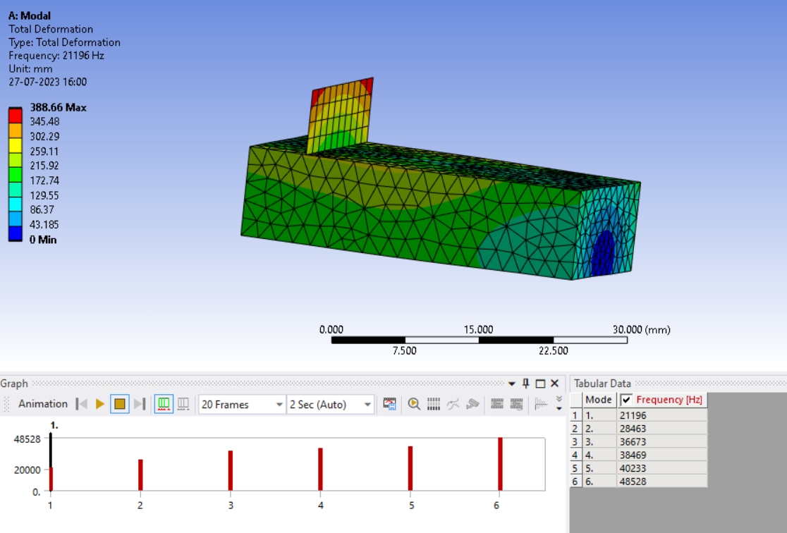

Belwo are the results when i am using bonded contact that too when choosing formulation as MPC the first zero frequency is now not coming, As i cant use this in my actual model because i have so many fins on the solid body., please help

You can't use Shared Topology to connect the edge of a surface to a solid body. It creates a hinge in Mechanical as you have found.
You can use Shared Topology to connect a set of fins to a base surface body. That will correctly support the fins.
You can have a solid body in SpaceClaim as well as the base surface body. Hide the solid body when you click the Share button on the base surface and the fins. Then in Mechanical, you can do one bonded contact between the solid body and the base surface body.

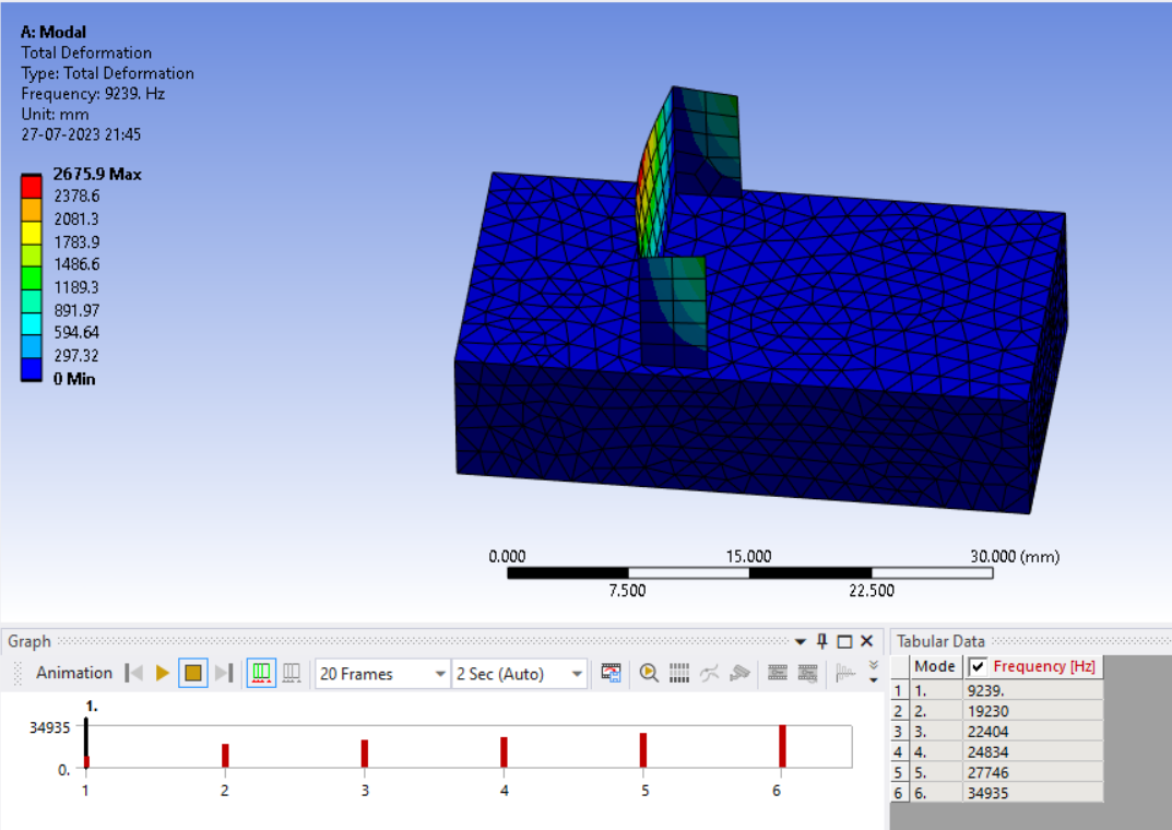

While working on this types of problems i came across one interesting thing is that if shell surface is like C section as shown in below fig the the share topology option is working , i have attached the result here see there is no zero frequency.

SubscriberThe C section behaves the same as the flat fin but instead of 1 line that is a hinge, you have 3 lines that are hinges. The long line is still hinged to the block, but because of the short flanges in the C section, the whole section does not tip over with a zero frequency mode.

However, if you put the base surface and fin in one component and hide the block, you can use Shared Topology on the surfaces. Then in Mechanical, use Bonded Contact to connect the base surface to the block, you get a fin that stands up and a non-zero first mode.
