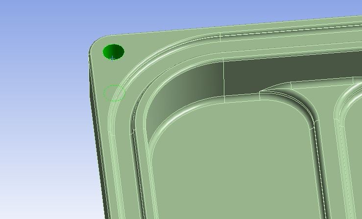

SubscriberHi All,
So i have to add a 4000N force over the selected surface. I'm currently able to identify the surface and select the magnitude, but I have problems with the force direction. The code I wrote is the following:
April 28, 2022 at 10:50 amErKo
Ansys EmployeeHi
To use these directions just use the record option inside the scripting console, and see how it works.
For instance to define it in the x direction would be:
threadForce = ExtAPI.DataModel.Project.Model.Analyses[0].AddForce
threadForce_scoping = ExtAPI.SelectionManager.CreateSelectionInfo(SelectionTypeEnum.GeometryEntities)
threadForce_scoping.Ids = [4]
threadForce.DefineBy = LoadDefineBy.Components
threadForce.Location = threadForce_scoping
threadForce.XComponent.Output.DiscreteValues=[Quantity(400,"N")]
