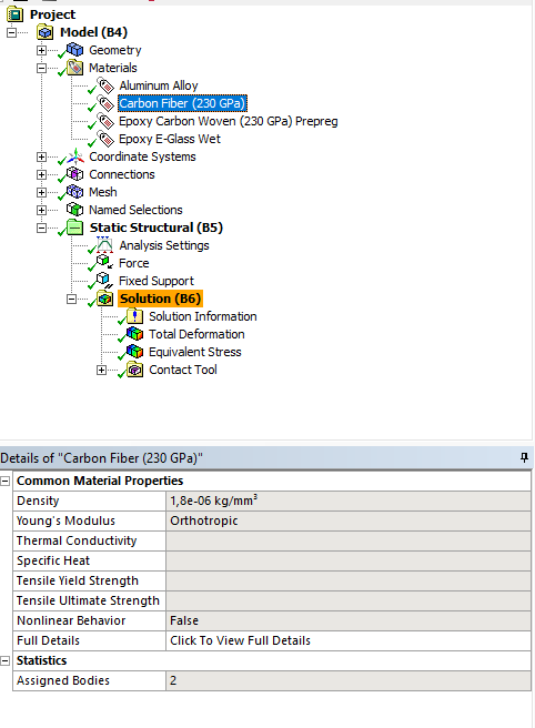

      I can not seen materials characteristic. I need tensile yield strenght. Because when I run the system for safety factor or strain , I seen warning and error. The program can not found tensile yield strenght. Could you help me for this trouble ?

      Hi,can you edit the value and enter manually inputs? Then you can get data from ref papers or technical datasheets.
      If you can look into the Material Data for Simulation: https://www.ansys.com/en-gb/products/materials/materials-data-for-simulation
      Or if you have access to Ansys Granta Products (EduPack for teaching or MI / Selector for research/industry). Here a screenshot from Selector.
