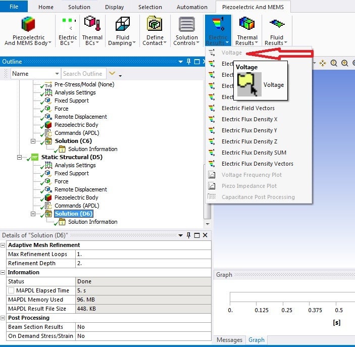

    • Syafiq1986
      I have problem to get output voltage from ansys workbench.
      Currently, I am use piezo n mems extension to set the piezoelectric data.
      Unfortunately, I cannot be determine output voltage at static structural and the icon is blanked symbol.
      Please refer figure.
      Thanks for the feedback.
