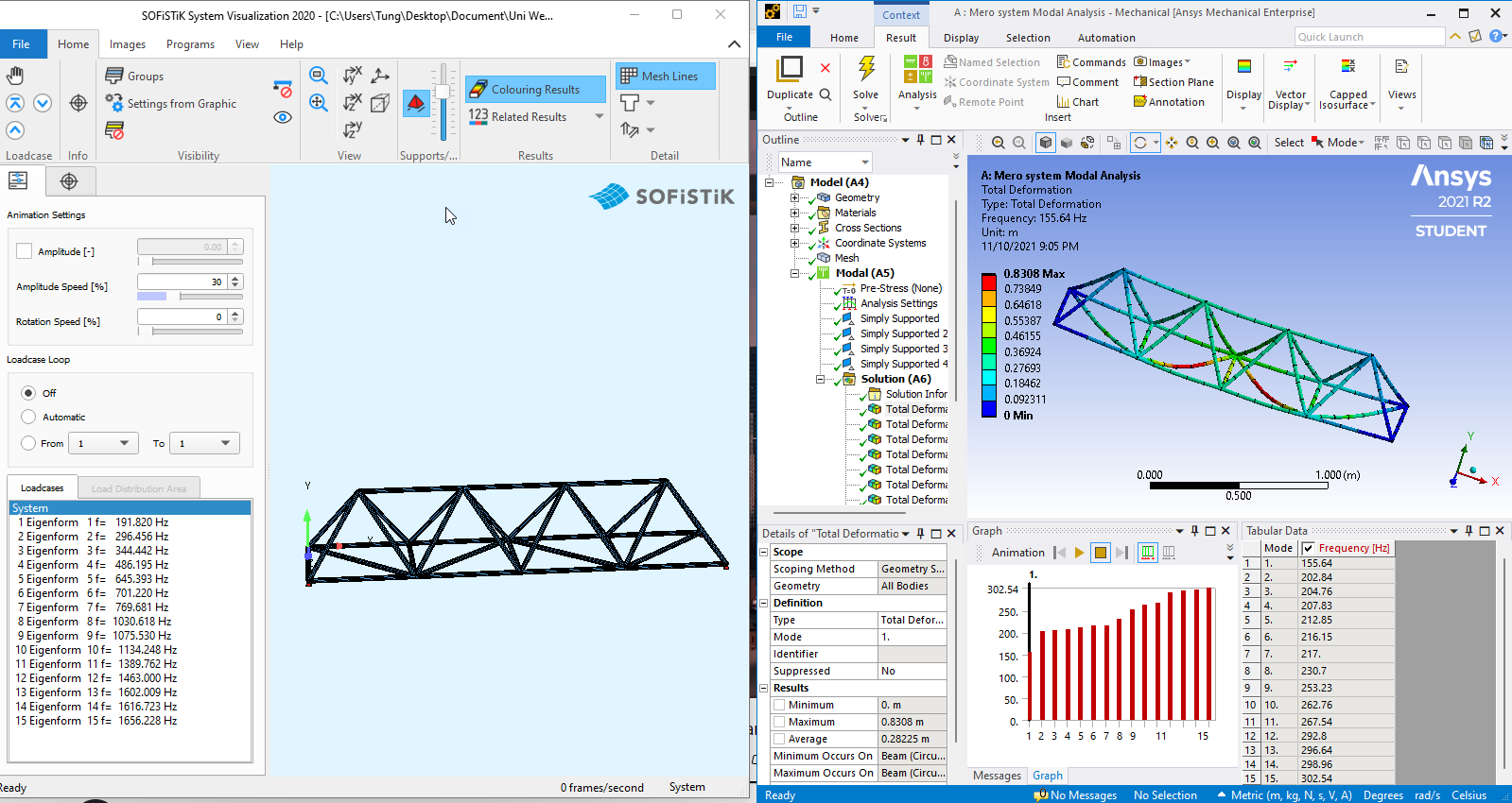

      Hi everyone, i have been working on a space truss model (Mero space truss system) and tried to perform modal analysis. However the first frequency also the whole frequency range from Ansys doesn't match with my other FE software models (Sofistik and SAP2000): While in sofistik my first frequency is 191.82 Hz and for the first 15 modes it ranges up to 1656 Hz, in Ansys my first frequency is only 155.64 Hz and only ranges up to 302Hz for the first 15 modes.
      I tried to cross checked the two models from the material with correct module of elastic, also the cross sections, dimensions, etc, structural self-weight, support reactions, ... All of these are the same however the modal analysis gave me a different results as mentioned. I checked with every single mode and found out that in my Ansys model there is only local modes and when i changed the boundary condition from simply supported to fixed, the frequency range in Ansys doesn't change too much. This make me think that my beam elements have no sufficient stiffness. I don't know this assumption is correct or not and I can't find a way to fix my model.
      Can anyone give me some hints where is my problem?

    • hesamkeshavarzz
      Its because the difference between the modeling of the connections between the trusses in the two softwares. although ANSYS has more capability to model a wide range of connections, I think the civil eng softwares like SAP and ETABS has a better equations to medel the connection in the structures.

      Thank you ! What i did in Ansys was: in the geometry SC, in Workbench tab, i pressed share the joints.
      So from what i understand now is that this is the default connection type between truss member and the definition of these connections is different from other FE software. Con you explain a bit more about wide range of connections in Ansys? How can I adjust the fixity of these connections so that it could match the result in other FE software?

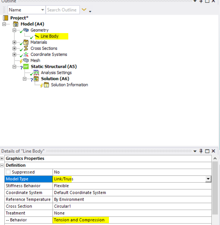

    • ErKo
      HI @lbtung248
      You are using truss elements in SOfistik, but beam elements in Ansys -
      So mesh with only one element per structural member (so set you element size to 10 m or something very large to get one element per member), and the choose link/truss type (which is a truss element) under the line body definition and model type details/
      See here on how to do that:
      All the best
      Erik
    • ErKo
      Good Morning - not sure you saw the previous post, but if you do the below change then you should get very similar results I believe (assuming you have the same material properties, dimensions, cross sections, boundary conditions, in Sofistik and Ansys):
      HI @lbtung248
      See here on how to do that (set it to link/truss instead of beam):
      All the best
      Erik
    • lbtung248
      Thank you very much for the help! It worked!
