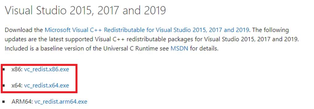

2. Please try uninstalling these:
Microsoft Visual C++ 2019 / x86 and x64
Microsoft Visual C++ 2017 / x86 and x64
Download and install the Microsoft Visual C++ Redistributable for Visual Studio 2015, 2017 and 2019, both x86 and x64.
