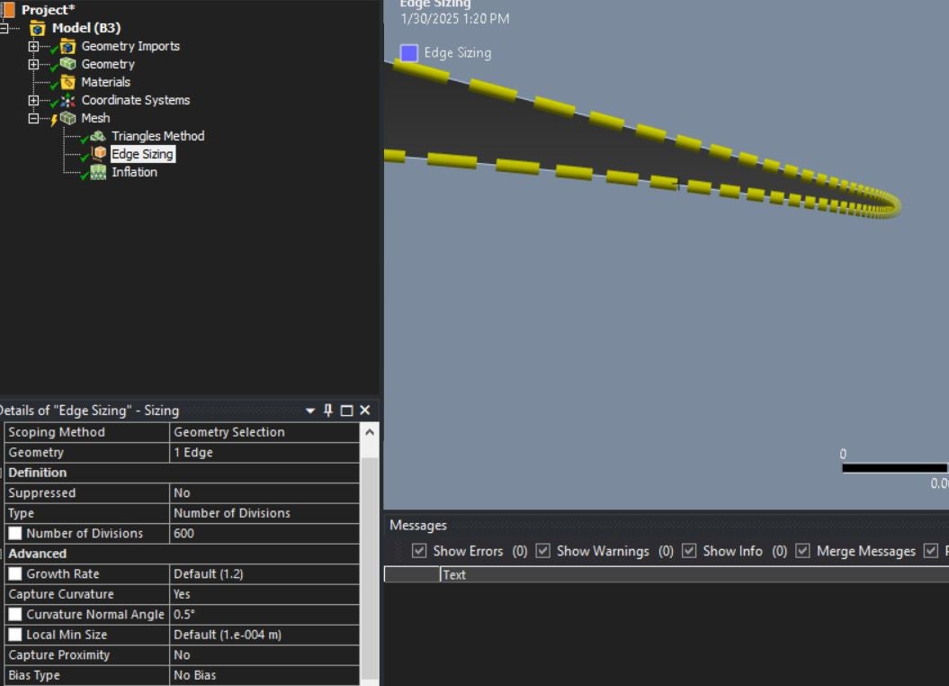

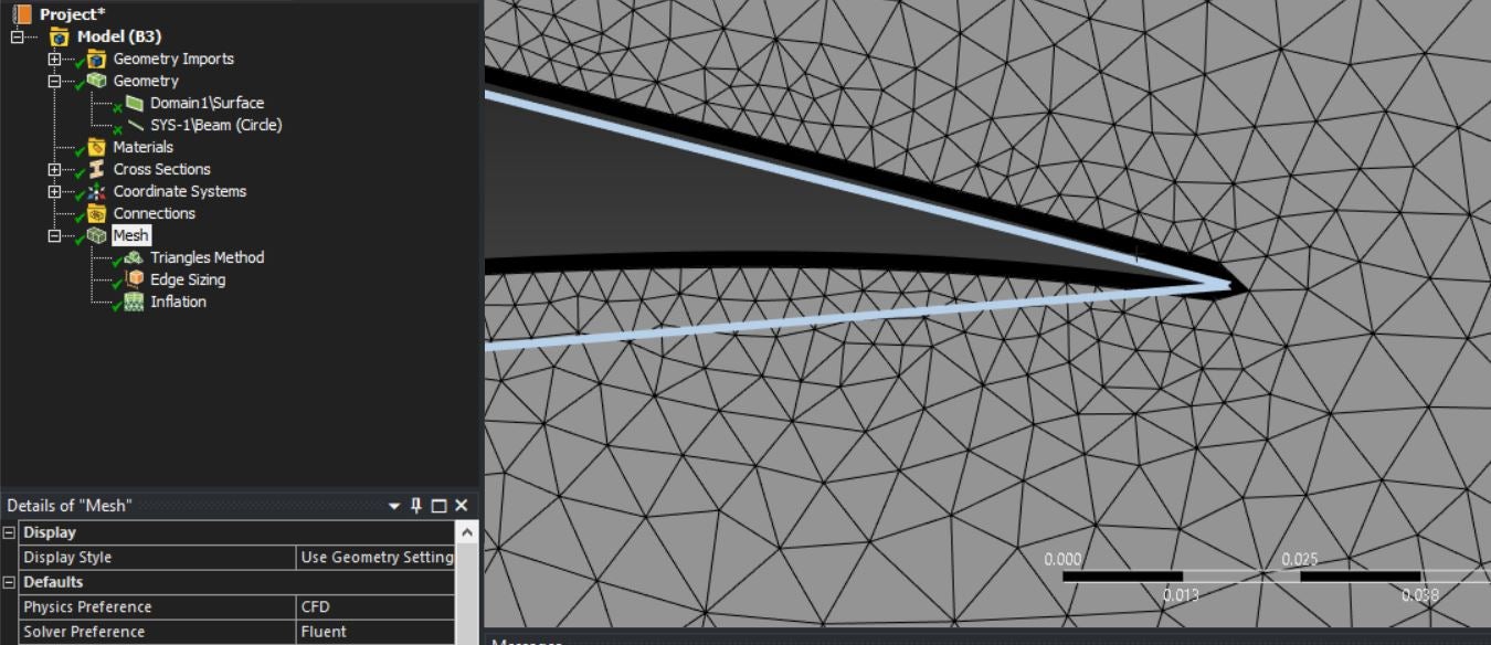

      I'm doing an optimization problem over a 2D airfoil. Ansys Meshing cannot capture curvature over the blade (especially at the trailing edge) when the geometry is imported from SpaceClaim. I've also tried to convert the airfoil curve to a beam but the problem persists. I've attached the images in the following:
      Before converting the airfoil to a beam:
      After converting:

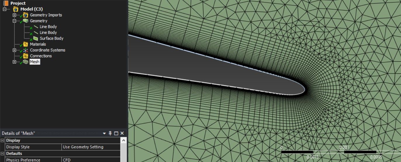

      Note that when the geometry is imported from DesignModeler with the same settings, there is no problem at all. However, I've no idea about DM scripting, and scripting in SpaceClaim is more friendly.
      The generated mesh from DM's geometry:
      Why is applying edge sizing in 2D problematic? is there any way?

      What edge sizing did you set? Size functions?
      • e.bakhtyary

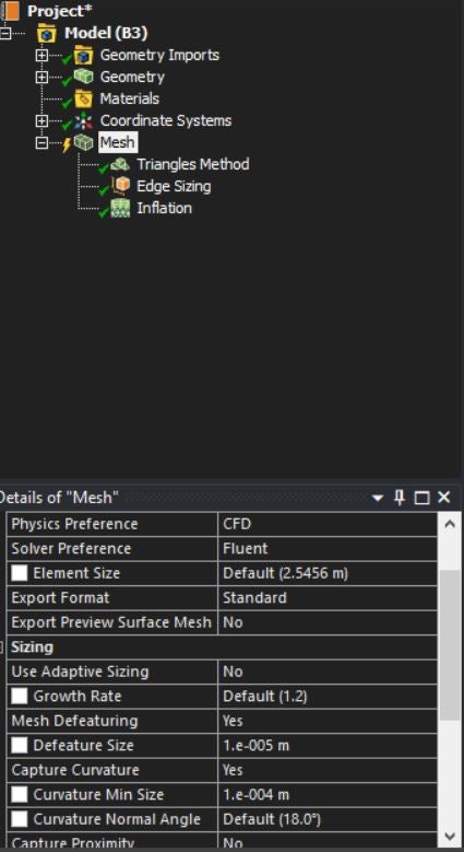

        No, I didn't use any size function. I added a sizing and then clicked on the airfoil curve. Then, I set the settings. I also defined the minimum size for the curvature as 0.0001 for both global mesh settings and the edge sizing curvature setting (also, defeature size = 1e-5):
        Global mesh setup:
        Thanks for your help in advance.
      Drop the surface curvature angle to something lower than 18 degrees, otherwise you may be creating a conflict in the settings. I use edge sizing very rarely, most meshes are built with size functions only.

        I've just done that (curvature normal angle = 0.5 deg for both settings), and nothing changes. I don't know what SpaceClaim does to the geometry, that DM doesn't, which creates this problem!
        By size functions, do you mean adaptive sizing? Since, I cannot find any function settings in the mesh configuration tab.
      Curvature size function. Why would you convert an airfoil to a beam? Can you double check you have a curve there and it's not been faceted to very short straight line.
    • e.bakhtyary
      Bcz the SpaceClaim omits the airfoil curve when sending the geometry to meshing bloc, but DM keep the line "parts", so I thought if I can keep the airoil as a line body (which is possible through converting it into a beam) , it may result in a similar mesh to that from DM (image presented at the above).

      A beam means something for Mechanical so don't use that. DM has a line body, but again that shouldn't do anything in Meshing, and shouldn't connect to the surface: Meshing for CFD works on the surface only.
