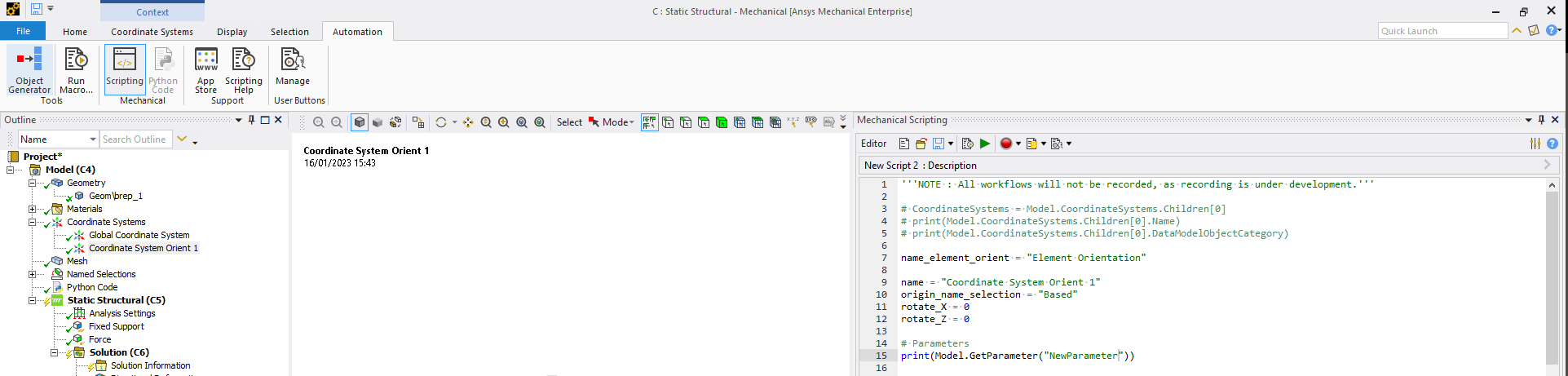

SubscriberRegarding Ansys Mechanical, i was wondering if is possible to create an input parameter and call it back in the Ansys Mechanical Python scripting

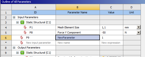

Let say, create a new input paramter like in the following image,
How to call back this parameter in Python Scripting from Ansys Mechanical?
Model.GetParameter("NewParameter") is not working
How can I create a new Parameter via scripting?

Forum ModeratorSo you want to create the input parameter in the workbench page from the Mechanical level script, and later use it in Mechanical level script?
-Aniket
July 25, 2023 at 1:15 pm
Dmitry Chechenev
SubscriberDear Aniket,
I think flahuerta wants to read WB Parameters (Parameter Set) from Mechanical using scripting. Looks like GetParameter method is not designed for that. Is there any other way parameters from WB can be read in Mechanical scripting? Thanks!
