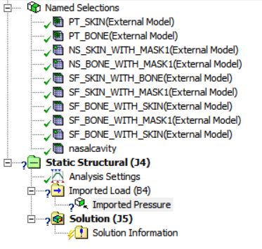

SubscriberI have a problem in ansys mechanical regarding named selection. I have an imported pressure from fluent and the model in mechanical has a predefined named selection in a software outside mechanical, however when I want to select the surface of imported pressure to the named selection it doesn't show predefined named selection.

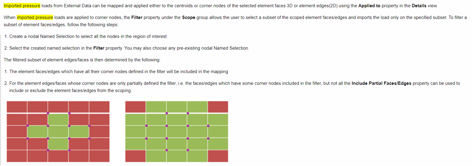

Ansys EmployeeThe imported pressure doesn't take nodal named selection but the filter option does. You can select a larger face area using geometry selection and then under the filter option select the nodal named selection. This way the imported pressure would only be applied to the nodal selection. Check the image below. I have scoped the imported pressure to all faces of the cuboid and then selected a subset using filter option scoped to a nodal selection.

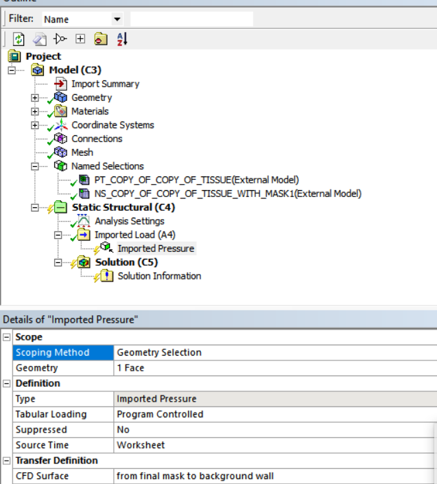

Ansys EmployeeHave you import the load using external data( https://www.youtube.com/watch?v=4D8fKjJ17lY)? Looks like you have directly linked fluent solution to static structural. You should ideally get that option if you use external data.
Regards Ishan.

SubscriberThanks for your support, I have tried this option but no solution, I will try to split the geometry
