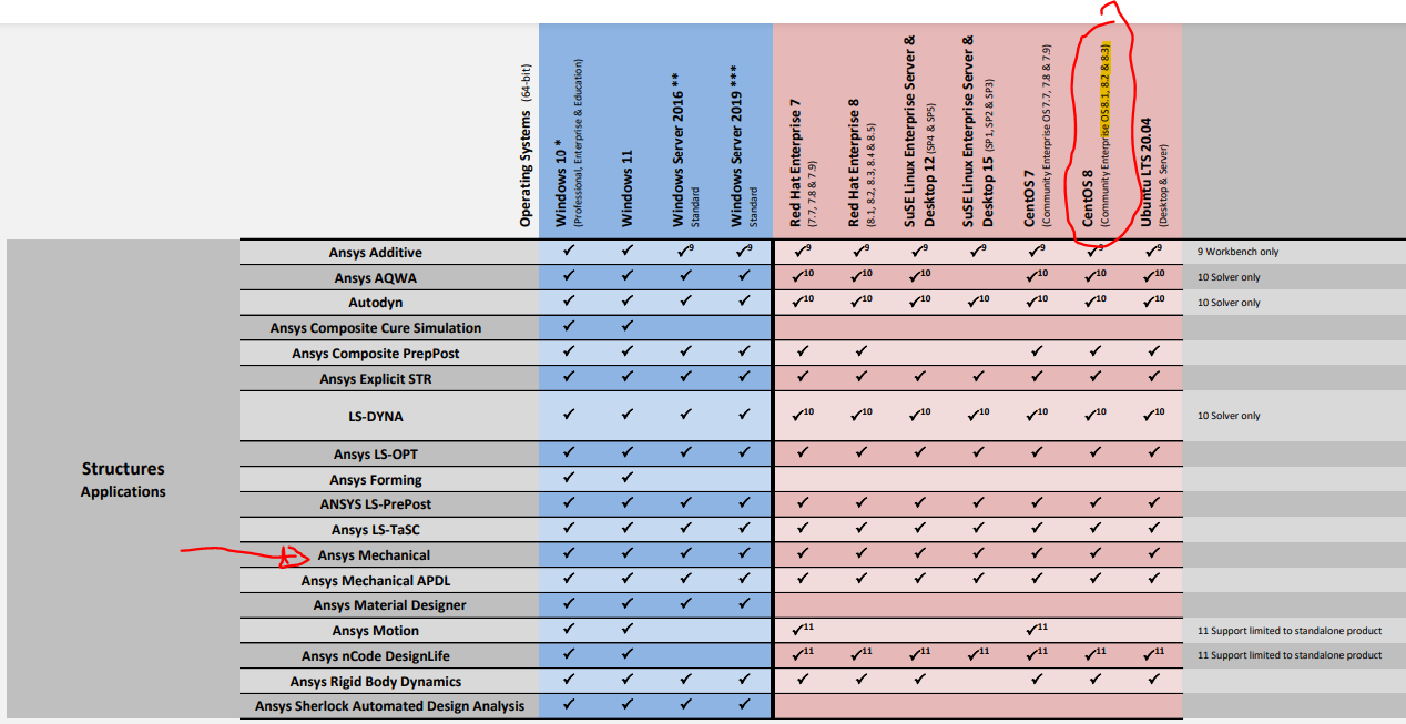

      Which version of Ansys are you using? Note that the current version of Ansys (2022R2) does not support Rocky Linux (any versions) nor Centos 8.5. The supported Centos OS are  8.1, 8.2, and 8.3:
      https://www.ansys.com/content/dam/it-solutions/platform-support/ansys-2022r2-platform-support-by-application-product.pdf
      This means that Ansys 2022R2 has not been QA tested on Rocky Linux nor Centos8.5 which can lead to issues.
      Let me check with a colleague to see if we can troubleshoot further.

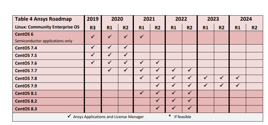

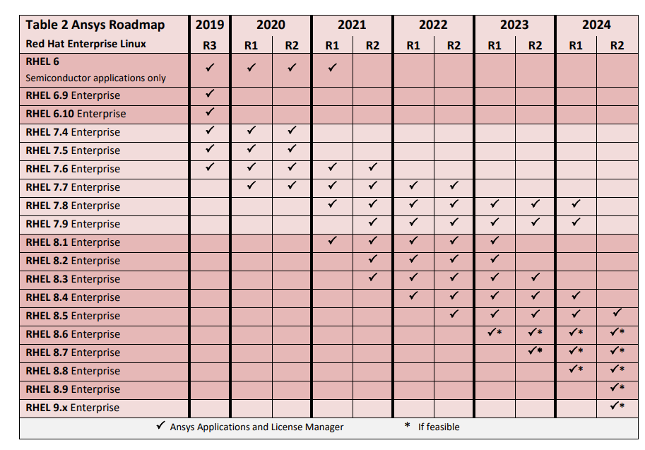

      It seems like the plan is to reduce support of Centos and expand on Red Hat and Suse:
      https://www.ansys.com/content/dam/it-solutions/platform-support/previous-releases/ansys-platform-support-strategy-plans-august-2022.pdf
      If you can run with commands, there might be a way to modify one of the files in the Ansys installation directory to make this work.
      Reno.
    • Martin Cuma
      I see, thanks for sending the roadmap. I see that RHEL 8.5 is supported, so, likely that's why I was able to install after hacking in the "rocky" in the install script. RHEL and Rocky Linux should be binary compatible. Perhaps as a feedback for your roadmap discussions - it may be good to include Rocky Linux in your support in lieu of CentOS as most of the HPC community that used CentOS is moving to Rocky. It's cost prohibitive for us to license RHEL at this point (we used to run RHEL but moved to CentOS after they started charging per node license fees).

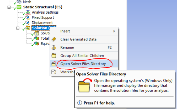

      Before you do that, after clicking "Solve" in the Mechanical interface and getting the error message, if you right click on the Solution branch and choose "Open Solver Files Directory", do you see anything in that directory that could help us troubleshoot the problem? There might be a file with a meaningful error message.
      Reno.
    • Martin Cuma
      Hi Reno,
      thanks for your help. I tried to click the "Open Solver Files Directory", but, that option only works in Windows, there's no response in Linux (and the User's Guide says that too). I do agree that it would be very helpful to know where are the solver files, I can't find them. I have spent some time looking around for them without succes. If you or some of your colleagues has rough idea where they would be, it'd be very helpful. Perhaps this is already documented somewhere, I just can't find it?
