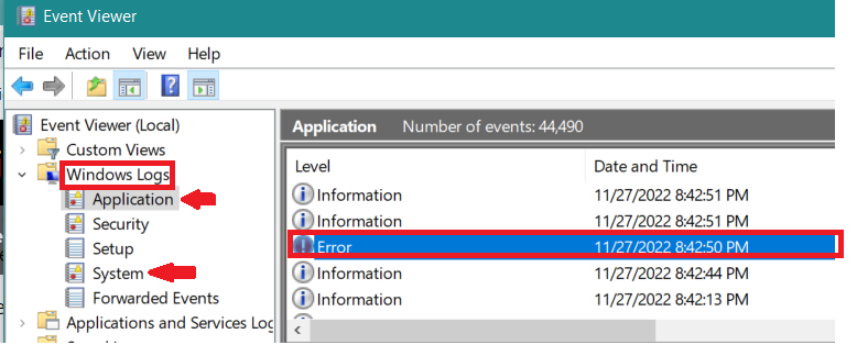

      Check the Windows Event Viewer for any errors when the crash happens.

      I've never used Windows Event Viewer before, what should I look for here? There are no events or logs that from what I see that relate to Ansys, as far as the naming is concerned at least.

      As for the Event Viewer, Open the Windows logs and check Application and System for errors:

      After checking my Event Viewer I get the following error:
      Faulting application name: AnsysWBU.exe, version: 22.2021.334.1, time stamp: 0x61a66590
      Faulting module name: ntdll.dll, version: 10.0.22000.918, time stamp: 0x57b668f2
      Exception code: 0xc0000374
      Fault offset: 0x000000000010c509
      Faulting process ID: 0x3e74
      Faulting application start time: 0x01d904cf343ae647
      Faulting application path: D:\01_Programs\01_CAD+Simulations\Ansys\ANSYS Inc\v221\aisol\bin\winx64\AnsysWBU.exe
      Faulting module path: C:\WINDOWS\SYSTEM32\ntdll.dll
