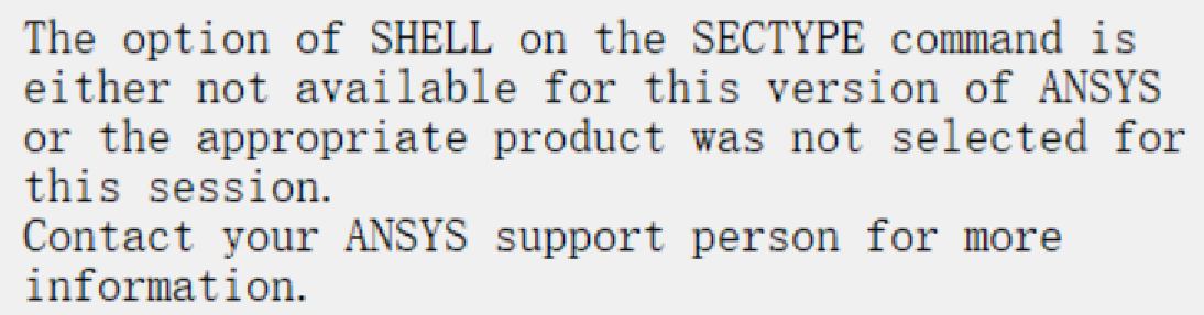

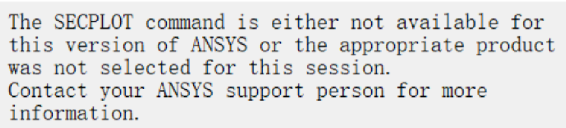

      Hi
      Recently, I have been using Shell 163 to build a multi angle model in ANSYS apdl 18.0. However, when using the command stream, I found that commands such as sectype, secdata, and secplot cannot be used properly. I would like to know how to implement these commands in apdl 18.0.
      Zhang
    • Govindan Nagappan
      You will need Enterprise license to use legacy elements. Check which license are you using
    • mrife
      Please see the MAPDL 18 help on the SECTION command - it is not supported when using the Ansys LS-Dyna license...which makes sense as shell163 did not use sections for its defintion, rather real constants.
