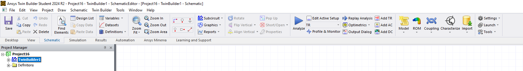

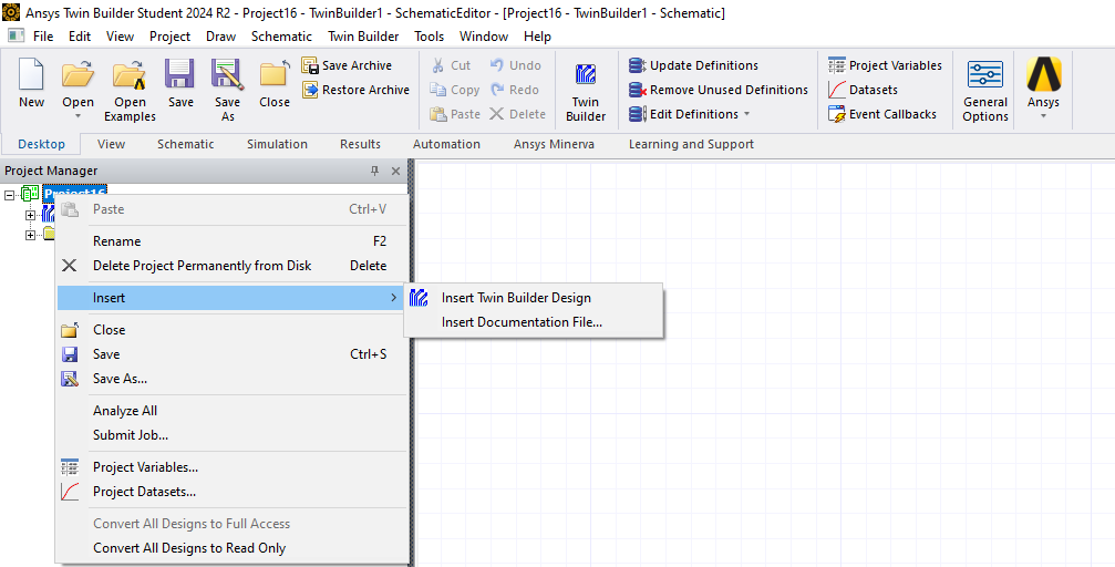

      I have installed the student version for ANSYS Maxwell and TwinBuilder. On the first day of launching ANSYS Maxwell, it works perfectly. Since then I have opened Ansys Electronics Desktop Student 2024 R2 and it only launches TwinBuilder. I cannot nor have the option to open any of the other software I downloaded. What should I do?

      Please follow the steps below to open all designs in AEDT:
      Go to Desktop tab and in the ribbon area select general options. In Options dialog window expand General and click desktop Configuration.
      Under Desktop Configuration, change Set targeted configuration to all.
