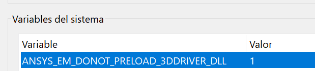

Forum ModeratorA recent Windows update, Microsoft update KB4571756, results in one of the Windows functions (DescribePixelFormat) crashing on startup. nnFor versions 2018.0 and newer, please try setting the environment variable ANSYS_EM_DONOT_PRELOAD_3DDRIVER_DLL=1 to get around the problem.nnFor guidance on creating an Environment Variable please refer to this link. You need to create a NEW Variable.nhttps://www.computerhope.com/issues/ch000549.htmnNew Variable Name: ANSYS_EM_DONOT_PRELOAD_3DDRIVER_DLLnNew Variable Value: 1nnSeptember 17, 2020 at 3:39 amyoussefaly97

SubscriberFor those who has tried the above but no luck yet, please try the followings:nOpen up Command Prompt -> Run as AdministratornSend two commands to set the environment variablessetx ANSYS_EM_DONOT_PRELOAD_3DDRIVER_DLL 1nsetx ANSYS_EM_DONOT_PRELOAD_3DDRIVER_DLL 1 /mnnThis should work.nnTimnOctober 19, 2020 at 11:23 amedaakar

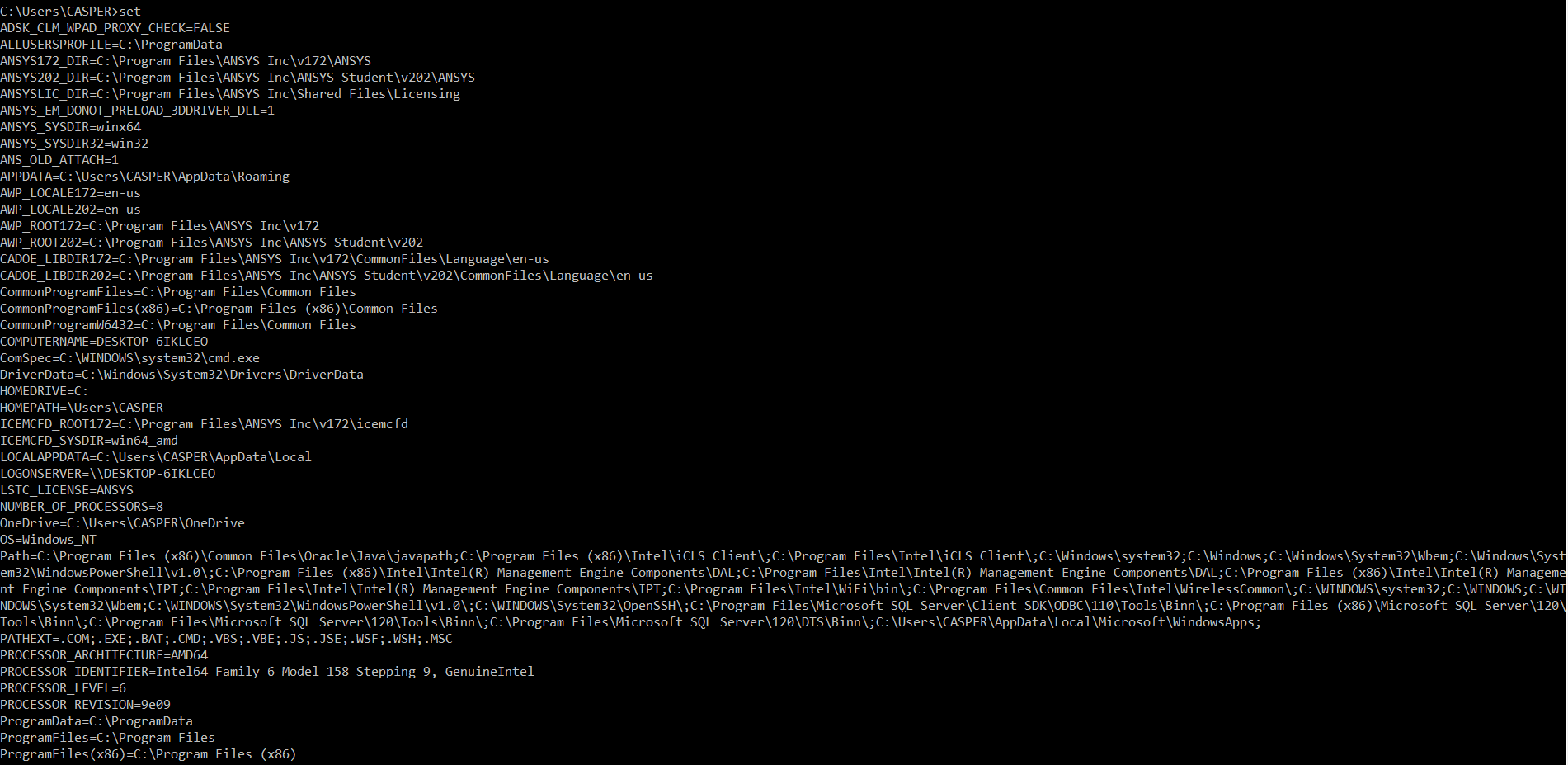

Subscriberyes I have set it as examining the environment variable. But it didn't work.nOctober 19, 2020 at 1:19 pmANSYS_MMadore
Forum ModeratorPlease run the set command from a Windows command prompt and send the full output. Omit the from the command.nnThanks,nMattnOctober 19, 2020 at 1:40 pmOctober 19, 2020 at 1:55 pmANSYS_MMadore

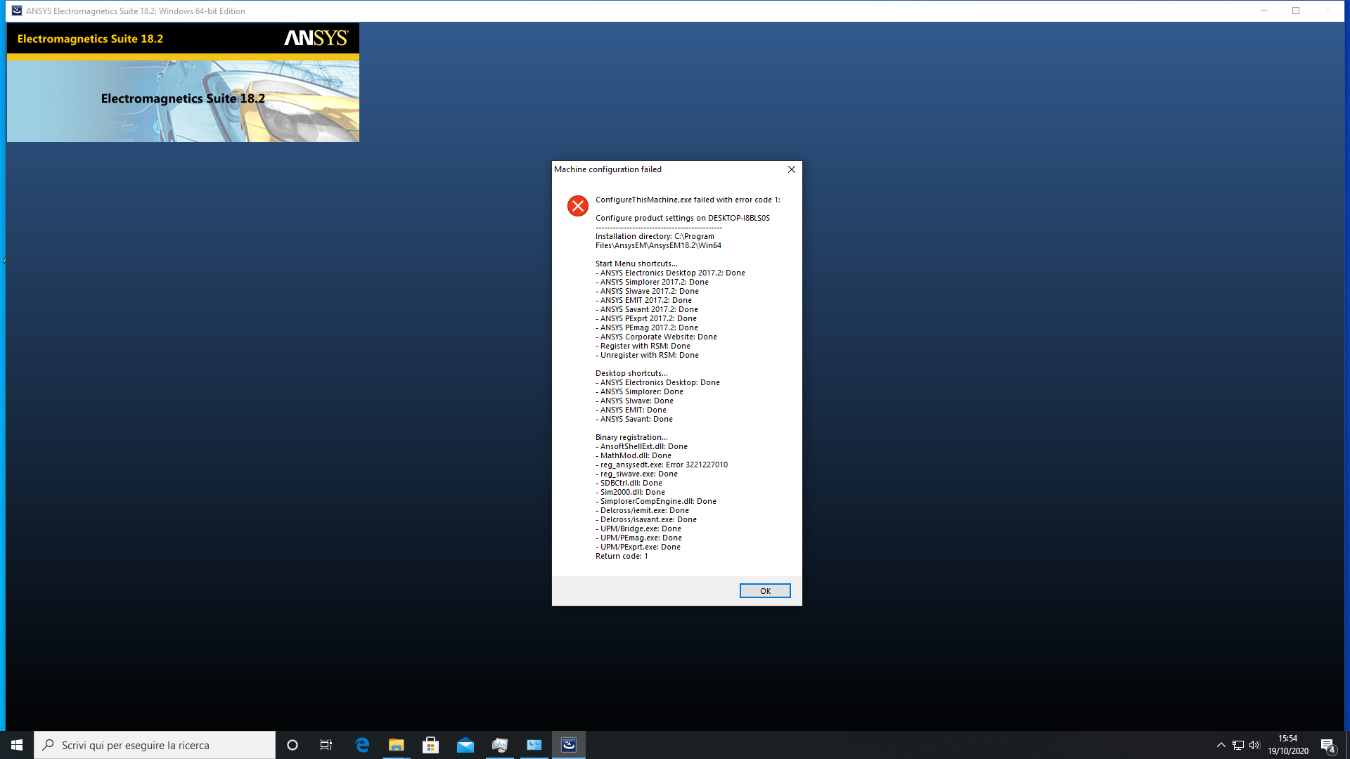

SubscriberHi, I'm Pierpaolo from Sicilsat Communications, I'm contacting you because I have on my workstation the same issue with error 3221227010 on reg_ansysedt.exe, running ConfigureThisMachine.exe. I have this problem running Ansys Electronics Desktop ( Ansys 2017.2).nI follow the instructions creating a new environment variable but it doesn't work. nCan you please help me ?.Thanks in advancen
n
October 19, 2020 at 4:35 pmANSYS_MMadore
Forum ModeratorThis fix is only supported with versions 2018.0 and newer. You will either need to uninstall the Windows Update or update to a new version of Ansys EM.nOctober 19, 2020 at 5:01 pmpierpaolosquadrito

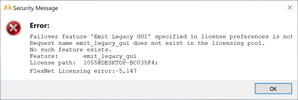

Subscriberthe problem is that i dont have on my Windows 10 Pro this KB4571756, but the error is the same. Do you have any other suggestions? Because i cant upgrade the current version because i need to pay for a new one license for upgrade I guess. nOctober 23, 2020 at 8:41 pmOctober 26, 2020 at 12:06 pmANSYS_MMadore

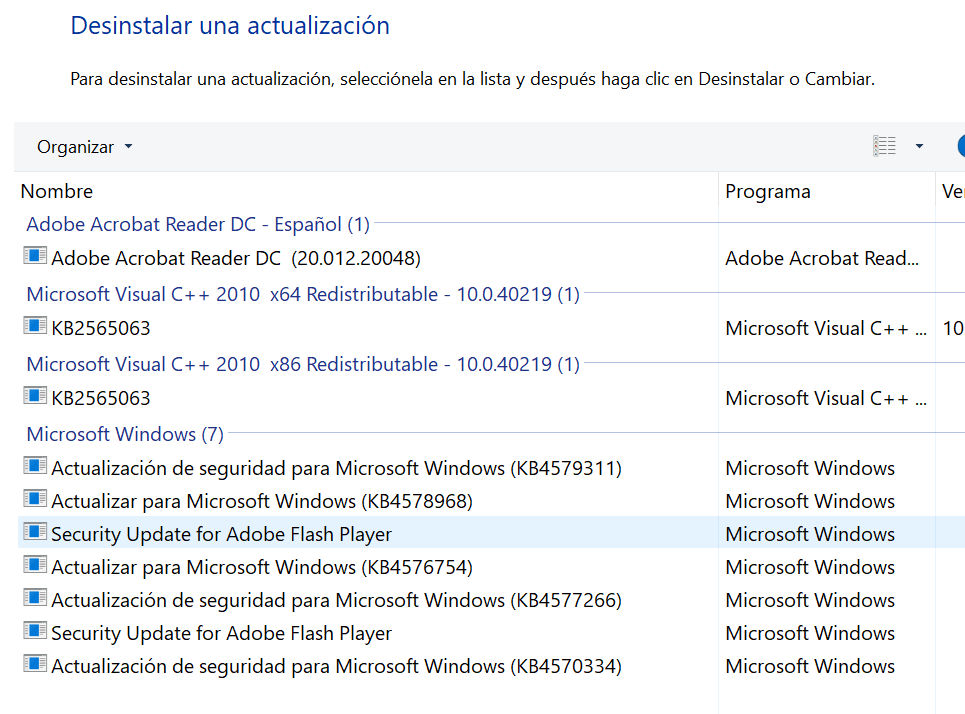

Forum ModeratorCould you please try removing KB4579311 as this seems to be potentially causing issues as well.nnRegarding the license error, that is normal as you likely do not have a license for the standalone Emit.nDecember 2, 2020 at 9:37 pmredant
SubscriberThe KB4579311 not causing issues. I found that the win 10 version should be not later than 19041.450. It easy to check by launch winver command in searchbox. nHere the list of problematic KBs:nKB4576478nKB4571756nSo, you should keep next KBs configuration in Microsoft Windows update:nKB4580419nKB4566782nKB4570334nKB4586781nKB4586864nSome KBs hides after another KBs. You should remove as much as possible KBs and hide the problematic KBs by wushowhide.diagcab, but more stable is to downgrade win 10 to 19041.450 build and do not update.nnAntoDecember 4, 2020 at 12:34 amDecember 4, 2020 at 7:06 amredant
SubscriberHello summerdumas,nThe worse way is to install win 10 build not later 19041.450 without automatic updates (just to google win 10 distributive in WWW). Because after that build the update that causing error are in win10 distributive and you cannot uninstall it. nIf the first install was windows 10 build early 19041.450 then just uninstall KBs while ANSYS start work. Note: Not every KBs have uninstall button. It easy to solve. After uninstall KB refresh the Installed Updates window. Can be appears a previous KB update (Hiding KB updates).nFor uninstall such KB you need:ngo to C:\Windows\servicing\Packages.nFind KB file like as Package_for_KB4586864~31bf3856ad364e35~amd64~~19041.621.1.0.mum Where KB4586864 is number of interested KB and extension should be .mumnNote that: The file should be start from Package_for_KB... like that. There packages with numbers it not need.nOpen this file in NotepadnFind the words permanence=permanent and change the word permanent on removable.nsave and refresh installed updates window.nThen you can uninstall this KBnFor reference to google words uninstall uninstallable windows updates or https://borncity.com/win/2016/10/21/windows-updates-fehlende-deinstallation-erzwingen/nBest Regards nAnton LukyanovnDecember 4, 2020 at 7:32 amredant
