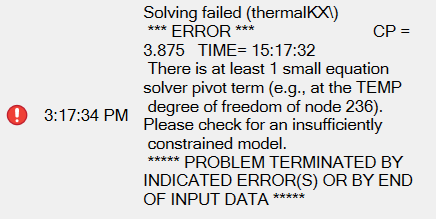

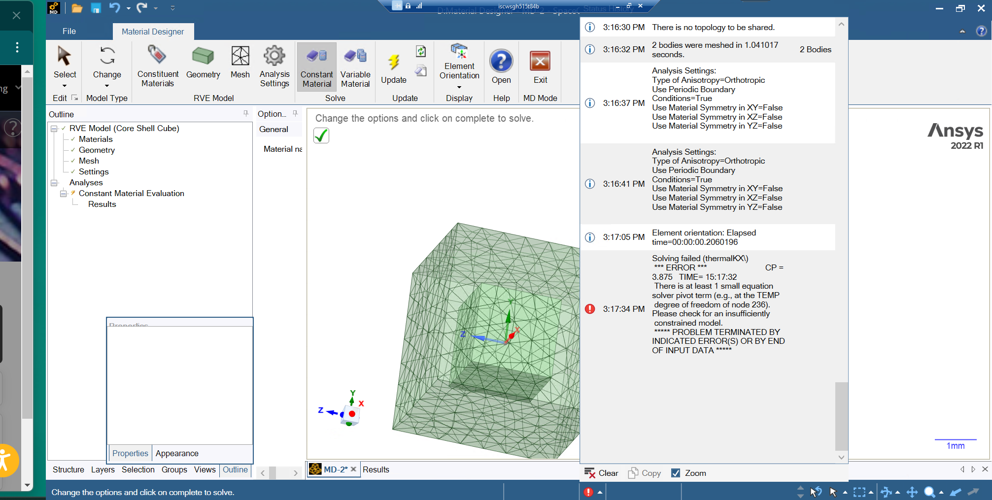

I wanted to ask an opinion regarding a problem I faced during my simulation. I am trying to create a core/shell model with 2 cubes (1 cube located inside another cube). As I am trying to work on material designer, everything works well from material allocation, meshing and the settings till it reaches the analysis step. After allocating constant variable, the software does not give any results due to an error as shown in the prompt below. Would appreciate any help and/or explanation regarding this matter. Thank you in advance! -

Please check if there is sufficient boundary conditions/ contact defined for the heat transfer to take place. You can check on which body the node 236 is located.
