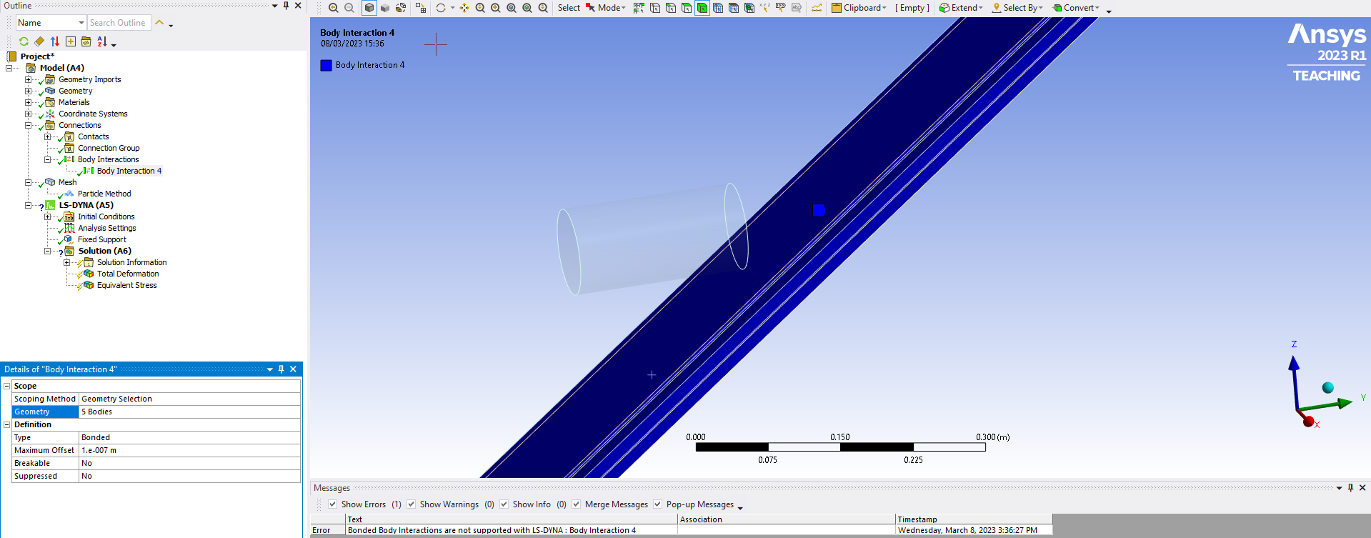

      Hi all,
      I would appreciate some guidance. I am using ANSYS LS-DYNA through workbench 2023 R1 and am trying to set up a bird strike simulation for a laminated aircraft window. In doing so i believe i need to specify the body interactions between the plies of the window as 'bonded'. When i do so, the following error comes up:
      Can anybody point out where i am going wrong and how to move forward please?
      Ash
    • Armin
      Hi Ash,
      Try defining contact pairs instead of body interactions: Right click on Contacts --> Insert --> Manual Contact Region
      You can then select the target and contact surfaces and set contact type to Bonded.
    • Ash Curran
      Thankyou! I seem to have sussed this out now.
