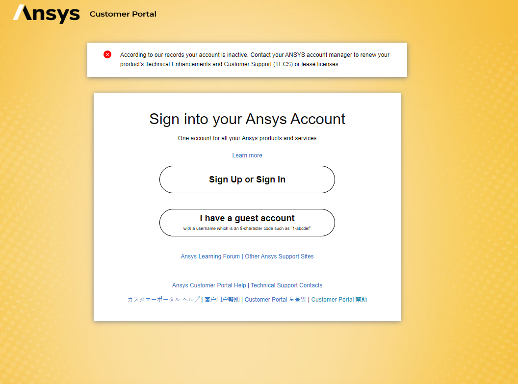

      Dear ANSYS Team,
      Myself Arjun a Ph.D. student at Imperial College London. Lately, I am facing an issue with the licenses. Currently, our group holds 5 licenses active up to Nov-2024. Until yesterday I could able to run fluent parallel simulations (32cores) on my desktop. But from yesterday onwards it is permitting me to use only 4 cores. I am also attaching the screenshot for your reference. Also, I am not allowed to login to my customer portal account.
      I request you to kindly help me in solving this issue.
      Thanks and Regards,
      Arjun
      (ap20@ic.ac.uk)

      Hello Arjun,
      If you perform a license status on you machine what does it produce?
      Start->All Programs->Ansys 2020 R1->Ansys Client Licensing->Client ANSLIC_ADMIN Utility 2020 R2
      When this appears, choose:
      View Status/Diagnostic Options->Display the License Status
      Please copy the output from the display screen and paste here.
      Right-click in display window and choose select all
      Right click again and choose   copy
      Paste here.

    • George Karnos
      Are you able to run with less cores, say 16?
      It looks, from the status that 28 licenses are being used on ese-ap20.ic.ac.uk ese-ap20.ic.ac.uk

      Hi George,
      Thank you very much for your reply. Actually, I could able to run the simulation with more than 4 cores (This version is somehow recognizing our research licenses) using version 2021 but not the 2020 R2. In 2020 R2 it is restricting me to only 4 cores(teaching license-Imperial college licenses)
