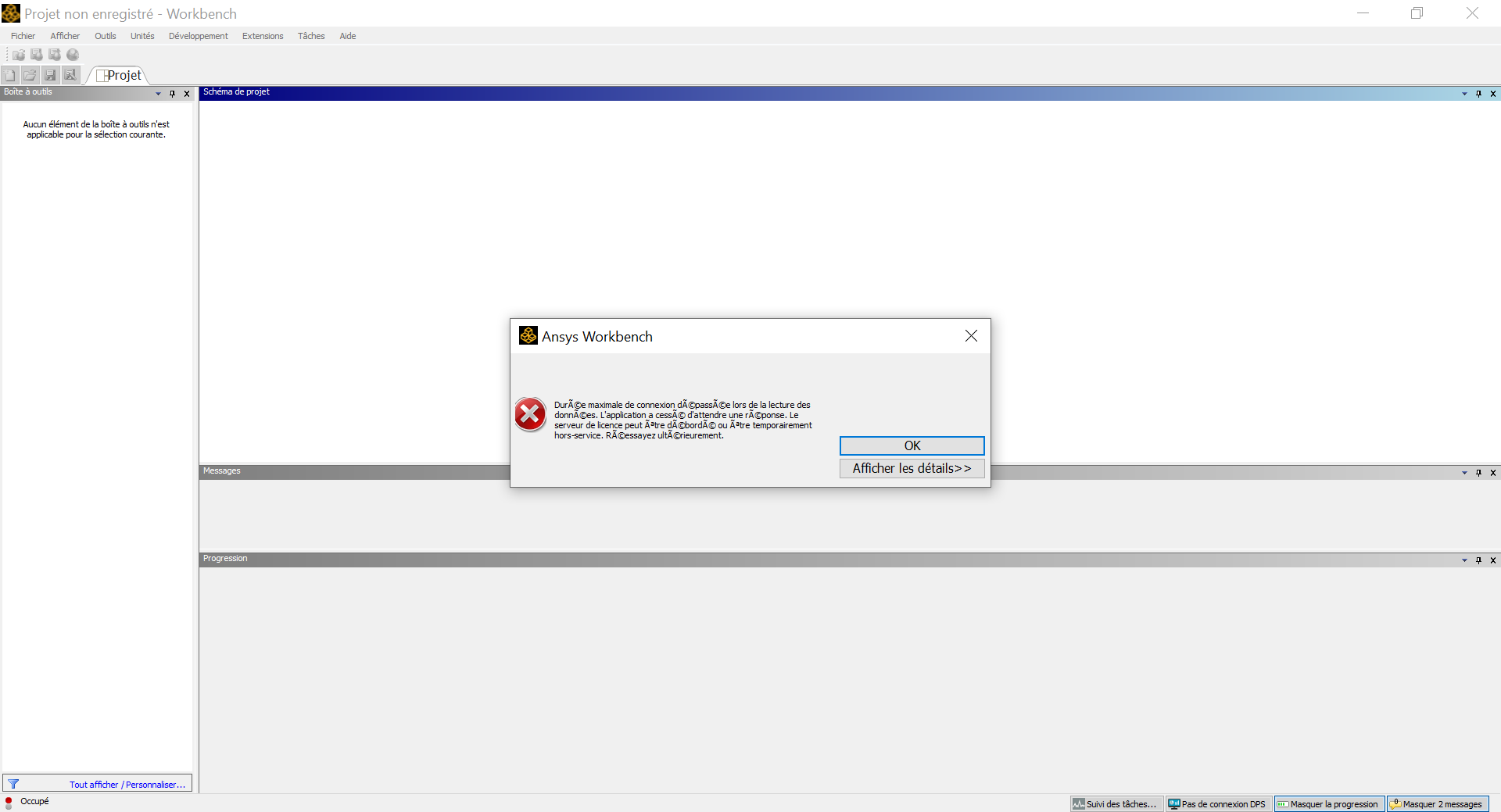

Hnayno
SubscriberHello
I am a doctoral student, I have just installed the Ansys 2022 R1 software on my PC, and connected remotely to my university's license server (through an university VPN ). the license server is indeed valid on the "client settings utility" side ( image 1 below), however when I try to open the software it returns an error message ( image 2 below).
Can you help me to solve this problem please?
Thanks in advance for your feedback
March 15, 2022 at 1:44 pm
George Karnos
Ansys EmployeeUnder %TEMP%\.ansys you will see license debug log files.
Can you check these files and post any errors you see?

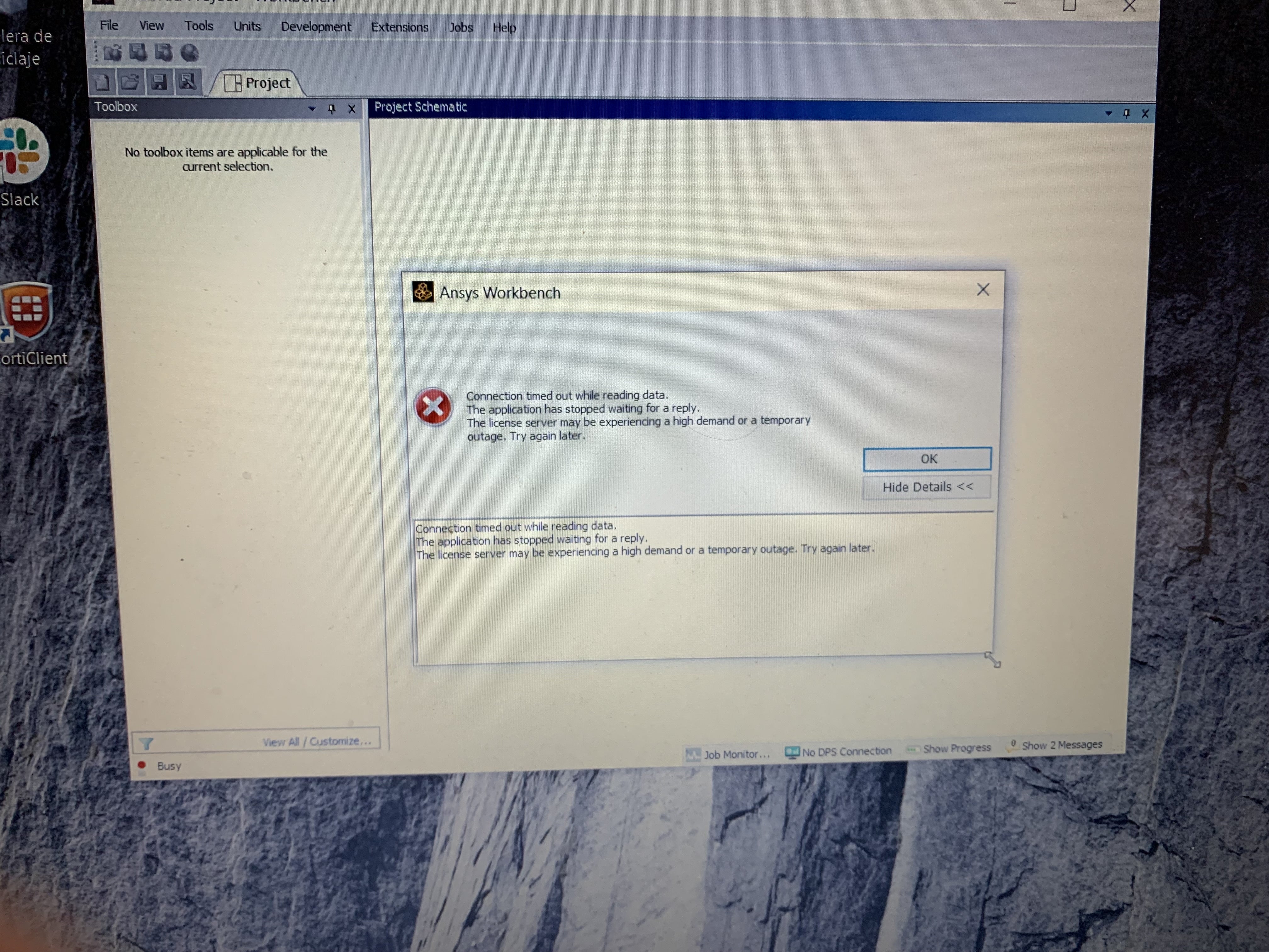

778634
SubscriberI also have a problem with the license. In my case we have the license stored on a university server, and until now the Ansys 2019 version worked fine for us, but now we have updated to the Ansys 2022 R1 version and when we open it we get the error message that I attached in the image.
How can we solve this error?
Do we have to change the server software for this new version?
March 29, 2022 at 12:49 pm
Luis Silveira
Ansys EmployeeMake sure that you have ANSYS 2022 R1 License Manager installed on the License Server and that the license file is also valid for ANSYS 2022 R1.
Once this is completed, you should be running ANSYS 2022 R1 and previous versions.

March 31, 2022 at 10:22 am
778634
SubscriberI have tried what you told me, but it still doesn't work.
What other problem could there be?
