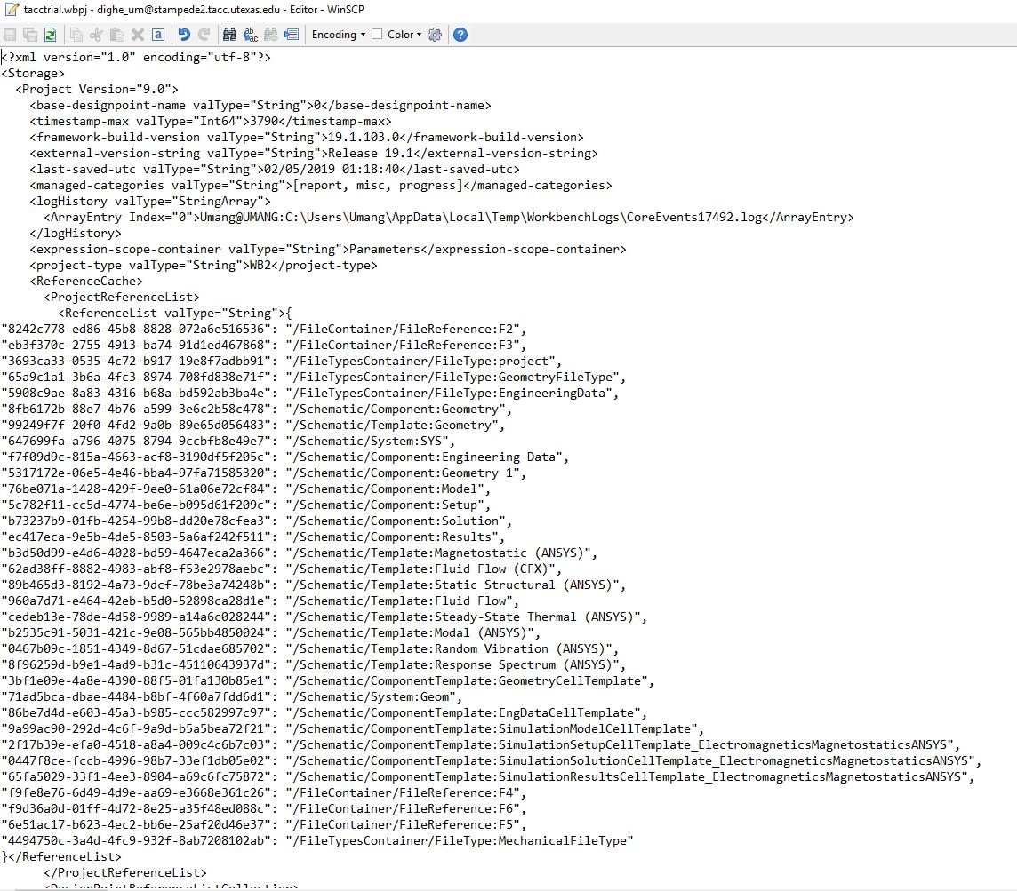

      I was able to fix the error that was showing up earlier. I created a small wbpj file and the corresponding folder and placed it in the correct folder. It cleared out the previous error but now I got an error that says runwb2 command not found.
      I thought I did not have correct environment variables to point to the correct path but I checked and it seems okay.
      Any suggestions for me on how to fix it?

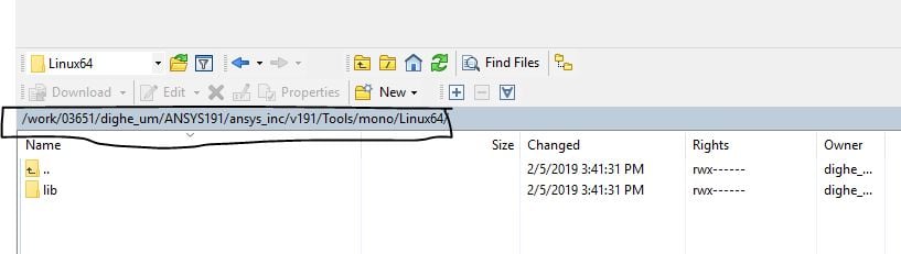

      Is there a file named 'mono' under that directory (/ansys_inc/v191/Tools/mono/Linux64/bin/ )?
      If not, then there might be some issue with the installation. Check if you have an install.err file under /ansys_inc/
    • digheum
      I removed the runwb2 from the environment variables.
      There is no "bin" under /ansys_inc/v191/Tools/mono/Linux actually. I have attached a screenshot.
      I am wondering why is the system looking for runwb2 in this location instead of the path specified which is not the one with "mono".

      I would recommend to reinstall the software. You are supposed to have more than just 'lib' folder under that directory.
      You may need to check if the installation package is 'unpack' completely/successfully (you can provide the size, and name of your installation package, then I can verify if it's extracted completely).
      To answer the question with mono vs runwb2 , the 'mono' is the tool to help the deployment of the software (code) available on different systems, see https://www.mono-project.com/
      So, it still tries to run the runwb2 script but it needs mono to interpret the script.
    • digheum
      Thank you for your help. I checked and mono did not have any other folders.

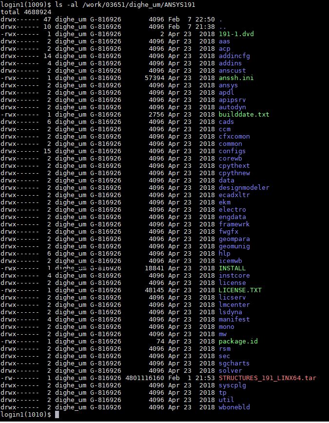

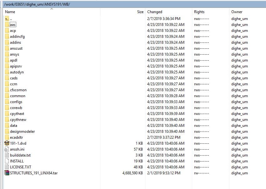

      The unzipped file I am using is STRUCTURES_191_LINX64.tar and it is 4688590 KB in size.  If you notice in the image below, ever directory before 191-1.dvd does not show a size parameter. Everything inside these directories is still a LINx64.TGZ
    • tsiriaks
      can you open up a terminal then issue the following command
      ls -al /work/03651/dighe_um/ANSYS191
      then post the screenshot of the output of it.

      I ran the ls -al command and this is what came up.
      I deleted uninst_data.dat from $HOME and tried to reinstall everything in /work/03651/dighe_um/ANSYS191 and it still gives me error about the manifest and not being able to find uninst_data. I have a home and a work directory. I cleared out both by deleting everything. I copied the STRUCTURES_191_LINX74.tar file in /work/03651/dighe_um/ANSYS191. I untarred it in the same directory and installed it again in the same directory. When I submit a job, it still errors out saying it cannot find runwb2. Although, if I use MobaXterm to run a GUI version using runwb2, it opens workbench but errors out giving a licensing error. This was not the case earlier. Maybe, the system is not finding the correct license path and that is why giving this error ?
      I do see more directories under /v191/Tools/mono/Linux64 though, which I was not seeing before.

      Let's wipe everything:
      The installation directory , /ansys_inc/
      The home/work directory (for the .ansys folder inside them like $HOME/.ansys)
      Now, let's 'untar' the package into some other directory , after this is completely finished , issue this command
      ls -al
      and send me the screenshot again.
      Now, install the package from this directory , make sure that you do it with root or using sudo
      Does it install successfully this time ?

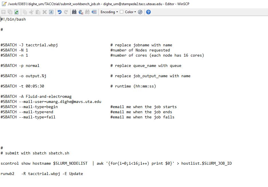

      With your help, I may have solved the installation issue but now I am having an error with running jobs on this installation. This may not be installation related but I will post it here and if this is not the correct thread, I will move it to the correct location.
      I am submitting a job using a script that looks like this :
      I checked the environment variables and they seem OK.  The tacctrial.wbpj file is big and that's why I am not copying it here in its full form but showing the first few lines from that file
       The error no longer says runwb2 command not found. Instead, it says:
    • tsiriaks
      Please create another post under the Physics Simulation to check your submission command.
      However, I would note that SLURM is not officially supported by ANSYS and it needs special customization.
