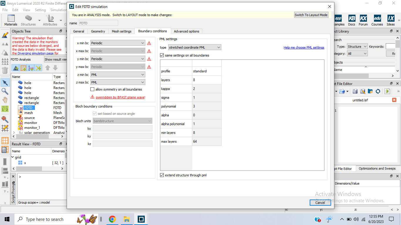

    • Rony Das
      What are the boundary conditions when BFAST is used in LUMERICAL FDTD between X And Y Axis?
    • Guilin Sun
      BFAST has its own built-in boudary conditions in the periodic axes. You do not need to set them specifically. However, if the source has only titled in one plane, for example in xz plane, which hshould use the default BFAST-specific BC, if the device has symmetry property in YZ plane, you can still set it accordingly, without use of BFAST BC:
      https://optics.ansys.com/hc/en-us/articles/360034382694-Symmetric-and-anti-symmetric-BCs-in-FDTD-and-MODE
      https://optics.ansys.com/hc/en-us/articles/360034902273-Broadband-Fixed-Angle-Source-Technique-BFAST-
    • Rony Das
    • Guilin Sun
      The boundary conditions are correct. The top-left warning means the simulation is diverged. Please refer to this article https://optics.ansys.com/hc/en-us/articles/11277217507603-Troubleshooting-diverging-simulations-in-FDTD
      if you have more questions please write a new post.
