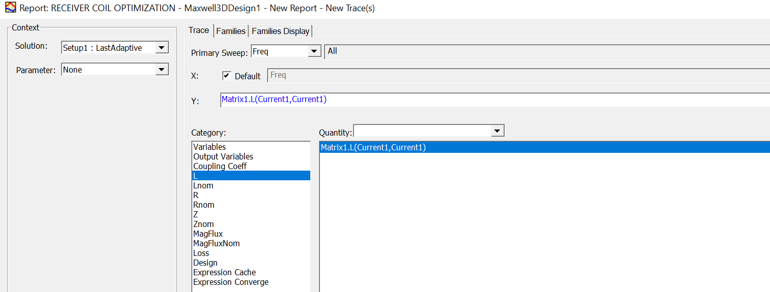

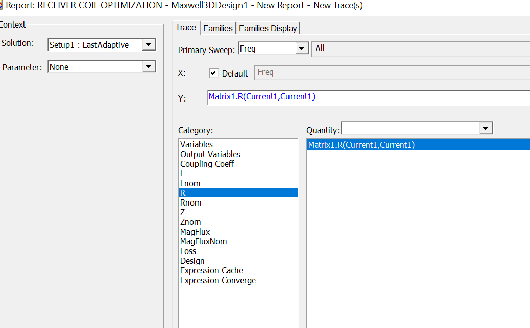

      For the MAXWELL (Eddy Current) simulation:
      I set the analysis setup frequency at 13.56MHz, and I did not use radiation boundary, but I used a current excitation of 1mA. For the calculation of "L" and "R," I used the assign matrix option:
      L=1.26 uH
      R=0.703 ohm
