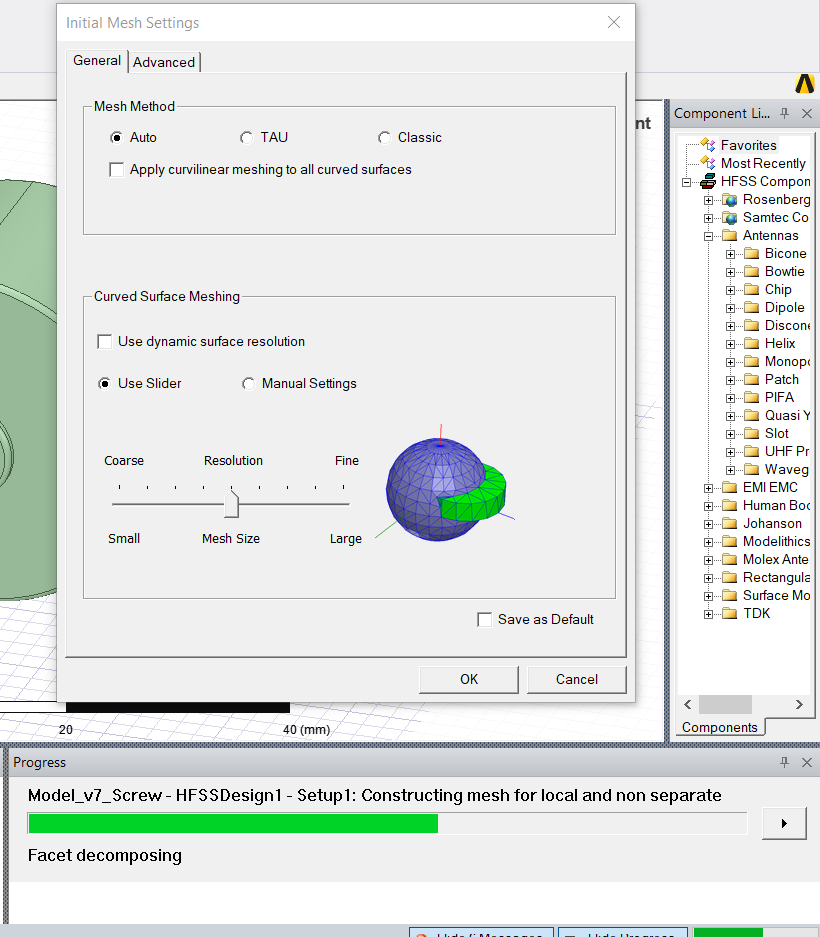

SubscriberI get the following errors when analyzing the model. I got no errors when validating it. I also enabled "Material override" to prevent intersection.
When an average mesh size was selected, the simulation stopped at "Facet Decomposing". I waited ~20 mins and had to abort the process. Then I changed to the smallest mesh size hoping that it would reduce the simulation time, but got the following error: " Surface mesh generation failed". At one point, I tried to run it again and got CPU intensive processing error.
How to I fix these errors?

Please check the option to use the curvilinear mesh option along with the default resolution and see that you are able to complete the mesh.
