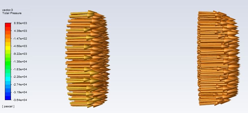

      However when I see the contour plot of the total pressure, the value of pressure are extremely high and doesn't make any sense.
      also, input and output pressure seems to be equal. How is it so?
      2. I tried giving a sinusoidal pressure pulse as the input using the following UDF
      However, when I see the vector plot of the pressure, the pressure seems to be constant rather than sinusoidal in nature w/ extremely high values. How is it so?

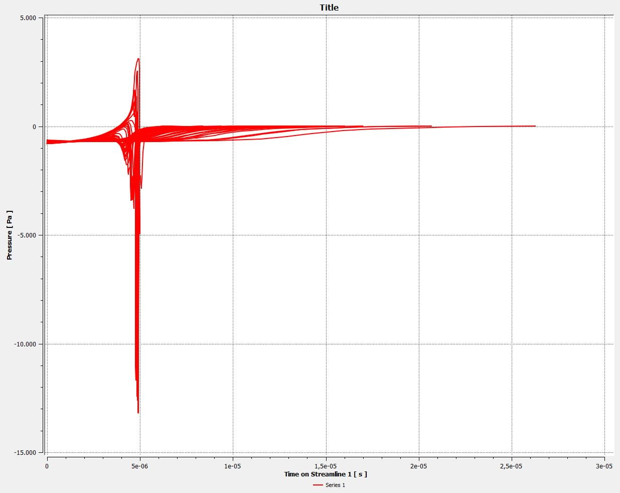

      Also, following is the pressure plot w.r.t. time, which doesn't make any sense either
      Kindly help with the above two queries.

    • DrAmine
      1/MPa is Mega Pascal right? Then your factor is wrong
      2/When working with UDF please use S.I units (Pascal for pressure)

      The issue is I don't see any pressure variation for the inlet (10 mPa) or outlet (0 mPa) in either contour plots or pressure plots w.r.t. time.
      2. I am using Pa as the unit and so I use an amplitude of 0.005 to represent 5mPa.
      here again, I don't see any sinusoidal behavior when I plot the pressure w.r.t. time.
