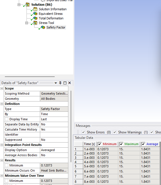

Once again, thank you for your help. Everything I have learned in this forum has been quite helpful. I was able to adjust the source time and the solution data tabulates my desired time settings. However, I still am encountering the issue of this time data not being tabulated for my safety factor or equivalent stress as shown in the image attached. Is there anything I can do to resolve this?

Ansys EmployeeHi
It looks like not much is happening - so wonder if the loading is like from fluent and if all the data gets imported correctly.
