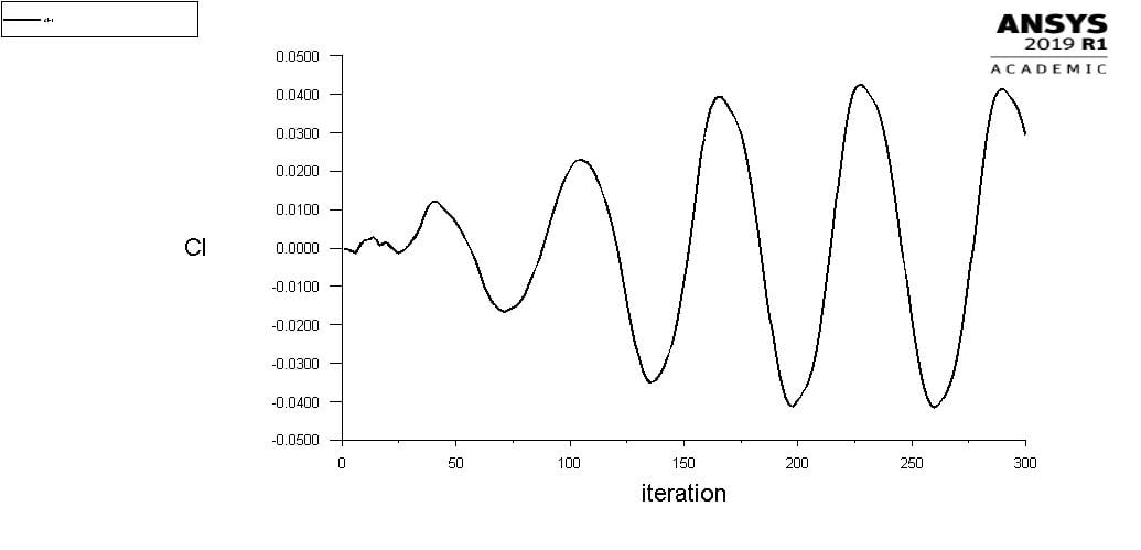

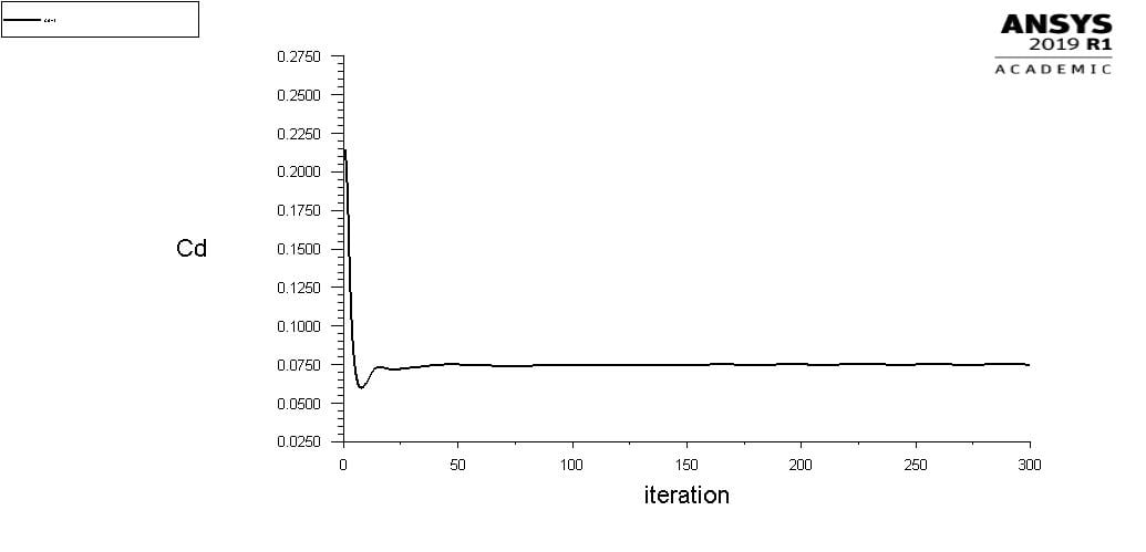

      Thanks Amine for your answer. The residuals and monitor plots look like this (I only plotted 300 iterations but it goes on an on forever):
      How should I set up the pseudo-transient method? I have found some information and done a couple of tweaks to the setup but it is still not converging. I've played a little bit with the URF's, but same, still not converging.

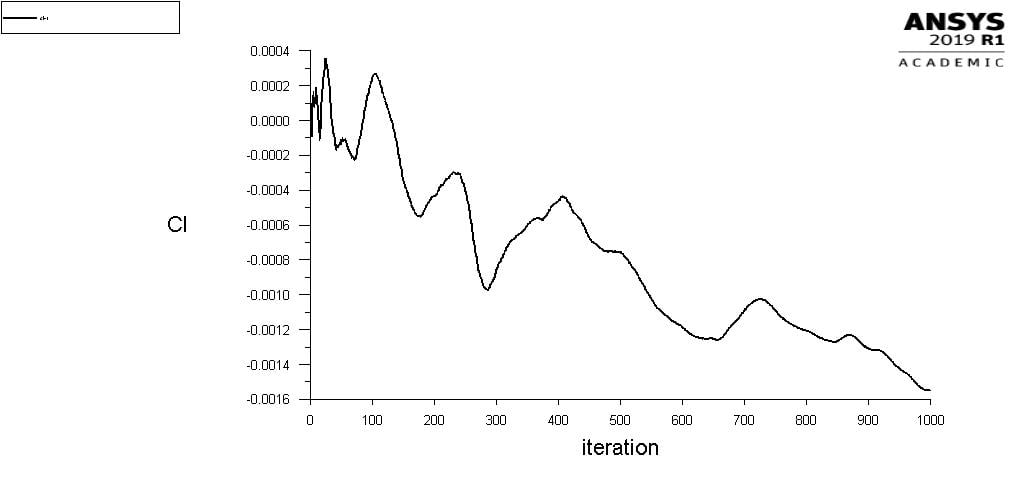

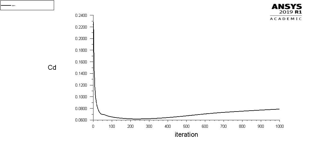

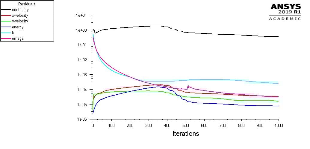

      The results are these:
      The residuals do go down, but it is still not coonverging. What am I doing wrong?
    • DrAmine
      Run longer at first.
    • polmartorell
      Which setup? I ran the first one for 5000 iterations and it just goes on like this. The second one I did it only for 1000 but it doesn't seem to be going on the right direction.
    • DrAmine
      The one with better residual till 1000 iterations. I do not like to start tuning turbulence parameters here. Just run longer and if it is still not showing the right trend we can then try with the density based solver.

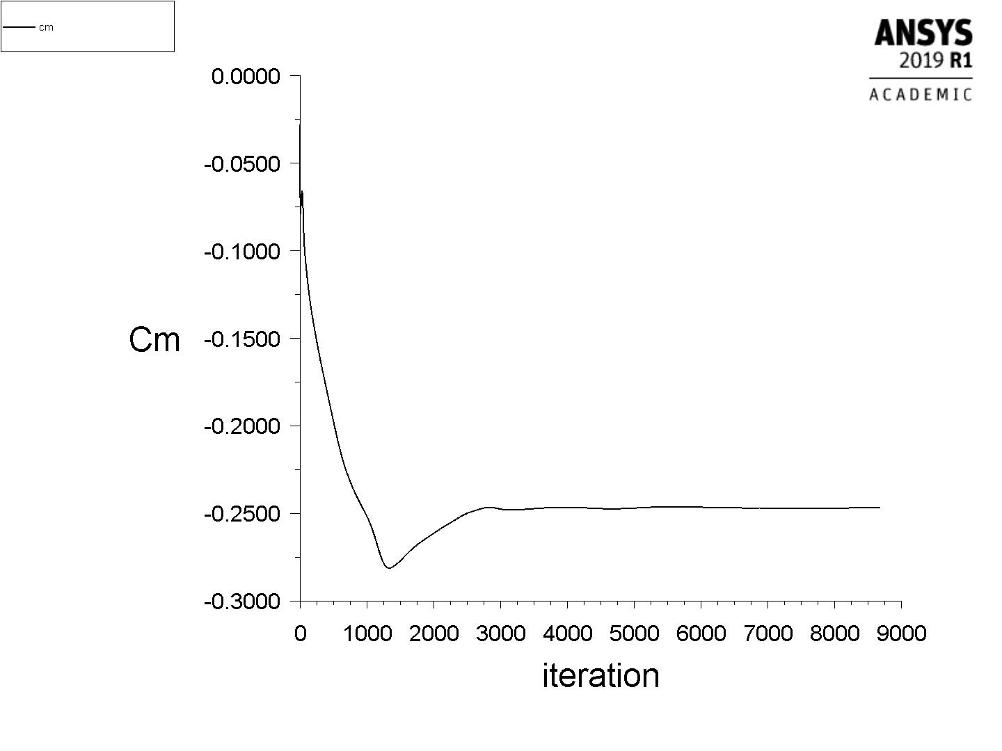

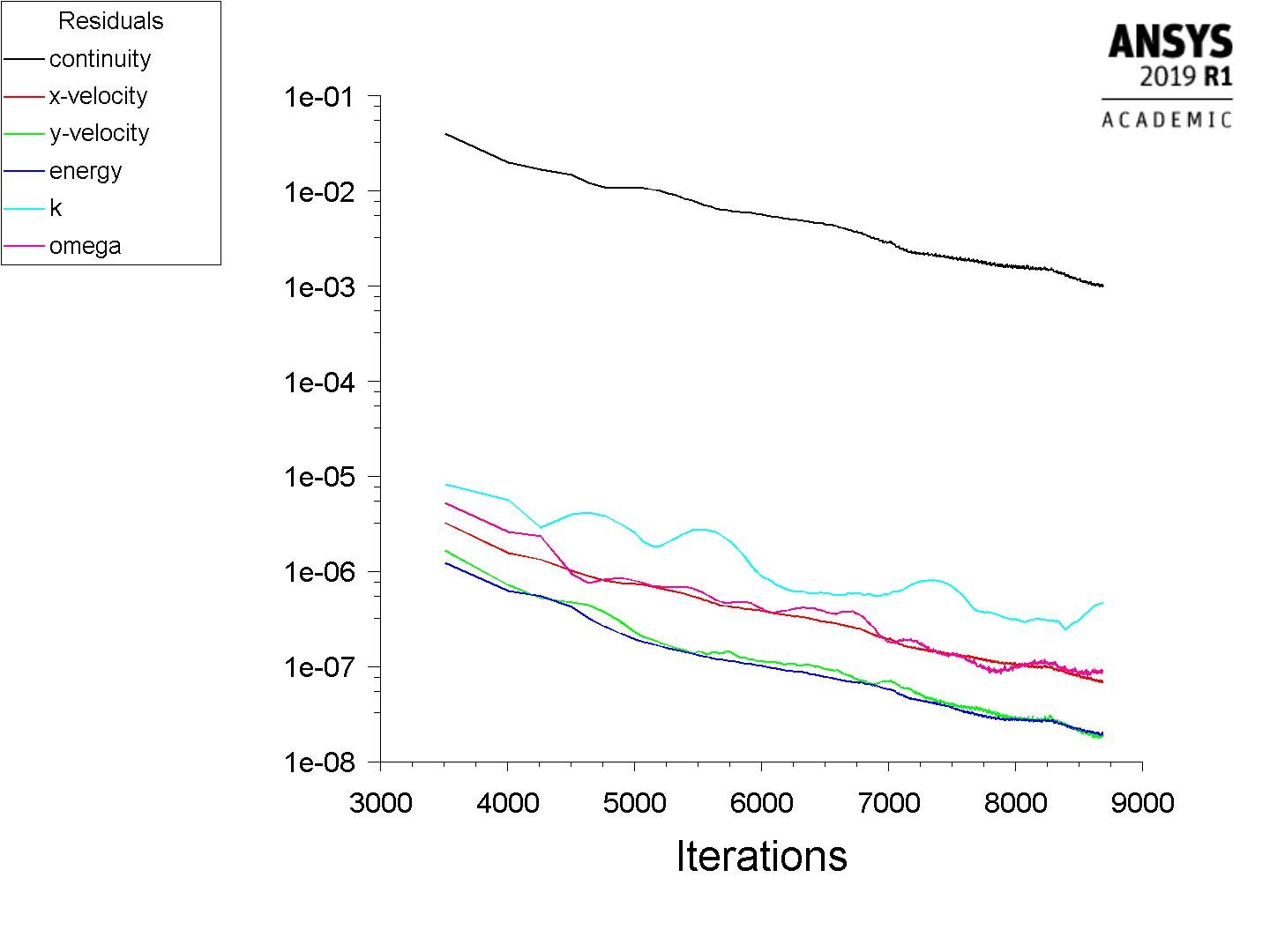

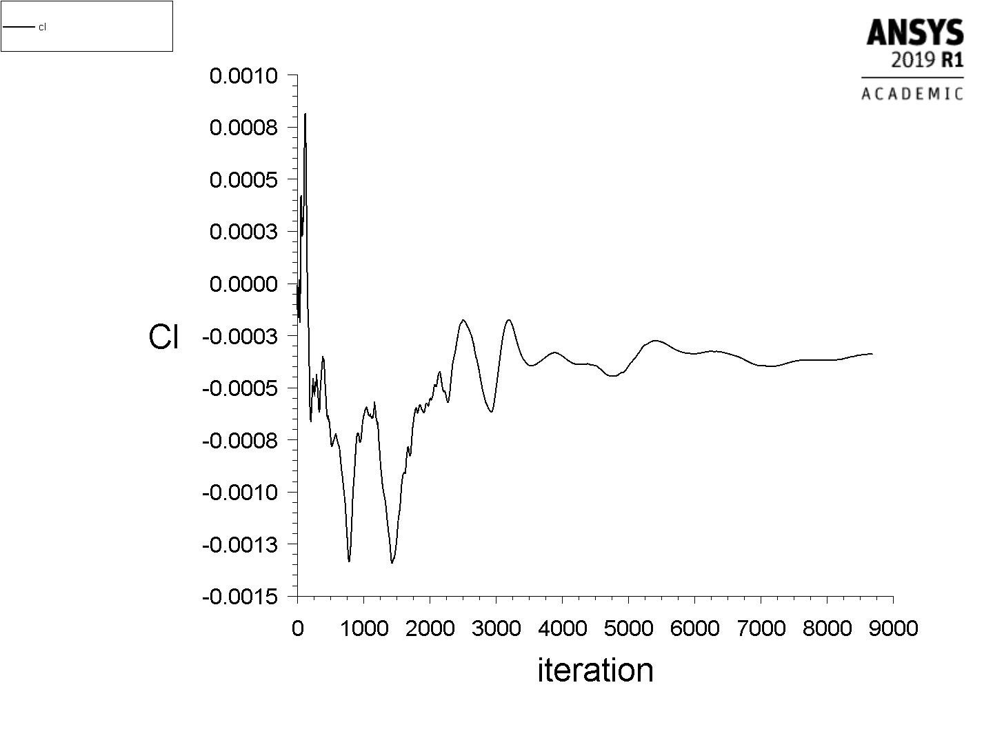

      I run the last case for 10.000 iterations and it stopped calculating at the iteration 8696. I guess it converged after all. These are the residuals and monitor plots:
      Whilst the CD and CM plots seem to have converged, the CL still makes me uncomfortable. Furthermore, the CM value makes no sense at all, if the lt is so small (-0.00033), how can the CM value be so big (-0.246626)?
      The values in which de CL (-0.00033) is oscilating are very close to the real solution which I was expecting (0) and so are the values of the CD (0.07515), both almost identical to the ones obtained with the Spalart-Allmaras model (0.00105 and 0.07496 respectively)

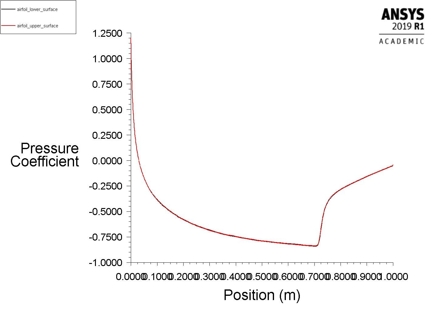

      PS: I also attached the CP vs chord plot, it shows what t should show, as it is a symmetrical airfoil at a null angle of attack, both the upper and lower CP are identical throughout the length of the airfoil.
    • Karthik Remella
      Administrator
      Please reduce your convergence criteria (redisual values) and run your simulation longer. A deeper convergence might help stabilize your C_l.
