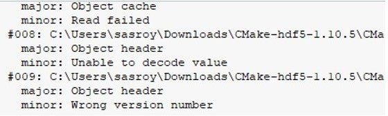

January 1, 2022 at 10:56 pmtemayer17
SubscriberI have also run into this error, and this forum post appears to be the sole relavent google result. Here is the error I keep getting, seemingly at random.
HDF5-DIAG: Error detected in HDF5 (1.10.5) MPI-process 0:
#000: C:\\Users\\sasroy\\Downloads\\CMake-hdf5-1.10.5\\CMake-hdf5-1.10.5\\hdf5-1.10.5\\src\\H5F.c line 509 in H5Fopen(): unable to open file
major: File accessibilty
minor: Unable to open file
#001: C:\\Users\\sasroy\\Downloads\\CMake-hdf5-1.10.5\\CMake-hdf5-1.10.5\\hdf5-1.10.5\\src\\H5Fint.c line 1652 in H5F_open(): unable to read superblock
minor: Read failed
#002: C:\\Users\\sasroy\\Downloads\\CMake-hdf5-1.10.5\\CMake-hdf5-1.10.5\\hdf5-1.10.5\\src\\H5Fsuper.c line 623 in H5F__super_read(): truncated file: eof = 6434736, sblock->base_addr = 0, stored_eof = 6434840
minor: File has been truncated
That directory "Users\sasroy\Downloads..." is not a directory on my computer.
January 4, 2022 at 4:46 pmRob
Forum ModeratorWhich version of Fluent are you using? I've seen corrupted data saves cause problems but not in 2020 or 2021 builds.
January 25, 2022 at 8:15 amJanuary 25, 2022 at 10:50 amRob
Forum ModeratorFluent isn't looking for a file there, it's a poorly set up error message. Looking further down the error is a read error on D:/projects/Henfoss...... Can you check the file is present, and that you have read & write permissions in that folder. or may have more information.

January 25, 2022 at 12:10 pmgdp
SubscriberHi, and thank you for your quick reply. Yes, the file was indeed present in D:/projects/Hensfoss ... I now managed to open it. I don't know what I did different, to be honest. I tried opening with full FLUENT capabilities and not just with PRE/POST option (as I did first), maybe that did the trick. Some users in this chat point out that the issue can be random.
Will leave new comment if I continue to get these messages.
Regards Gonzalo
January 25, 2022 at 12:13 pmANSYS_MMadore
Forum ModeratorGlad it is working. Make sure any antivirus or security software you may have are not scanning your project files. You should add exceptions to ensure there are no conflicts that could occur from a scan while trying to use the files.
