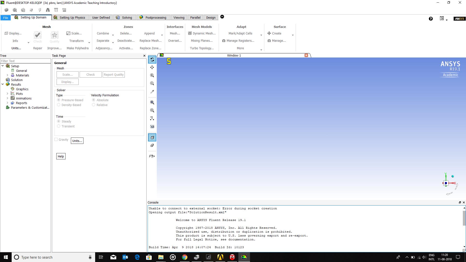

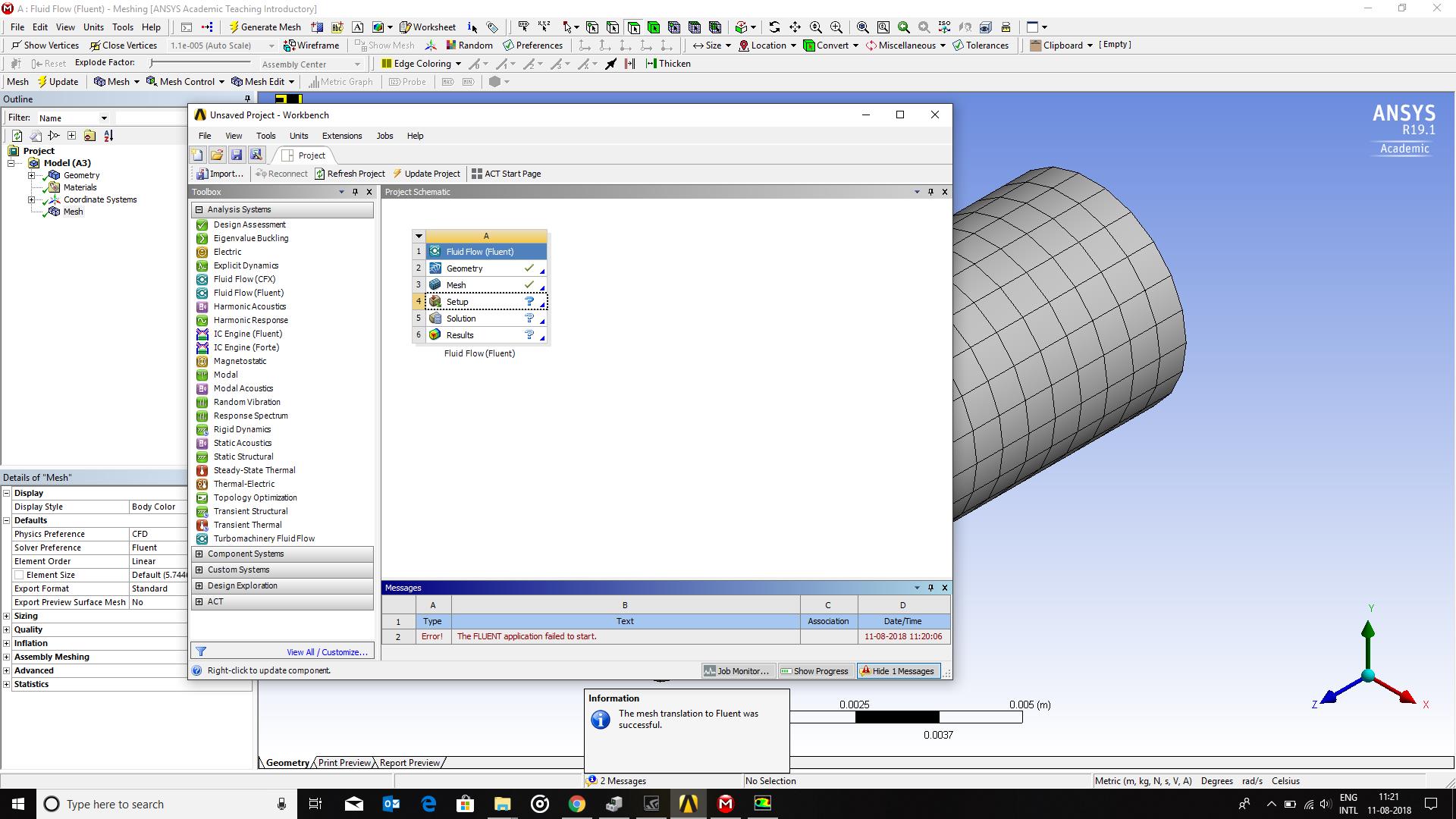

SubscriberI just downloaded ansys 19.1 student version. When i'm launching Fluent application it says "Fluent application failed to start". What to do?

August 10, 2018 at 7:24 pm

Ansys EmployeeHi wajidthebest,
That command was to try running Fluent in non-graphic mode to identify if graphics is the issue. It's not intended to fix the issue that you currently have.
From the screenshots that you sent, it seems both modes have the same issue that it got stuck when it's trying to spawn processes.
Let's try to rule out another issue.
In Fluent launcher (either launch from shortcut or run this command "C:Program FilesANSYS IncANSYS Studentv191fluentntbinwin64fluent.exe"  , with quote)
try this setting
Processing Options : Parallel (Local Machine)
Processes : 0
GPGPUs per Machine : None
Can you launch successfully with this setting ? If so, something on your systems prevent you from spawning multiple processes. Check your security/anti-virus software.

August 10, 2018 at 8:00 pm
August 10, 2018 at 9:23 pm
tsiriaks
Fluent actually launches successfully now. The issue is something else.
Have you tried with different geometry/model/mesh ? Can you start a test Workbench project, create a simple block in SpaceClaim , then use generate mesh and try open up the setup cell again.
If that doesn't work, close all ANSYS applications, then rename folder v191 in this directoryÂ
%AppData%Ansys   (please copy and paste this in the Windows Explorer address bar)
to anything else (e.g., v191.old)
and try with test project again.
Thank you,
Win
August 11, 2018 at 5:52 am
August 13, 2018 at 9:50 am
Rob
Forum ModeratorFluent looks to have started, but isn't reading the mesh. Just to confirm you have a 3d mesh and not a shell? Can you open any of the tutorials available via the Help system?
