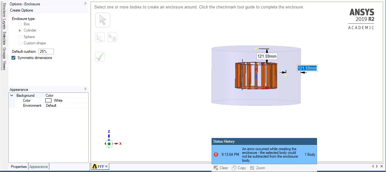

Forum ModeratorWhat type are the VAWT bodies?Â
Moving to geometry.Â
March 11, 2020 at 3:54 am
Keyur Kanade
Ansys Employeemake sure that you have a solid for subtraction.Â
if you have solid, please check if it has any errors. you can check it by selecting in structure tree --> right click --> check geometry.Â
Also you can try creating a enclosure manually and then use 'Combine' command for subtraction.Â
Keyur
March 11, 2020 at 3:58 am
konka92
SubscriberYes it is a moving geomentry bodyÂ
March 11, 2020 at 1:43 pm
Rob
Forum ModeratorBut is it a solid? Or just a collection of faces?
March 17, 2020 at 1:41 am
konka92
SubscriberHi I have finally resolved using combine and split body option. thank you so much for your inputs.Â
