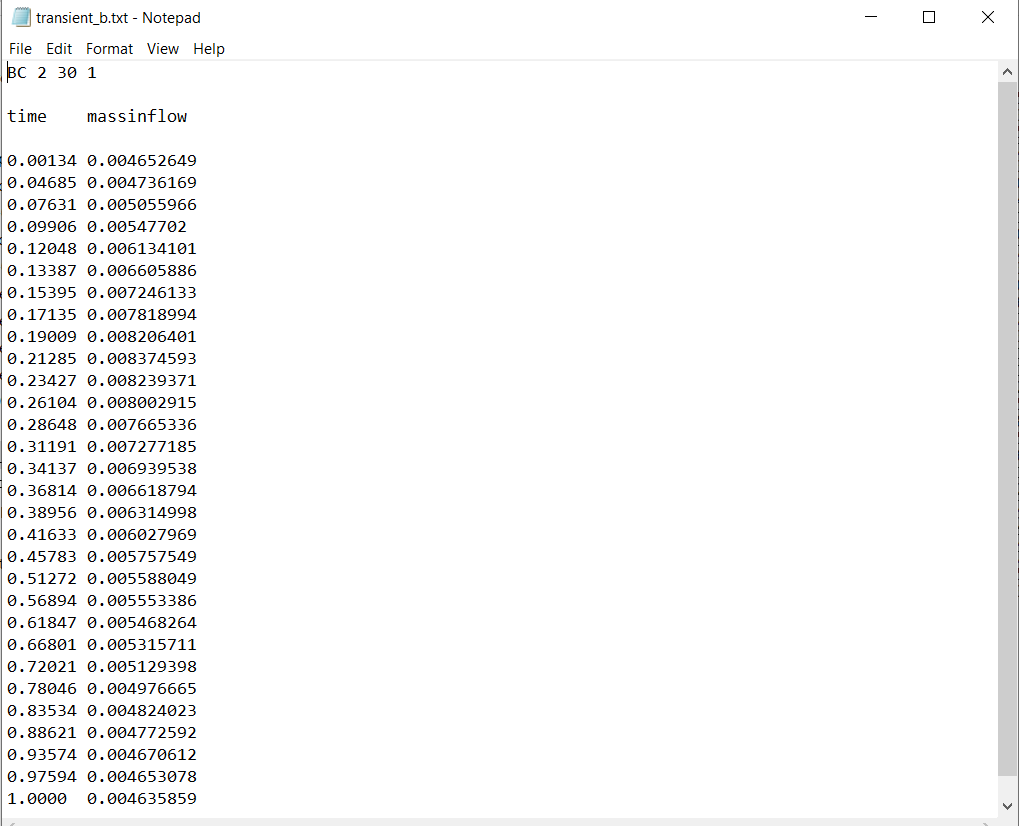

- Graph from which values are taken to create transient profile

AdministratorHello Could you double-check the units you used in your inlet profile? Are these in SI units? And also the syntax too.
Is this an incompressible flow? The input Mass Flow rate seems incorrect (because it is pretty small).

Ansys EmployeePlease use SI units for mass flow. Does the mass flow reported by Fluent scale with the velocity you are getting?

Yes, I have used SI units for mass inflow rate. The graph from where I have taken the values for transient profile is plotted between ml/min vs time (seconds). So, I have changed those values from ml/min to kg/sec. Now, the transient profile (attached below) is for flow rate (kg/sec) vs time (seconds) . Also, the flow is incompressible with density= 1060 kg/m^3 . Can I know, what did you mean by syntax check ?
I am attaching the transient prof image for your reference
Please let me know, where did I go wrong. Thanks a lot

I have used SI units for mass inflow rate (kg/sec) . Yes, you're right. I am getting the velocity profile (reported by fluent) for the mass inflow rates that I have given as input to fluent.

Ansys EmployeeWith the new mass flow inlet BC table what are you getting from Fluent?

I think I've figured out the problem. I have been using transient conditions at inlet and while plotting, I have been selecting inlet, outlet and the wall. Now, the plots are matching.
